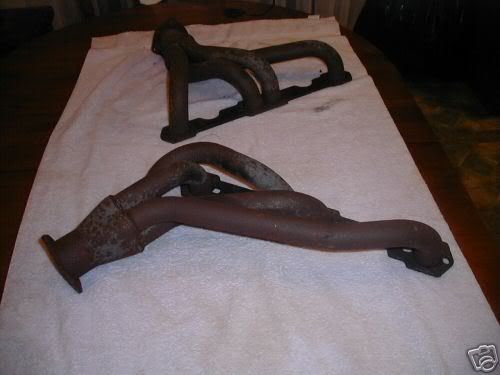

i bout theese flowtech headers on ebay for 67$ after shipping i think its a great buy considering some of the prices i have seen them go for just check it out.

Not to burst you bubble, but I'd probably take $67 and the headers, but I wouldn't pay for them.
They'll be a little better than your manifolds, assuming they don't leak. Do you have a way to get them installed and hooked up without paying for it?

flotechs are flotechs...cheap, small, require more then its worth to install for not much gain. I would have saved the money and waited to to buy some hedmans or hookers.

Those headers don't cost all that much more new. The high prices you are seeing are for larger tube headers, with Y pipes. The Y pipe is where it gets really expensive, and you need that part.

I wonder how many of the above posters have ever owned flowtech headers? I have, actually just sold the car they were on too. They were on there for 5 years, and never once leaked. The SAME set of gaskets the whole time. Yes, they dont flow as well as 2055's. BUt, they are a MILE above manifolds. The worst header(and they may be) is still 10 times better than manifolds. The cons: they tend to be a pain to install, because of the way the flanges are. YOu could have got those headers brand new from summit with a y pipe for like 150 bucks.

I owned a set of Flowtechs(2) briefly. They were for my Tahoe but they did not have the right size pipes so I sent them back. Anyways they were not that bad looking but they did have some issues.
If I had kept them I was going to get out my grinder and do some cleanup before I installed them. They needed some cleanup at the header flange area and where the 4 pipes merged. Otherwise it looked like they would have done the job.
I had put a HT383E in my Tahoe and wanted the 1 5/8" headers. I kept getting the 1 1/2" headers even though they were marked 1 5/8" on the box and with the correct part number.

I have flowtech headers and y-pipe, and their quality allowed for me to become an expert at changing gaskets. As stated they have some negative qualities, but for a first set you'll feel pretty good about them. And then sometime down the road, you'll learn what quality is.

Cheapy summit headers=Flowtech. I ordered the summits and thats what they sent. Like i said, my gaskets have never leaked. The flanges were really warped out of the box. Putting them on I actually had to put all of the bolts in a few turns and then go around and tighten each one a little until they were snug. If you started at one end and went the other way by the time you got to the other end the holes wouldnt line up. They were that bad. I thought for sure I was in for trouble with them. I used some of the Really THICK gaskets that compress well. Not a single leak in 5 years.

i bought, and installed a set of flowtech long tubes, they dont leak.....but they didnt fit worth a dam............it took a hydrualic pull and a chain to make clear the stub frame................I will say this, they dont leak yet, and i aint tightened em up, would any of you say mine were worse than manifolds? they are 1 5/8 with a 3 inch collector

And it's not that they won't be an improvement over the stock cast iron logs - they will be. And, as you point out, it's a 305, and their small primary size is fine for a stock 305. If you're willing to spend the bucks for them now and do something else when you do a 350 later, that again is your choice - it wasn't mine.
You have heard the issues people have had with those headers, so forewarned is forearmed.
