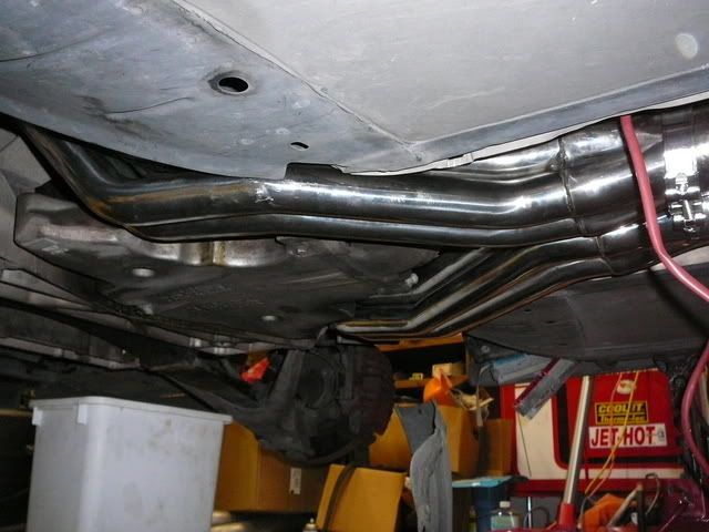

Full length = long tubes....The primary tubes run farther before they get to the collector. For an extreme example, here's a C5 Z06 with long tubes.
Equal length = each primary tube is the same length. Can be any length of header as long as they're the same length.
