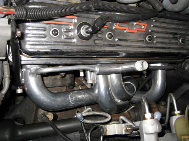

Old Oct 9, 2010 | 10:59 AM
Dyno Don's Avatar
Joined: Mar 2000
Posts: 5,713
Likes: 133
From: Orange, CA
Car: '90 Trans Am-12.45@110.71
Engine: 355 w/AFR 195's Elem. 400/430 HP/TQ
Transmission: Tremec T-56
Axle/Gears: 12 Bolt 3.73
Re: SLP Headers
When I designed my shortys I fixed all the problems associated with the SLP's.
They don't hit the steering, 3/8th's thick one piece flange, lots of spark plug clearance, the AIR tubes fit like OEM and there are no gaskets to blow at the collectors (ball & socket).
Also they fit all heads.
They are also available w/o AIR, single cat or dual cat.
Here is one pic:

That's probably the #1 complaint I had about my SLP headers. I guess SLP's idea was to make them universal, but with the AIR tubes sticking straight up they were just in the way. No quantity of adapters and elbows could make up for the fact that they were more intrusive and useless then the stock AIR pipes. I ended up cutting them off flush and having them welded closed. It's nice to see that problem has been fixed.
Pretty much every SLP part I've owned is an overpriced piece of crap, including their headers.

I have no complaints about the design and materials of
the two sets of SLPs i have had,but both sets had bad
assembly quality problems,2nd set to the point of being
unusable without extensive rework
First set i got around 1995,used them a couple years,
got tired of all the leaks,etc. caused by flanges not
square ,etc. so bought a 2nd pair in 1998 thinking
SLP would have fixed the bad assembly problems by
then;WRONG! had to send these back.
I kept the first set and may one day rework/repair
and reinstall as they definately have better flow than
the smaller edelbrocks i have an now
BTW,when i got the 1st set,SLP also offered an exotic
"tri-y"4-2-1 style set-but that was about $1200
as i recall

i also had a problem with the flanges not being flat, i had to grind the center flange, on both headers, a lot to make it flat and to get it so seal. Had to touch up the front and rear flanges too.

I had mine since 1998 and had no problem with them not sealing against the gasket and head. I use a copper gasket for the headers. You just have to get them as tight as you can. I'm using the E3's spark plugs for Corvette heads. It's a little more over a 1/4 in space from the boot touching.
