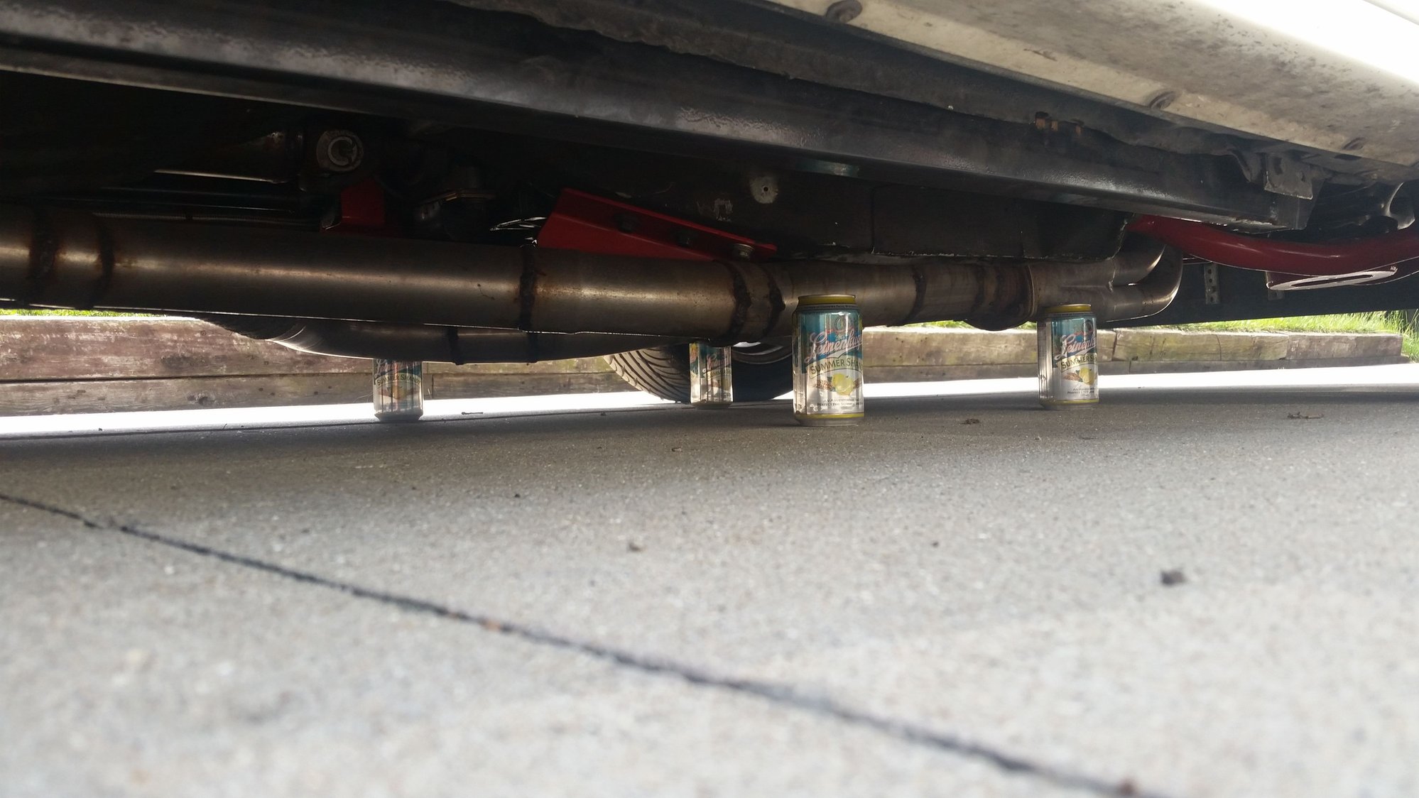

This what it looks like now, little tweaking still needs to be done

13" by 10" by 5 1/4"

Ground clearance. . I'll give it a OK, especially in southern Wisconsin. Sonr think its too bad for long tube headers and a 3" y pipe

Do you know what degree the over axle bends are? Looks like a 45 and a 90 ?

Yes 45 and a 90
