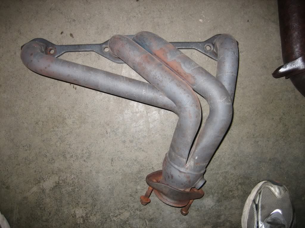

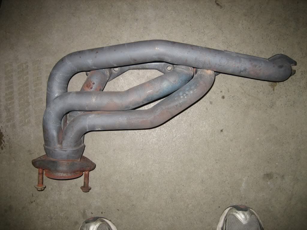

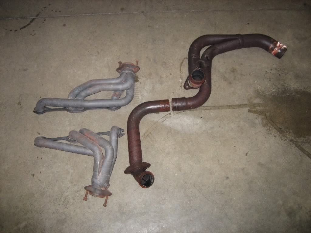

Below are pix of my old edelbrock TES headers that I had on my IROC wrapped for 5 years. I sandblasted them and painted them, then wrapped them over the paint. I ran the car in all seasons except winter for 5 years, about 40k miles. These are pix of when I sold them. I unwrapped them to see what shape they were in. I'll let the pix speak for themselves. There was not a crack or blemish on these headers. Stop the myths, header wrap is fine. PROVE that wrap damages the headers or stop perpetuating bad info.

Show me the data Don. I'm tire of hearing people say this. I've got pictures to prove this is a myth.

I painted and wrapped those more than 10 years ago. I don't know for sure which paint I used. To be clear, the headers in the picture are bare metal. The paint is completely gone. I'm guessing that I used the 500* stuff and should have used the 1200* stuff. At any rate, the point is that header wrap does not trap in moisture and make the headers rot. I washed my engine bay frequently and drove the car in the rain. It was stored in an unheated garage in the winter and started about once per month. The headers get hot enough to boil off any moisture that is present. They always stay bone dry while at temperature. During storage I think the wrap actually helps protect the metal from moisture. These were in better shape after wrapping them than they were after I ran them painted for 3 years. I always hear people say header wrap is bad but no one can post a picture proving that it is bad. Hopefully the rumors can be put to rest.

clearly those headers were not on a street car. They were on some type of oval track car maybe? How lean was it running? Not enough timing? Those headers look to me like they would have been wasted regardless of header wrap. Either way, street cars don't see the constant extreme exhaust temp that that application has clearly seen. Show me a set of normal street car headers that have had that type of failure.

I think that the region also makes a huge difference. For example, I live in So Cal. Our average annual rainfall is about 2.8 inches which is not very much at all. But for Seattle I would expect a fair amount of damage considering that the annual rain fall is about 33.3 inches. In other regions of the country where salts are used to melt snow, well that pretty much explains the amount of damage to a vehicles metal. So I believe that the severity and or the length of time to notice any damaging rust depends on the where you live and how you care for the car. I myself likes to hot pressure wash my engine compartment a few times a year. But I haven't installed my headers yet.
DD car.

Take another look at the picture in post #14

And look at post #8. Don't take it personally, my post was not meant as an attack. You needn't attack my intelligence. BUT, you are correct it comes from a company that sells it so it is suspect. Take it with a grain of salt as I do EVERYTHING I read or see on tv or read here for that matter. If the data doesn't add up I have to look at whats there.
But also in their page they mention there are some problems, don't wrap it too thick and quality of the steel does come into play also I believe I read where heat comes into play also - only use on naturally aspirated engines. May have read that somewhere else but I'm not re-reading it.
You obviously had issues with the headers being wrapped - and from the pic it looks like that was the problem. I am not saying it can't happen. I'll go so far as to say it could happen, what, 50% of the time? Give or take? Which is one hell of a lot but it wouldn't surprise me at all (EDIT: didn't finish my thought here) with the quality of steel and workmanship these days. The last set I wrapped was about 12 - 15 years ago?
But it does not happen all the time. Why not? Is the wrapping the right thickness? Is the metal better? I can tell you from welding a lot, the metal in the last 10 years or so has gone down in quality due to a large amount coming from Mexico with China sucking up all they can get.
I had a factory header crack badly in two places at one year old and it was not wrapped. I bought the vehicle new. The headers were recalled. Poor quality or design is everywhere.
One set of headers falling apart does not make an absolute. Yes there are many more but the data is not showing on this page. Even what I posted as you pointed out is meaningless without real world test cases. I have wrapped three and they did not fall apart and showed no visible signs of deterioration. I don't know what more you want.
People in this thread can forget what I wrote or not. I give no advice on this subject, just my experiences. I even said the next set I wrap may fall to pieces.
My headers, three sets, did not become junk in a short period of time. Good day.
