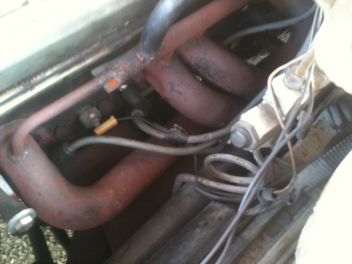

not the best pic,but to the far left you may see my bracket i made,its a long bolt and a spacer in the middle with 2 washers on each end
