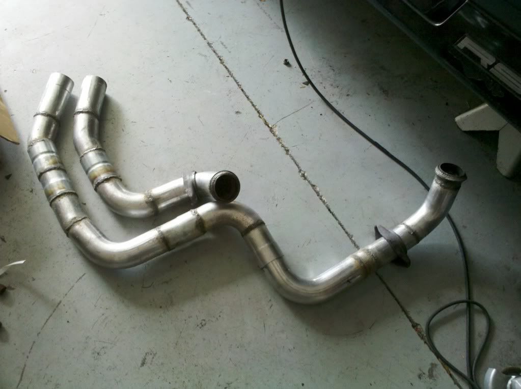

pwdbychevy u think u can snap a shot of ur underbody see how things look under there with the piping im just undecides i want the best sound from my car like a BEAST!! but not flow master or magna dont like the sound of that .... what do u guys think abot bullets? hawks third gen sells slp bullets for a 100 a piece just cant find any videos on youtube on how they sound so dont want to just on them...
Old Mar 2, 2012 | 02:17 AM
lolvtec's Avatar

Old Mar 2, 2012 | 05:14 AM
pwdbychevy's Avatar
Joined: Aug 2001
Posts: 1,337
Likes: 26
From: Wesley Chapel, Florida
Car: 1991 Camaro Z28
Engine: Dart SHP 406ci T88 turbo
Axle/Gears: QP 35 spline Ford 9" 3.50 gears
Re: single or true duals?
Here is my homemade y-pipe
And the rest of the system

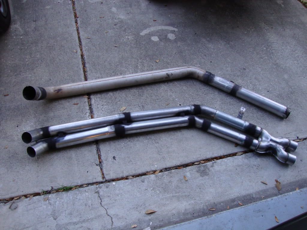

Old Mar 2, 2012 | 06:10 AM
92droptopws6's Avatar
iTrader: (10)
Joined: Jun 2004
Posts: 917
Likes: 31
From: Las Vegas
Car: '88 Trans Am
Engine: 5.7L TPI
Transmission: Slushbox
Let that car breath true duals with an X pipe and your choice of mufflers
FWIW I had 1-3/4"longtubes and a 3"Y pipe and picked up 1 tenth going to true duals on a bolt on ONLY Lt1 so I am more than certain a larger CID motor w/ cam and heads will benefit

I know I have a 4th gen however it is similar as far as routing
