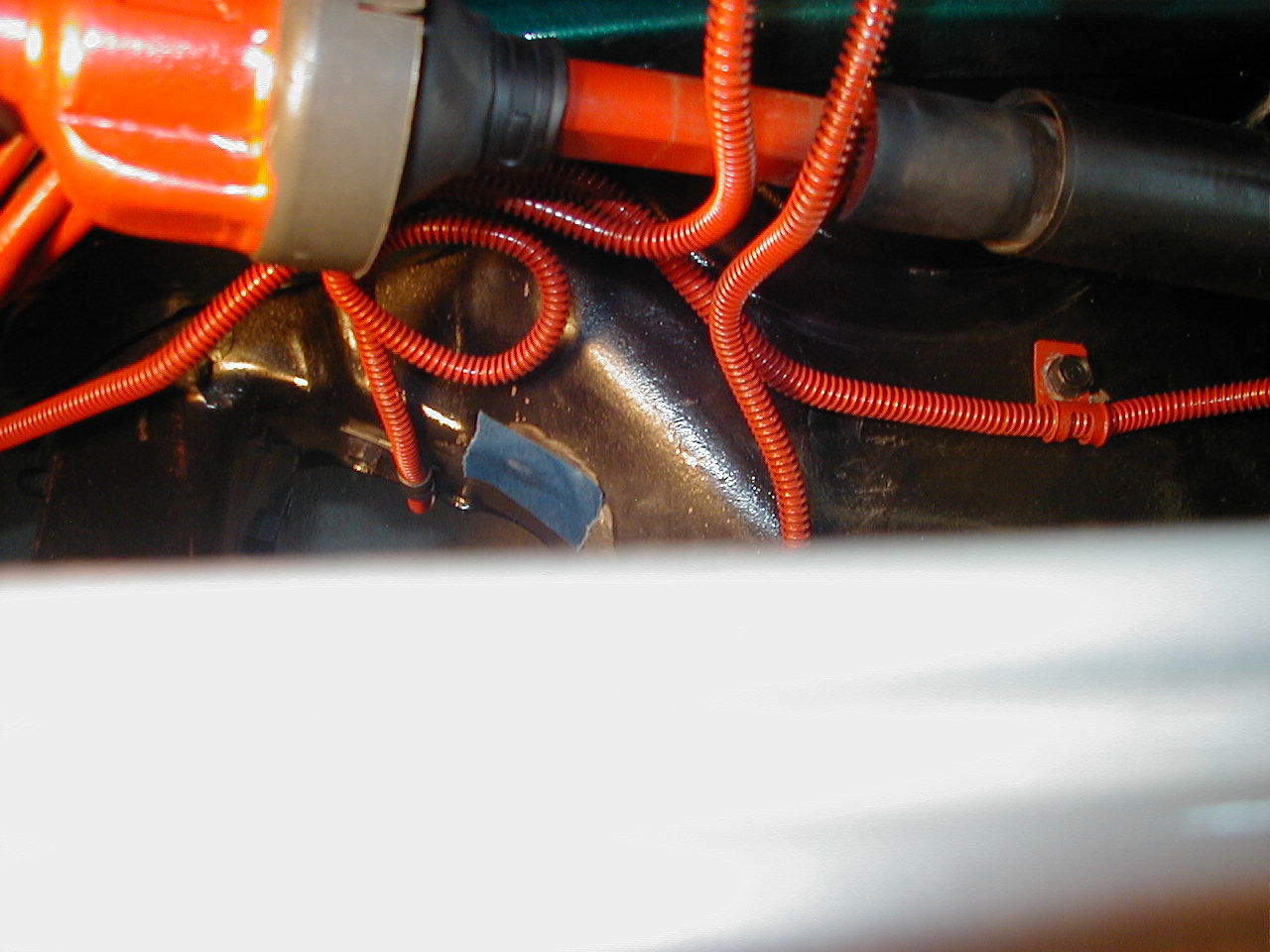

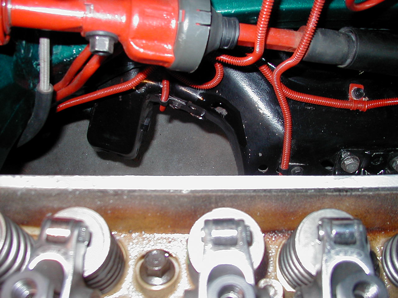

Here is a picture of factory ThirdGen Clamshells:

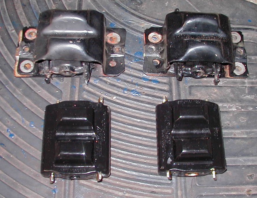

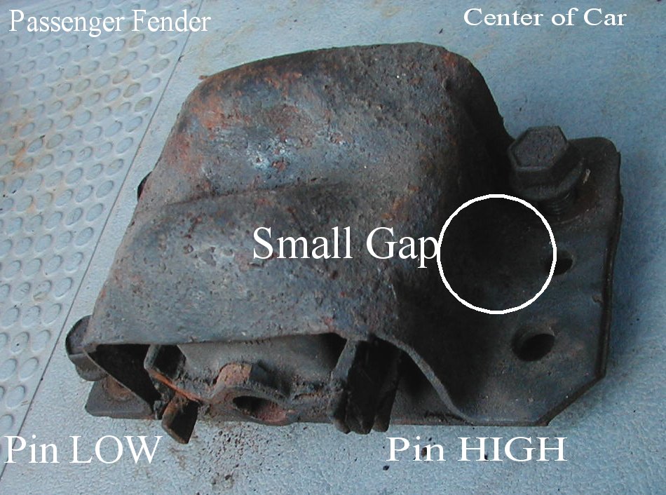

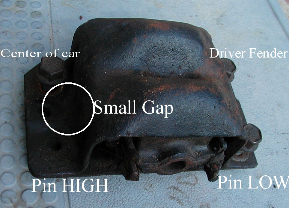

Here's a couple pictures to show the way the factory motor mounts are built and need to be installed.
Factory Motor Mount Passenger Side:
Factory Motor Mount Driver Side:
The first time I installed these headers I didn't catch on and it was a real problem cause I did it to someone else's car. It was an 87 IROC with an LB9 that had previously run Edelbrock 6827's without a problem. Once the clearance problem was discovered Don was notified (5-27-12). The original motor mounts were removed and new POLY inserts were installed. This DID raise the height of the engine seemingly enough to correct the problem; but after some use it's still a problem.

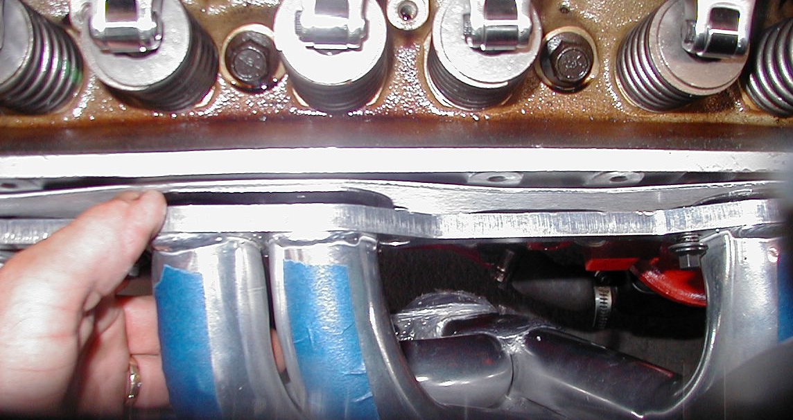

The Second time I installed this set was a month or 2 later on my own car. (LT1 w T56) It had used several types of headers over the years without a problem - most recently Hooker 2640's. I had requested to Don (knowing there had been a clearance issue) that quality take priority over speed of the product and a little over a month after payment the Dyno Don's headers arrived. I place the drivers side header against the head and could not get the rear bolt installed. The header would not move forward far enough because it was hitting the K member. SO,... I bought new POLY inserts.

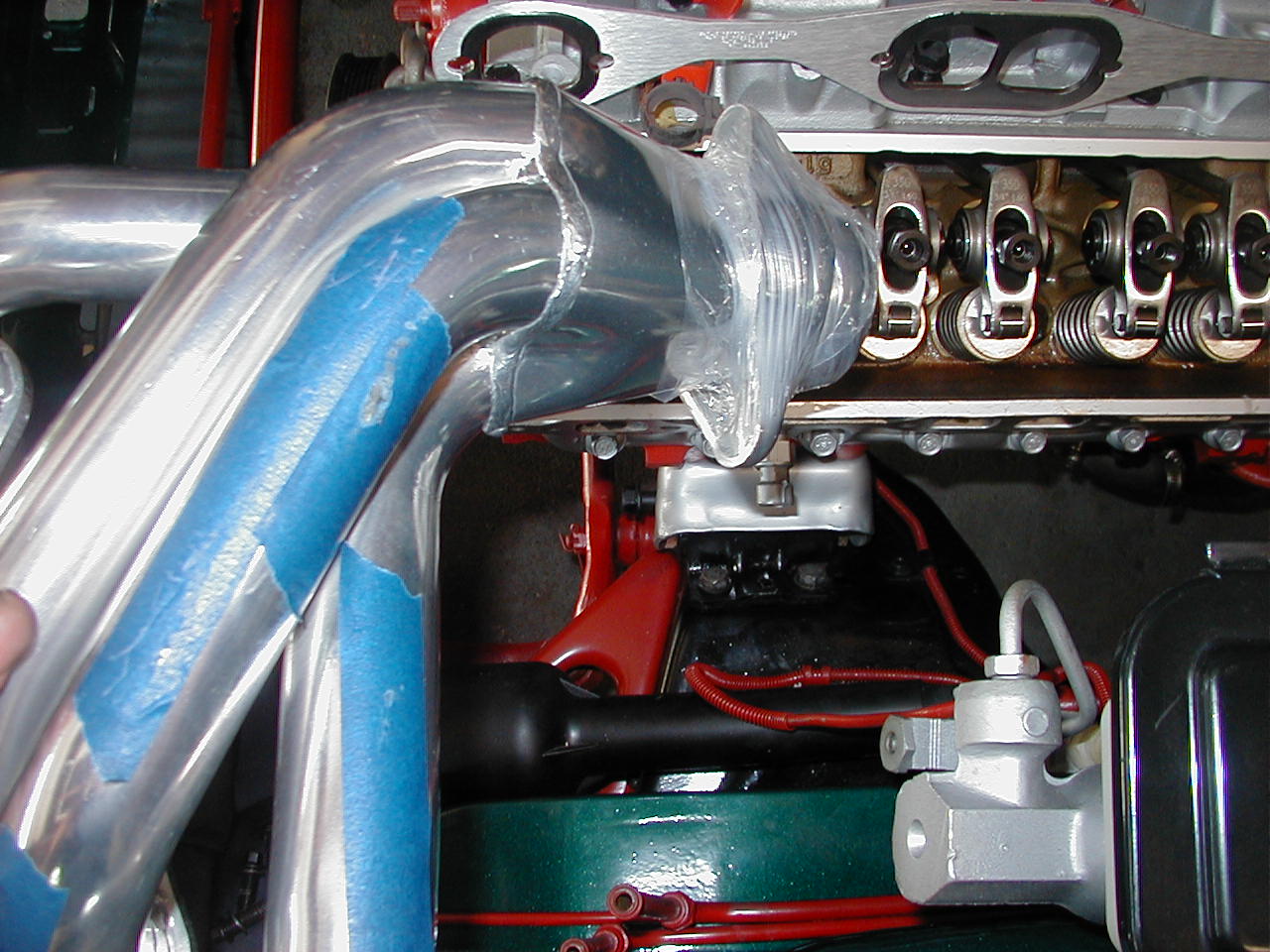

After installing the Poly Mounts I was able to get 1 rear and 1 front bolt thru the flange and into the head WITHOUT a gasket in place and the flange was still not flush to the head. I bought the recommended Earl's gaskets ( EAR-29DD3BERL ) and this is the gap once gaskets were set into place.
The contact point is very easy to see.....
I was left with notching the K member. After 6 or 7 iterations of grinding and fitting I had removed enough of the K member removed to get the header and gasket "flush" to the head.
I had to shave so much metal that a small hole formed; the fresh paint shows the shaved area and the small hole is visible next to the relocated brake line.
Once the gaskets were installed and bolts were all tourqed down I find that I'm BARELY clear of the K member in that spot and pretty certain It will make contact again under load. At this point I'm totally 'done' and the next time I address this problem it will be with a prybar and a hammer.
