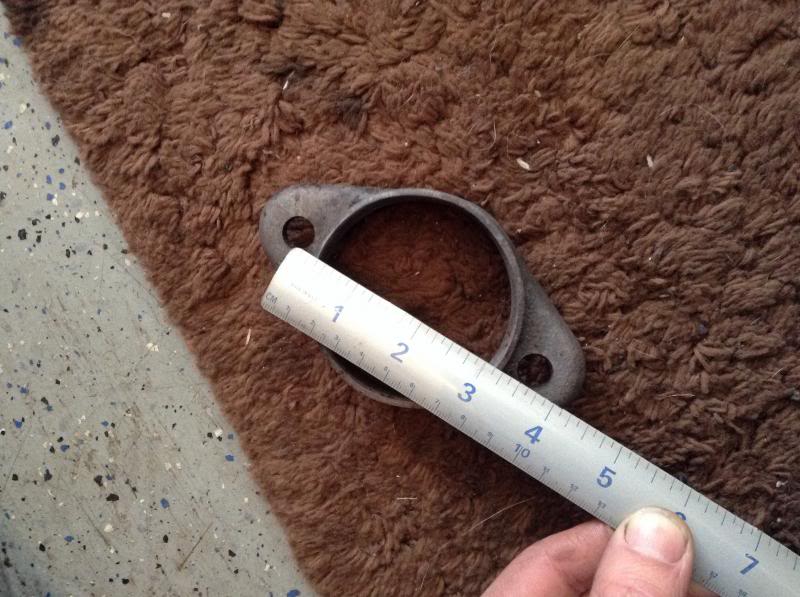

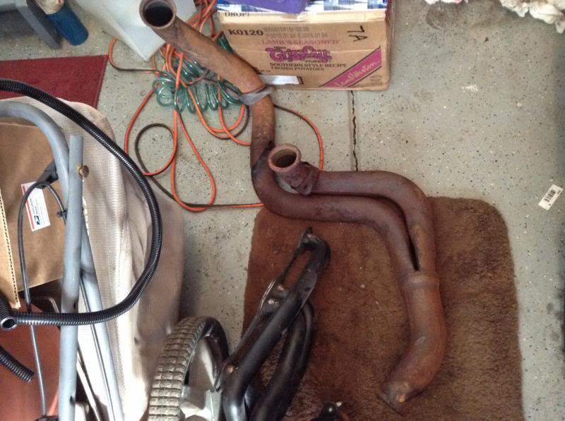

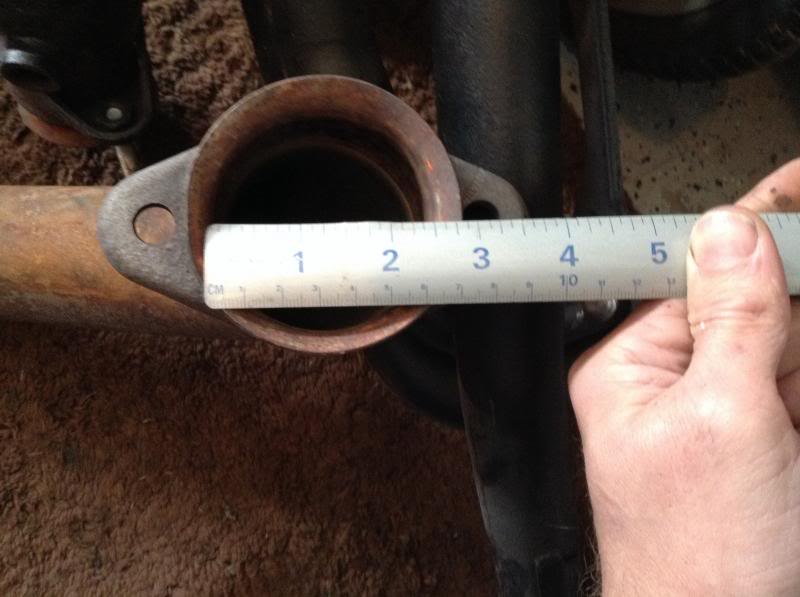

I think edelbrock made two y pipes one for 83-86 and a 87-92 one. both are nla so you will need to fabricate one or get a used one. I have a used 87-92 one. Send me a pm if interested and Ai will measure the flanges and pipe diameter.

Re: Basic Header Question
