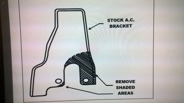

I'm about to do this very project in a few weeks on my '86 IROC, if your car is like my older IROC (compressor on the driver's side/non serpentine), the only fitment issue is on the driver's side, where you will need to remove and trim one of the A/C Brackets. The one that requires trimming is the small one, behind and below the compressor, that bolts directly to the #1 exhaust port bolts. Here is a pic of how it needs trimmed................

My a/c is on the passenger side.
