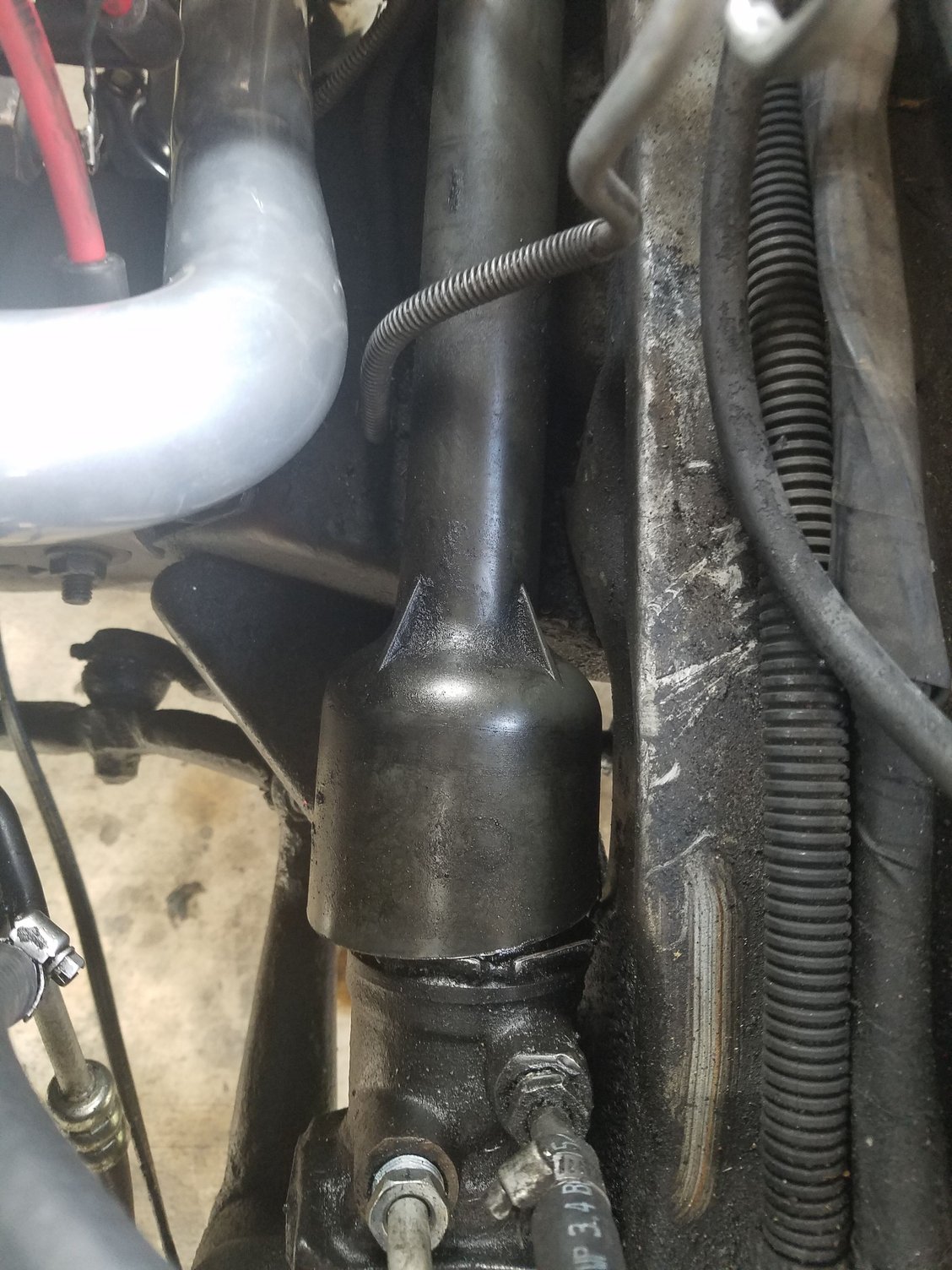

Here are the photos of the steering shaft and brake lines in comparison to to headers. Sorry for the delay.

You need to reroute your brake lines, that's too close.
The Hooker headers are fairly close also as far as the steering shaft is concerned.
I'll try and snap a picture of mine for comparison.

I was worried about how close they were running to the headers, wasn't sure of the negative side effects to it.
