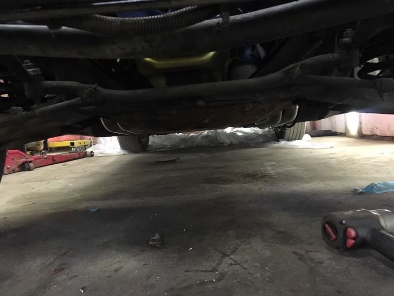

This is the lowest part of the system, back by the rearend. That cup is 4.5" high. The car has original (somewhat sacked?) stock springs.
