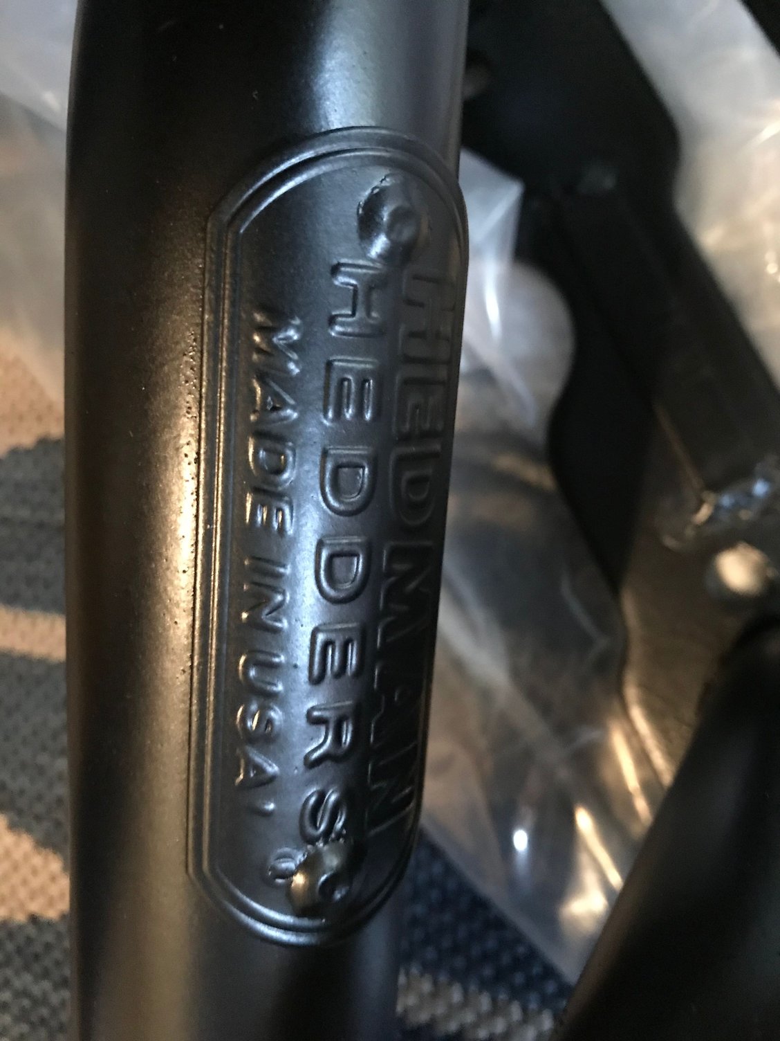

stripped and ready for paint
Originally Posted by Lykoloo
Do you think welding air lines to a set of 2055s would be worth the extra trouble vs just buying a set hedman 68481?
Not at all. With the headaches and the amount of work to remove old and install new you'll want to save as much energy and time you can. I bought the 68481's and it still took a few weekends. I will say I would have paid the extra to have them ceramic coated. I went 'cheap' and stripped all the packaging paint off and painted with Jegs hi temp paint. Turned out okay. It was difficult to get down into all the crevices and took me a Friday afternoon and evening to get them all stripped and painted. Dont go cheap is my mantra on headers.
