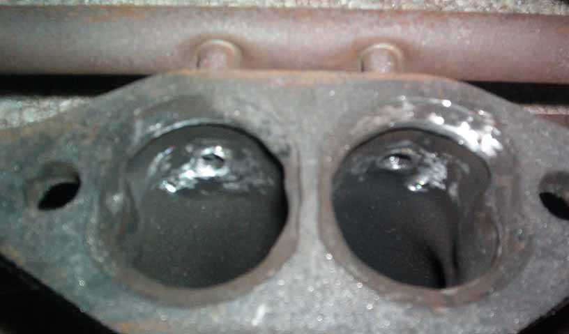

here are my headers, they need rebead blasted cause they flash rusted.
ok my question is this what you are talking about, these right here, i'm supposed to grind these out right? Will it affect emissions much? Cause i want to keep emissions legal even though i'm taking out the cat everything else i'd like to stay.

Yes, thats them. You should grind those down so they are flush with the tube. The basic idea is to get the inside of the header tubes and collectors as smooth as possible, so the flow is as unrestricted as possible and maintaining a high velocity (higher velocity = better)
I'd also take a look through the collectors. Sometimes the welding in there can be REALLY nasty and ugly. My headers were like that. The welds were big and ugly and looked like carbon-coated bird $hit, and in some places, you could even see about 1/2" of MIG wire stuck to the inside.
I just took my Dremel with a sanding drum to the inside of the collectors and smoothed out the welds and got rid of those MIG wires that were in there (there was 3 or 4 of them) and now they look great inside. I had no AIR tubes on my headers, but you wanna grind those down to they are flush with the inside of the tube.

THERCKID "ok my question is this what you are talking about, these right here, i'm supposed to grind these out right? Will it affect emissions much? Cause i want to keep emissions legal even though i'm taking out the cat everything else i'd like to stay.
Kid sometimes you talk in circles, you can't have it both ways, your either going to stay emissions legal or not, theres no halfway. As stated just smooth those down flush, won't effect emissions or function as long as you don't grind through the wall.

is this good?

Looks good to me. Just be sure to attack the welding in the collectors if it needs it too.

That is good on the grinding.
