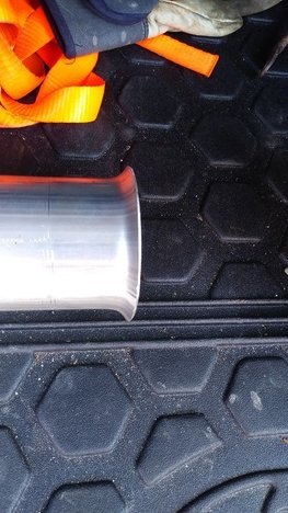

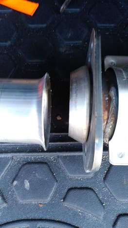

So what exactly is the flare supposed to be like for the pipe that connects to the back of the cat? My stock exhaust is long since gone so I cannot remember what it was like. I currently have the magnaflow duel cat setup but don't like it and am switching to hooker 2055's, their y-pipe and the direct fit magnaflow 3" cat with flare on the back.
I am not sure if the flare on the back of the cat is the same as factory or not. It seems to have a straight angle to it instead of a rounded ball end like on a manifold or header. I first bought a small stubby 3" header collector but it was a rounded socket flare which didn't mate well at all. Next, a friend took the cat to his friend's shop for him to make a flare for me. It is the reverse......a rounded flare like a mushroom. It won't mate up well either and if you clamp it real tight it will probably crush the flare on the cat I would think. Am I correct in saying this is not the proper flare to mate to the cat?

The stock single cats have a ball style flange on the outlet. The exhaust pipe side is a flare.
As long as the flange on the pipe has the roughly approximately the same flare as the male flare, it should bolt up. Walker sells quite a few different flanges and sockets, but it might not be possible to find one large enough for a 3" connection.
