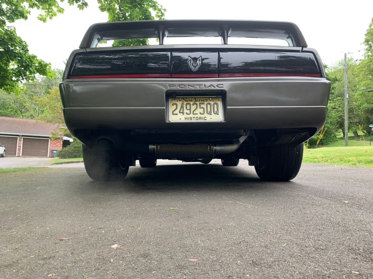

Re: Does anyone have pics of Mufflex 4 inch cat back installed?
They look like the tail pipe on a school bus. Just hanging out there in the wind, not a care in the world for how they look.
Sorry.

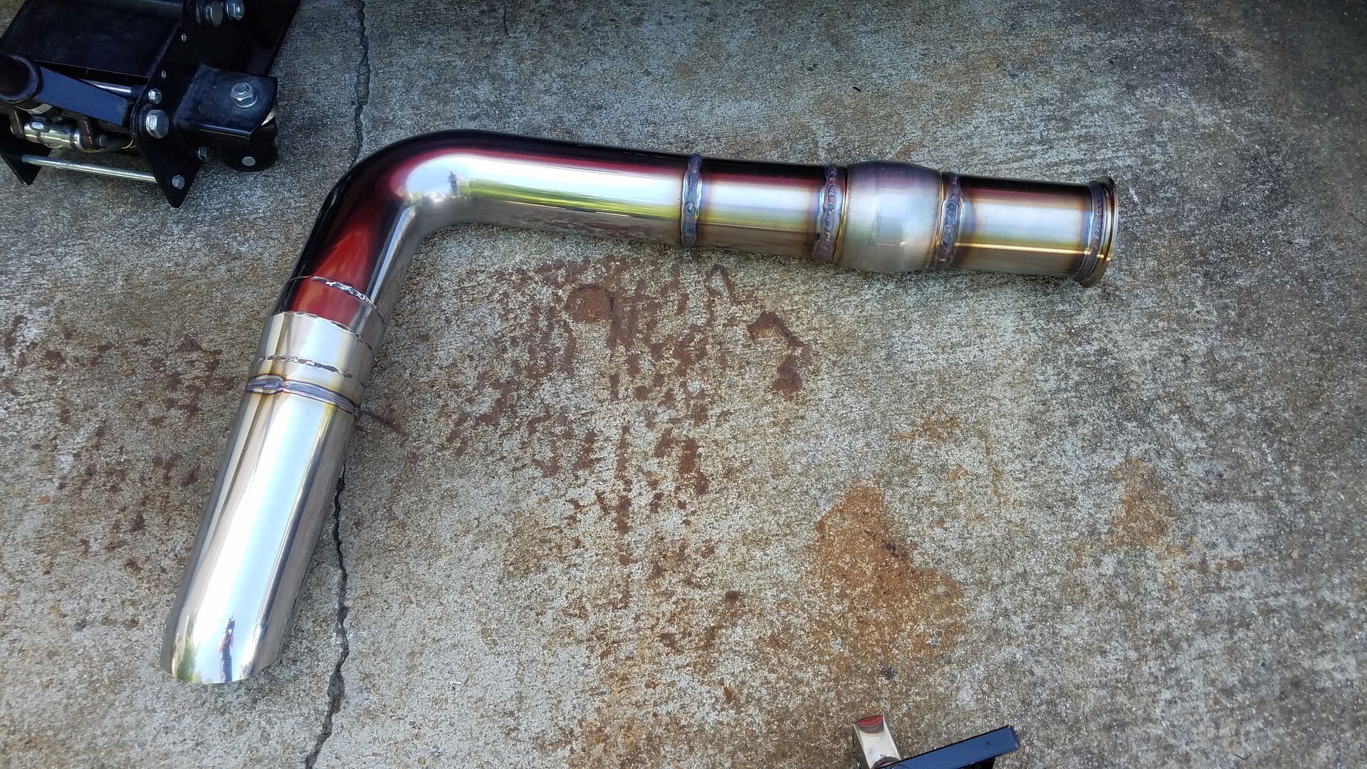

Not a mufflex. I built my own. If it helps
https://www.thirdgen.org/forums/exha...de-4-inch.html
LOL!! No need to be sorry Drew. That's actually what it looks like.

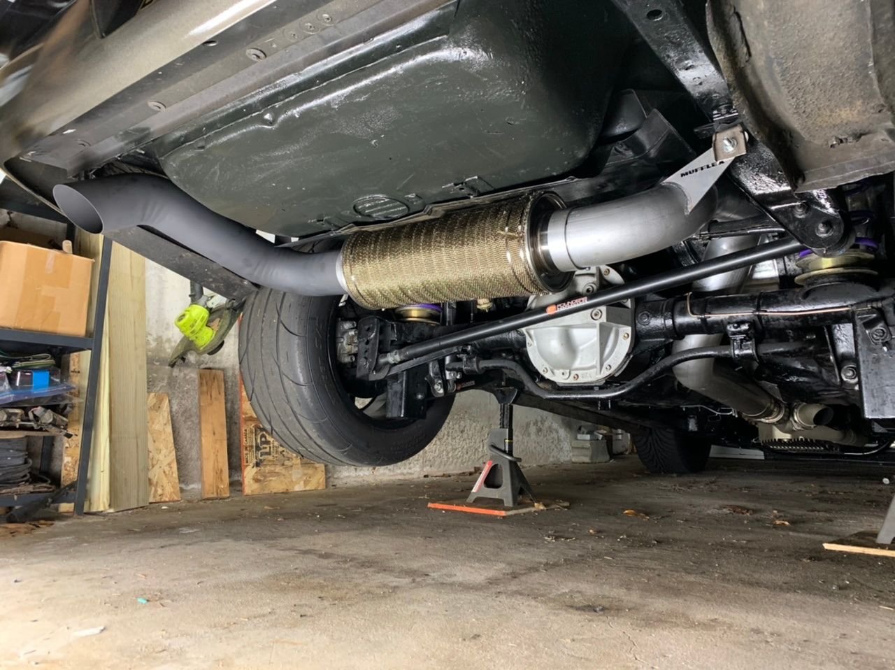

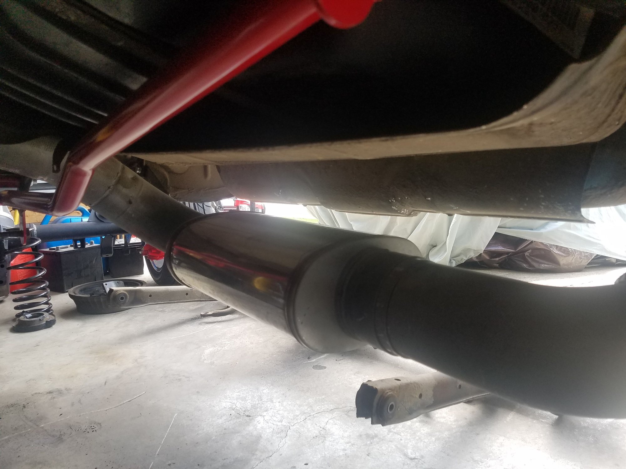

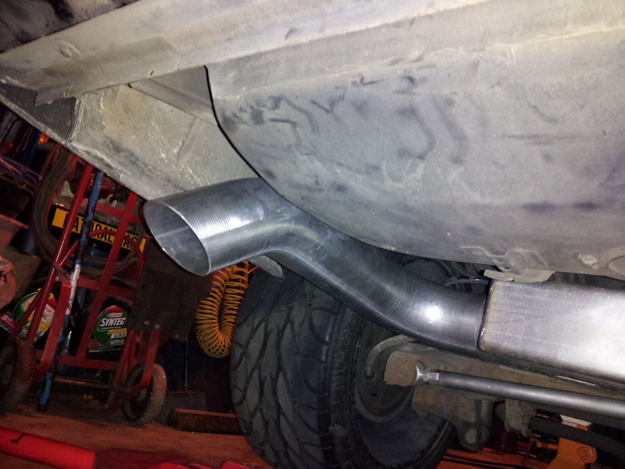

you can carefully trim the pipes to tuck them up higher in certain places for a slightly better fit. This is on my sport coupe except I run the S
pintech on my 4" Mufflex

I'm hoping to be able to redo mine when I pull the rear.
How do you like the Spintech?

The SpinTech reminds me of a custom Flowmaster type muffler, similar in sound. I Installed this years ago replacing my 3" Flowmaster setup so I wanted a that sound. Now I have recently been considering switching to a Borla muffler to change up how it sounds but it all comes down to personal preference

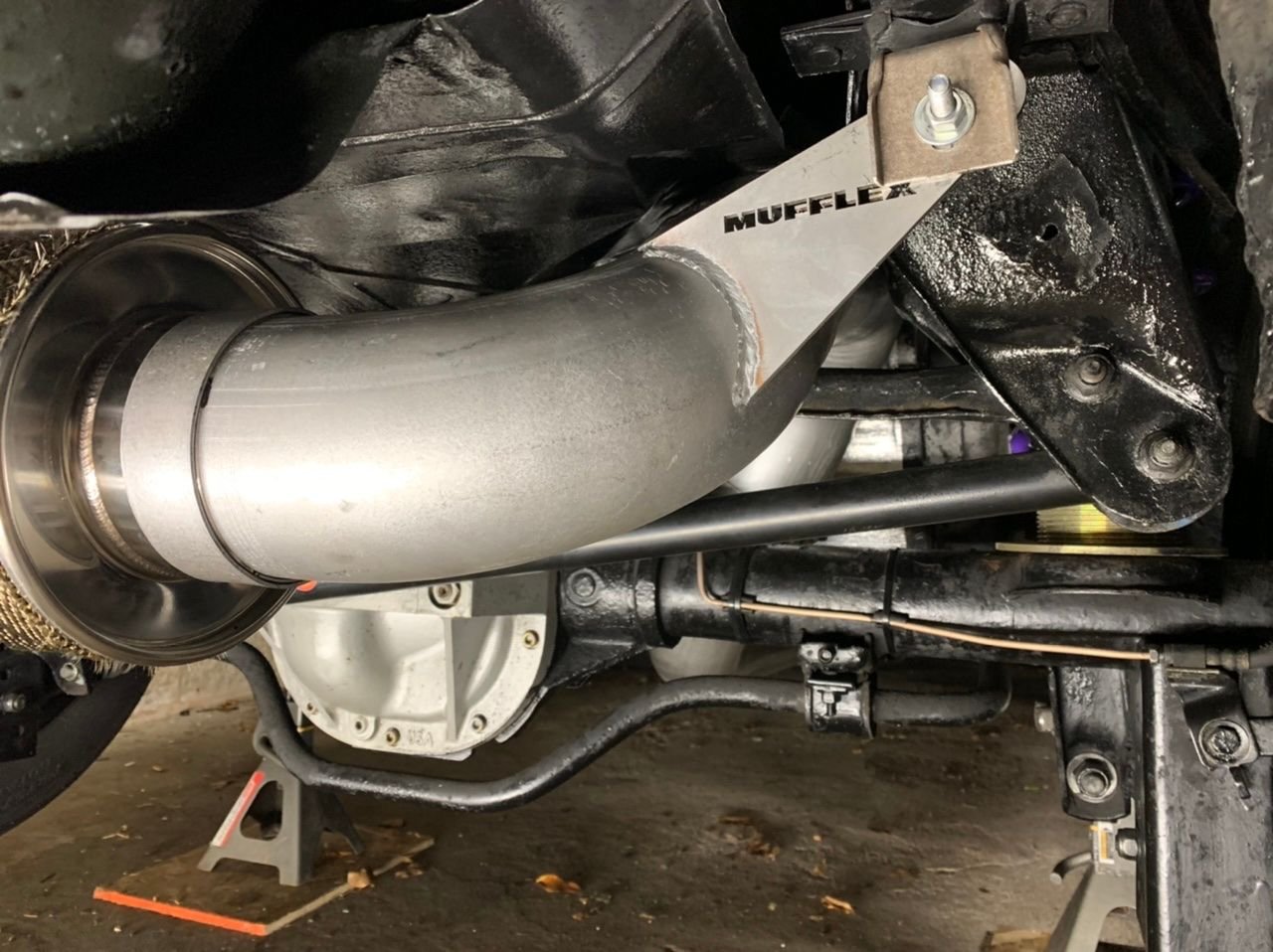

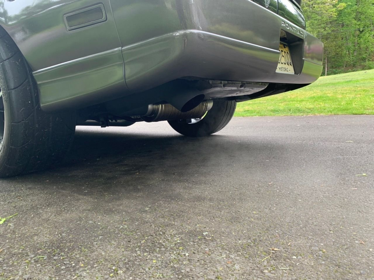

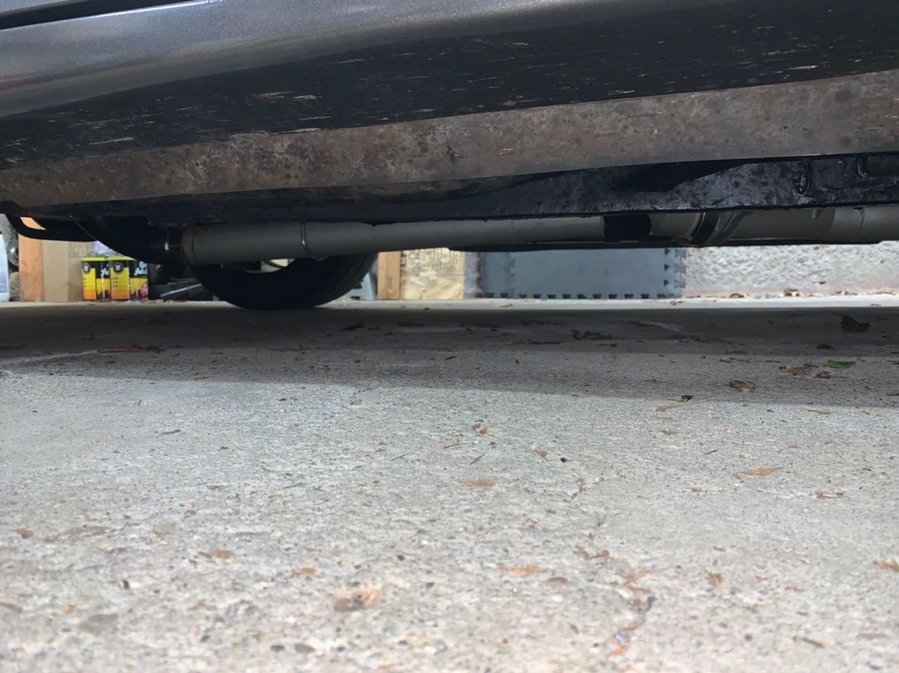

I just installed mine a few weeks ago. I’m using the Magnaflow supplied with the Mufflex kit, but I managed to tuck the system enough to run a 6 inch OD dynomax bullet muffler to take the bite out of it a little. I have a stage 4 cam, so a 4 inch system was a pretty bad idea on a daily-ish street car. I might experiment with a diesel muffler in place of the Magnaflow eventually. Hell if I ever managed to make it TOO quiet, I can always add a cutout. Also before the Magnaflow I had a Hooker quiet flow as you can see below. Quietflow my ***, the magnaflow ended up being quieter so I swapped it out.

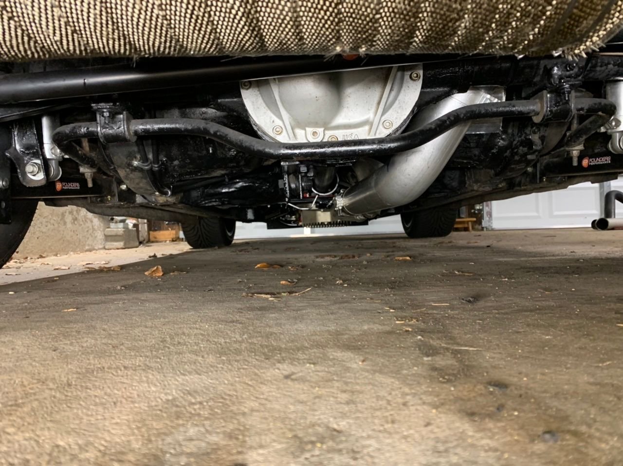

I just ordered the Hawks sinister... if it ever ships geez. I also ordered a vibrant 15” case muffler and hope it will help tame it. I have a 3” mandrel catback with a single 3” offset borla pro XS muffler and it’s too quiet. I also run a cutout before the catback which I open up for power as I have a single turbo 5.3. My tests show over 2psi drop in boost with the cutout closed and exhaust pushing 3” from the turbo out the tail pipe. If I open the cutout it’s 2-2.5 psi increase with no changes. Plus I get lots of turbo spool with the cutout open, close it and the turbo makes no noise. I hope that my turbo helps quiet the exhaust as well in conjunction with the vibrant muffler. The muffler is on back order till middle of next month so I’m literally just waiting for parts to eventually ship. I’m hoping the 4” catback will help bring some turbo spool noise back and take a bit of the edge off compared to the cutout which really isn’t all that bad honestly. The 3” catback just kills power tho but it also quiets the car down a lot.
I personally like the hidden tip approach and I’m going to cut and tuck the 4” outlet as best I can when it gets here.
I’ve tried looking for oval case mufflers in 4” with offset inlet outlets but I want straight through perforated core. Aero chamber is ok, but I would like stainless and the biggest case I can fit to help with the noise. Been trying to find a 20” dynomax ultra oval is impossible.

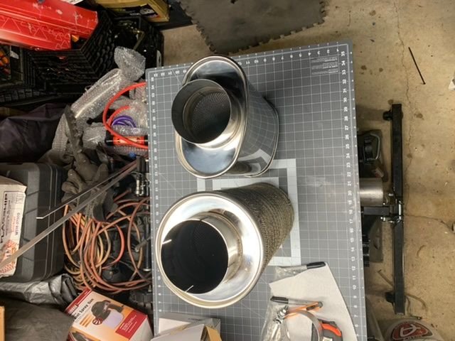

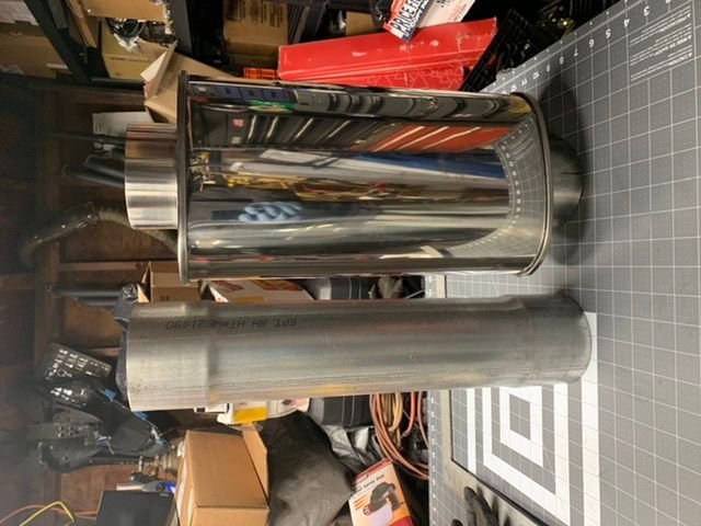

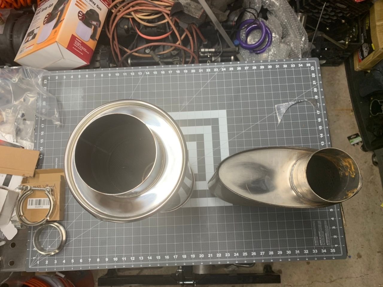

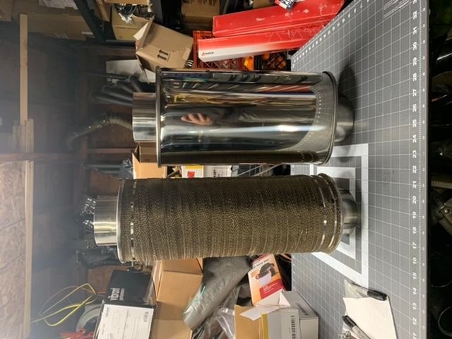

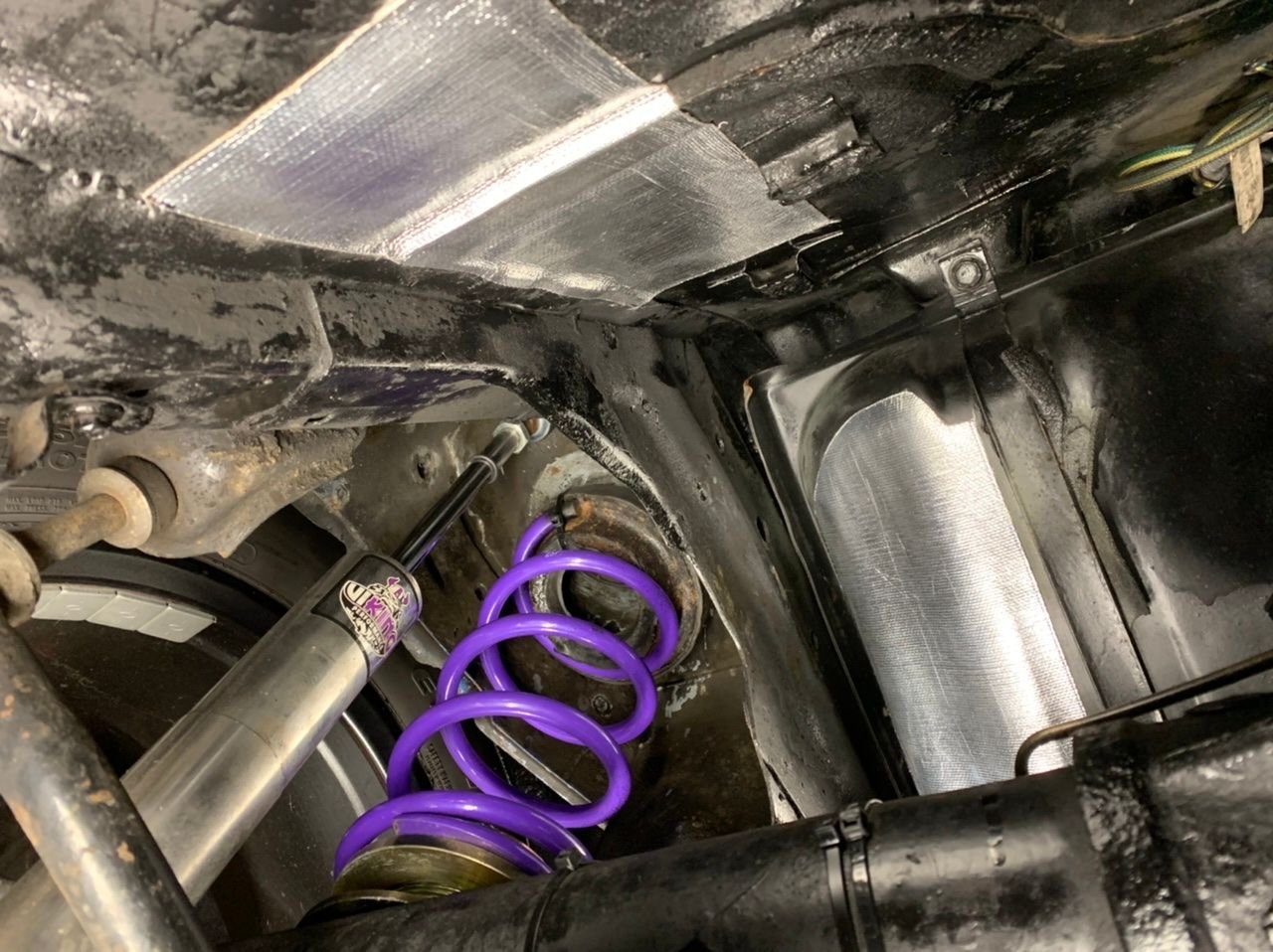

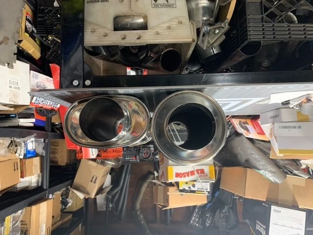

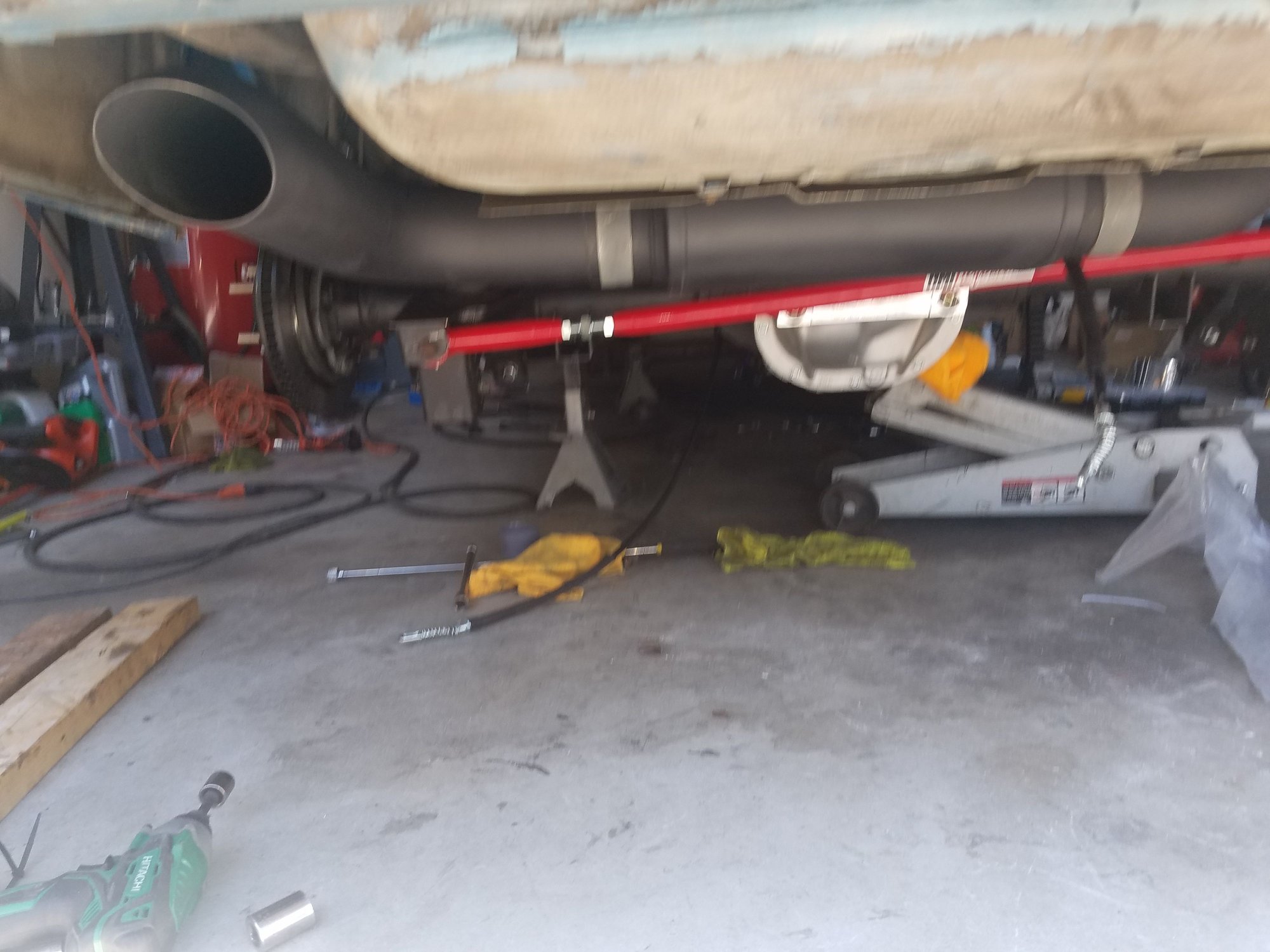

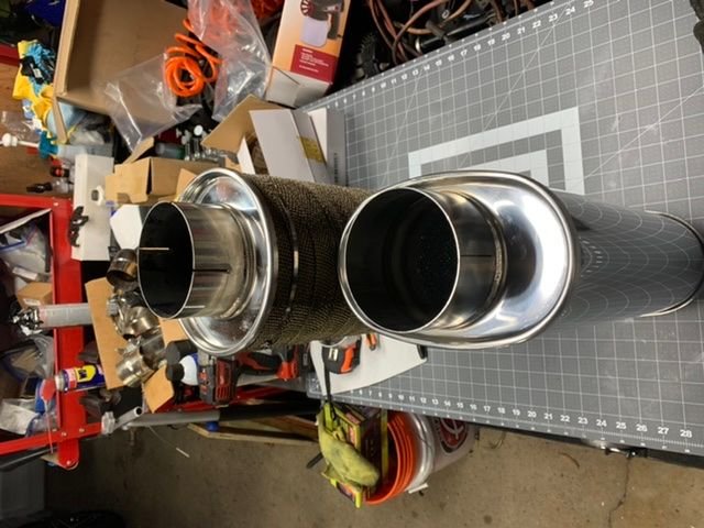

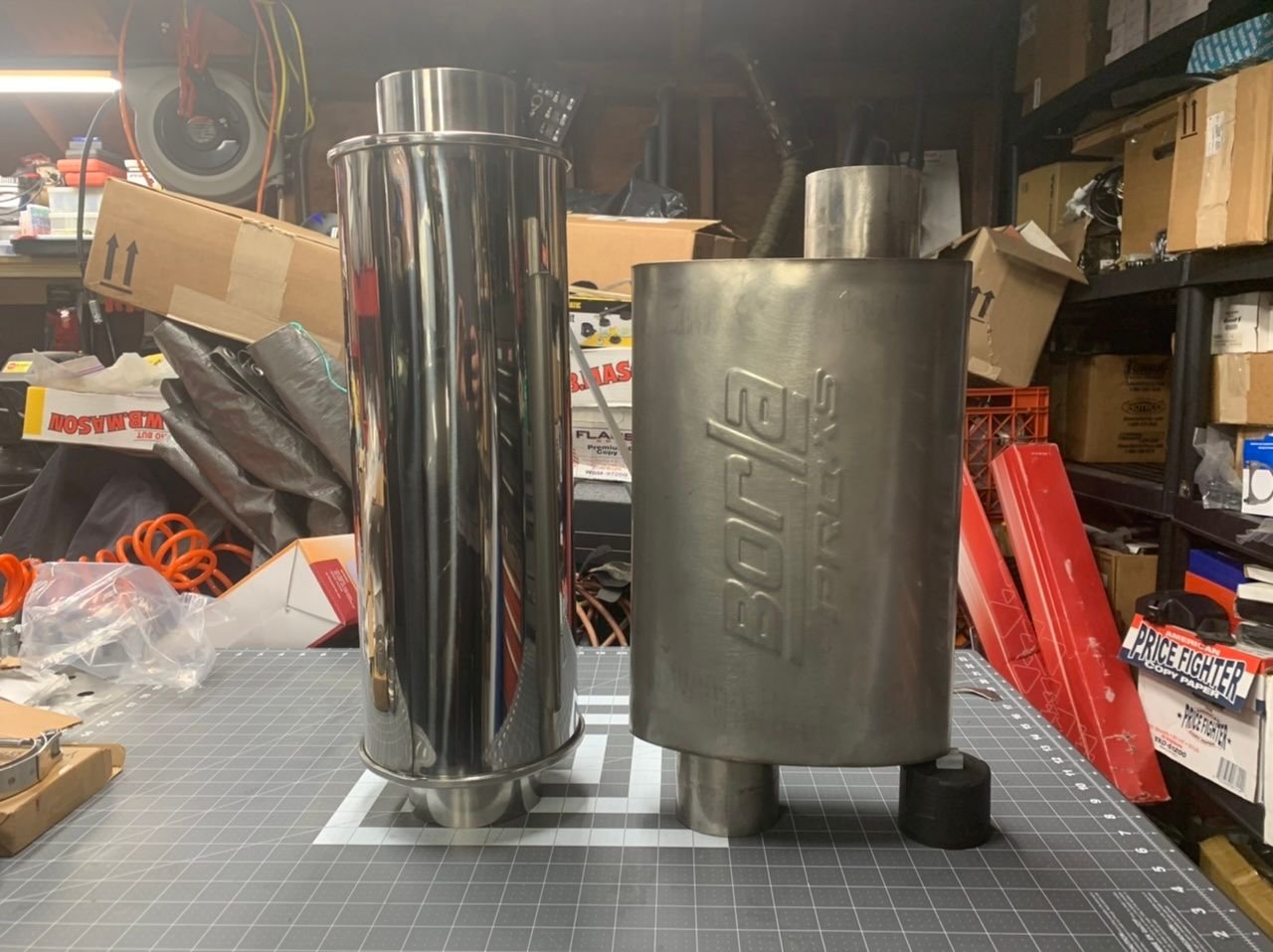

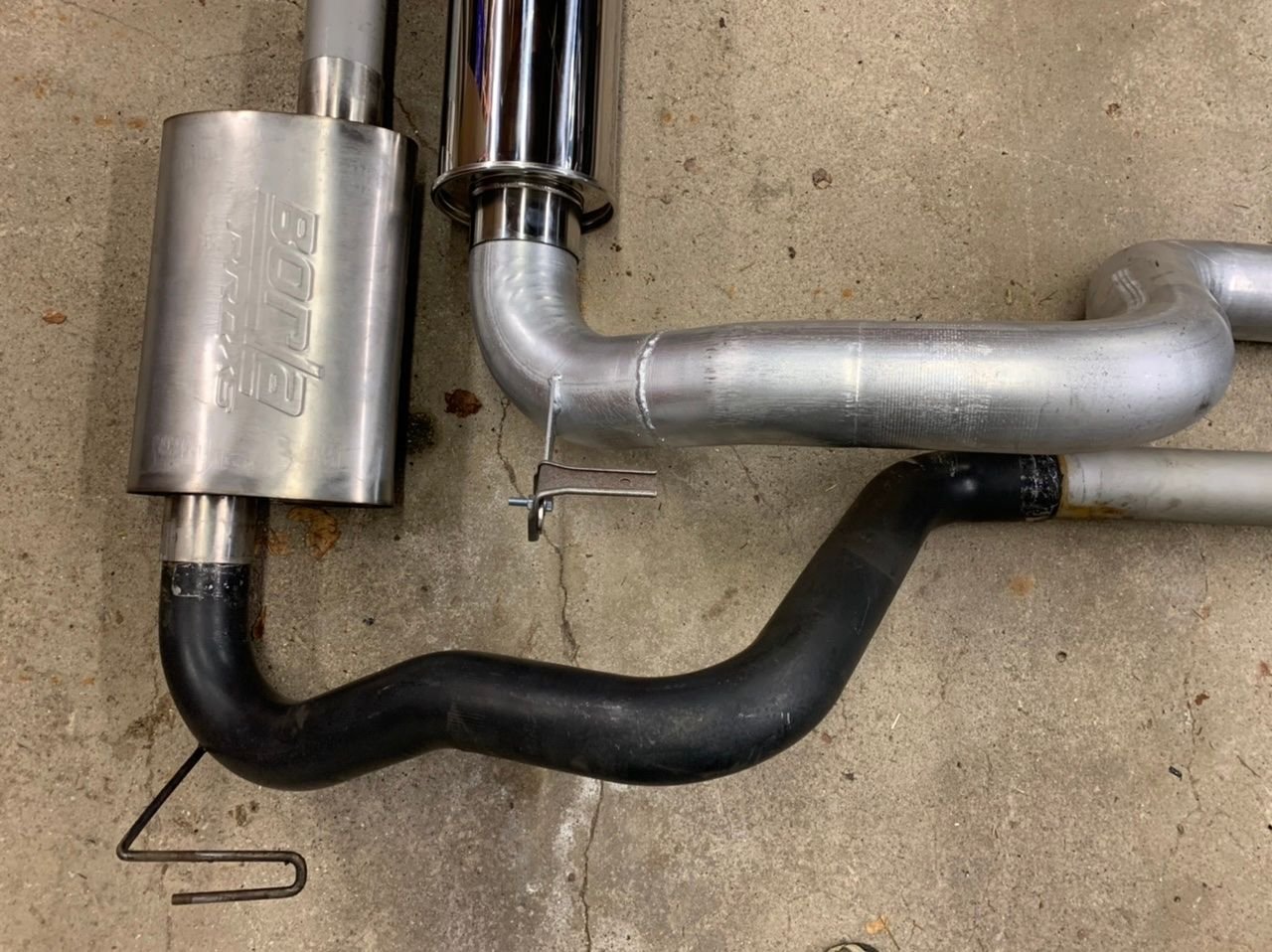

Got my muffler today, fedex is late and looks like the catback will be here tmrw.
last night I removed the 3” catback and added some adhesive heat barrier to the gas tank and behind the rear seat. I’ve never had an issue without anything before since I don’t have that heat shield at the back of the floor behind the pass rear seat.
this muffler is very nice, she’s a big girl too lol. I hope it fits, here is the comparison compared to the 3” inlet borla proXS 14” case. I have the oval version on back order if this doesn’t fit.

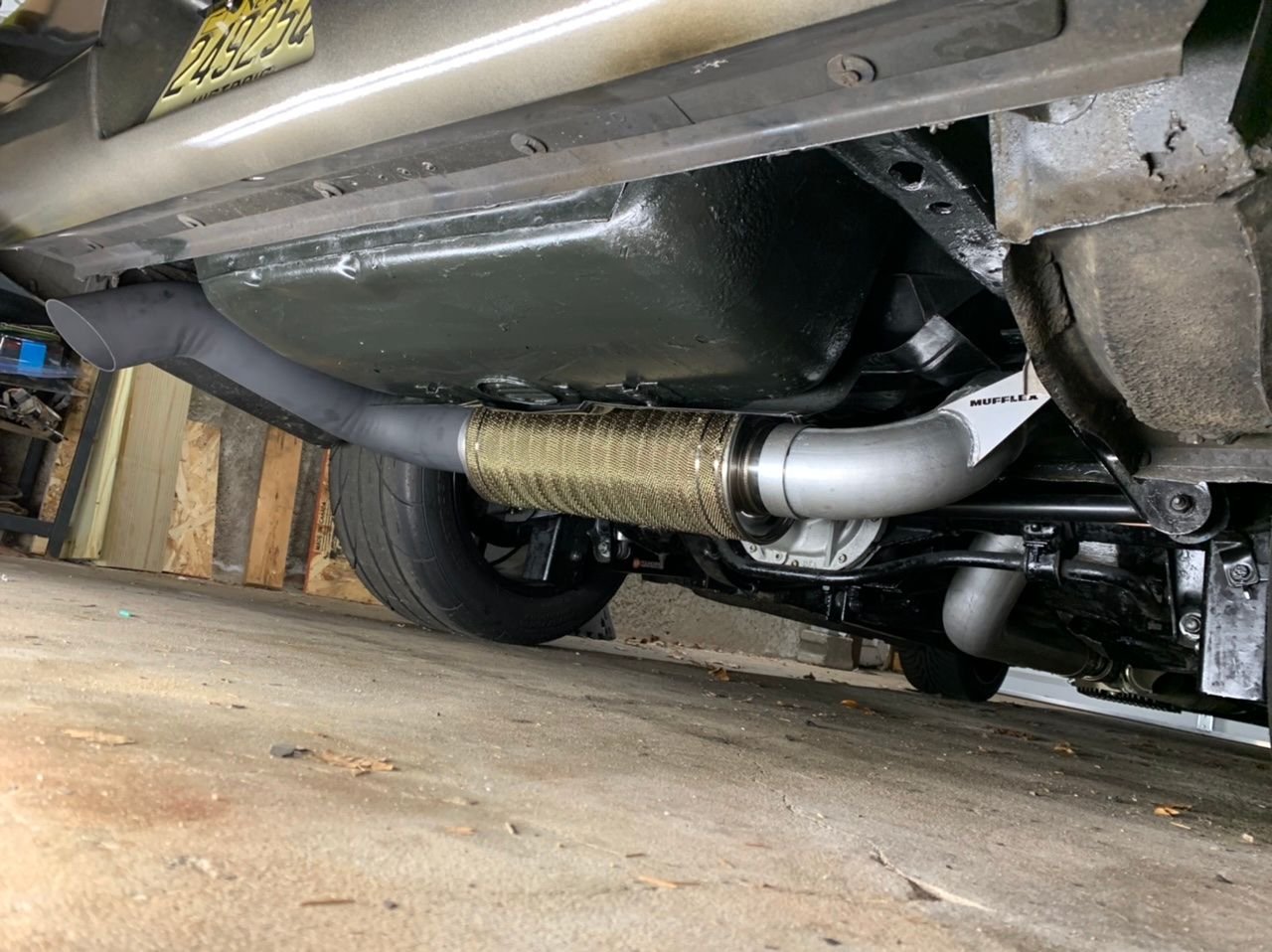

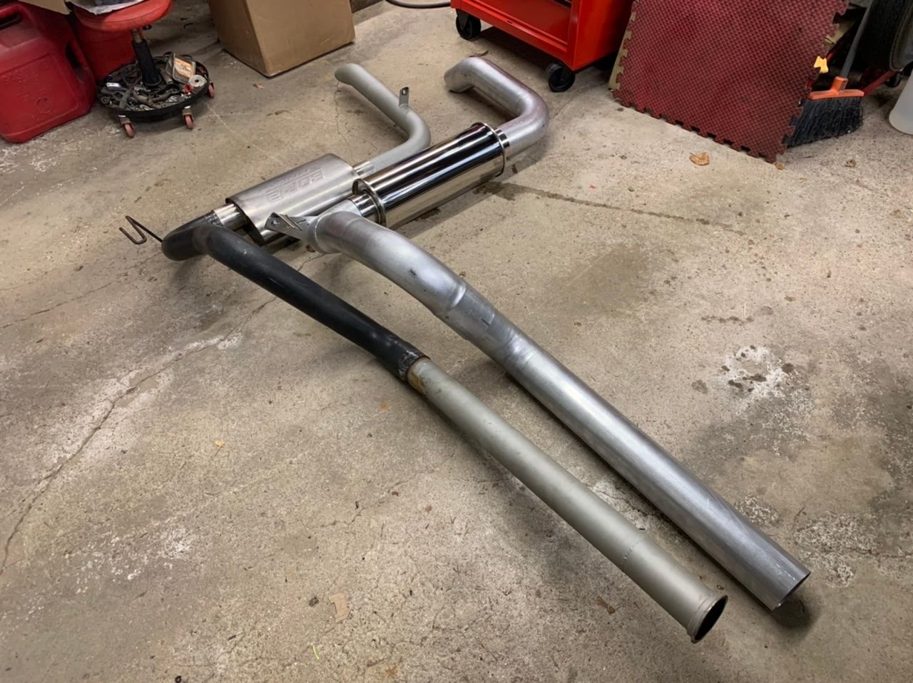

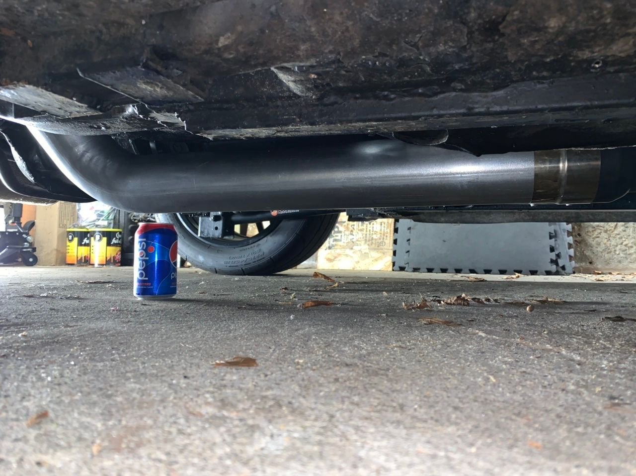

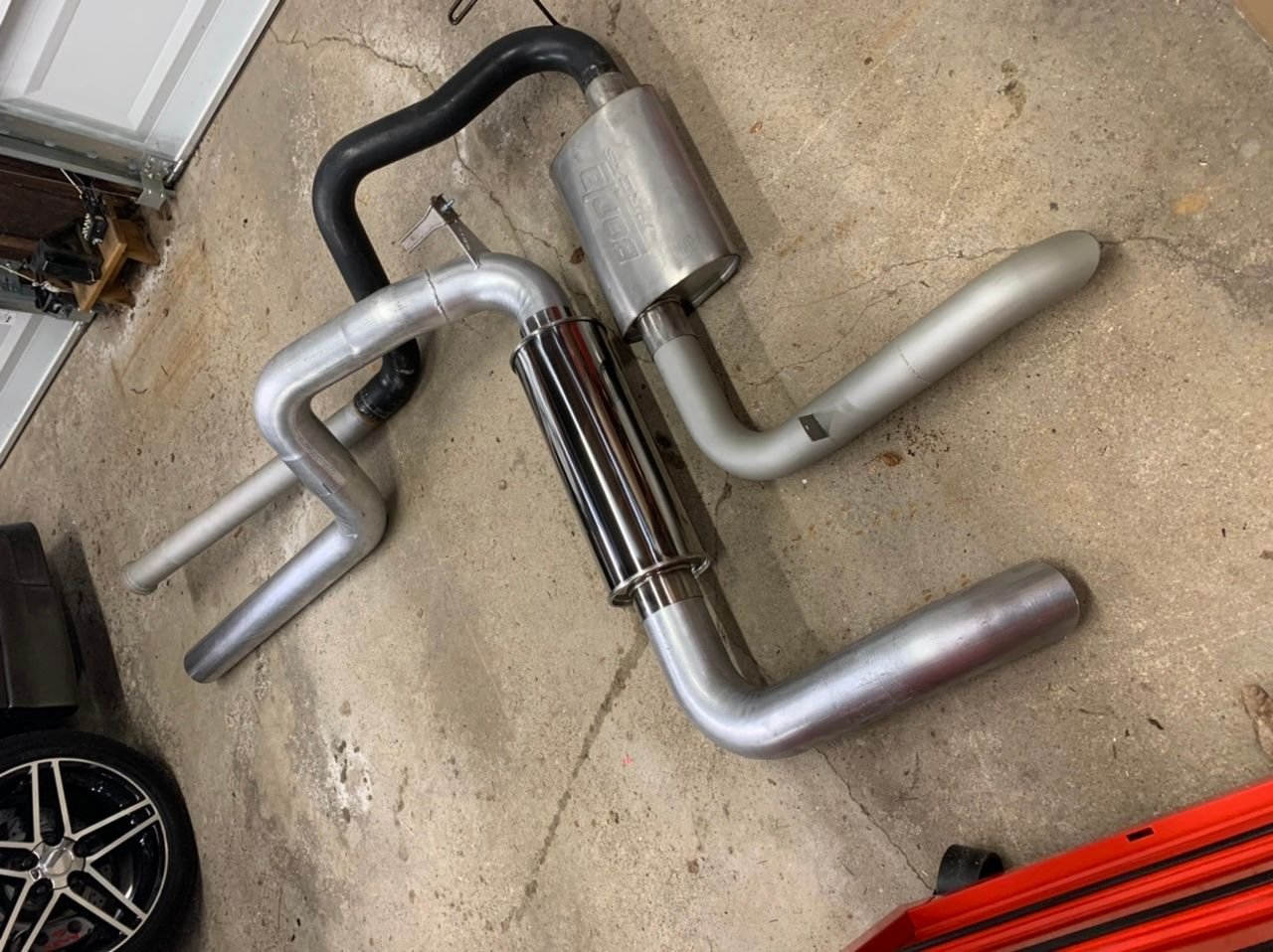

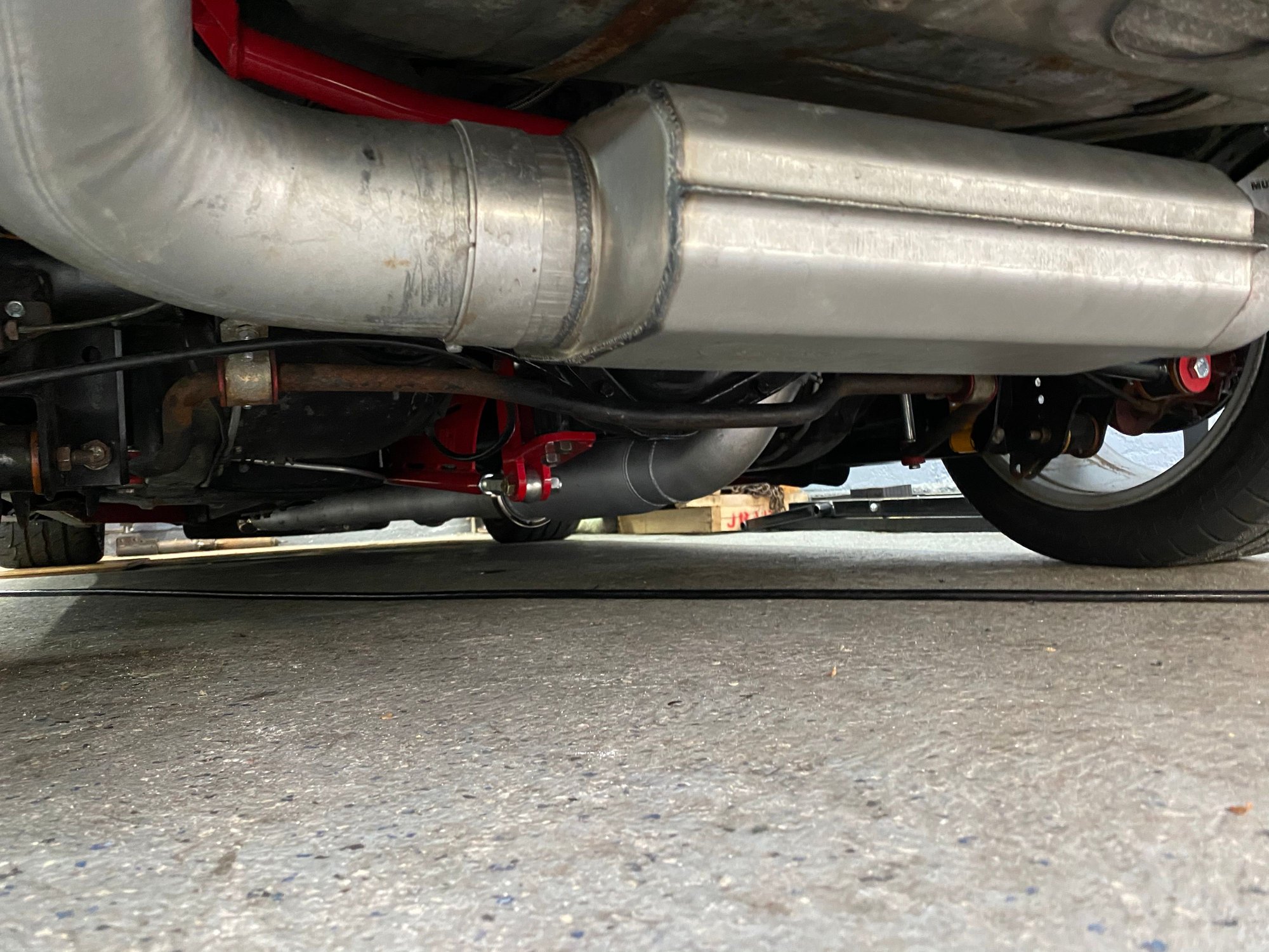

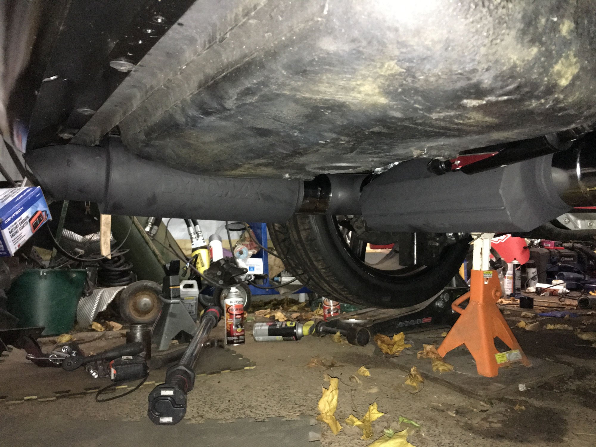

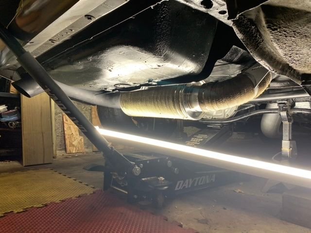

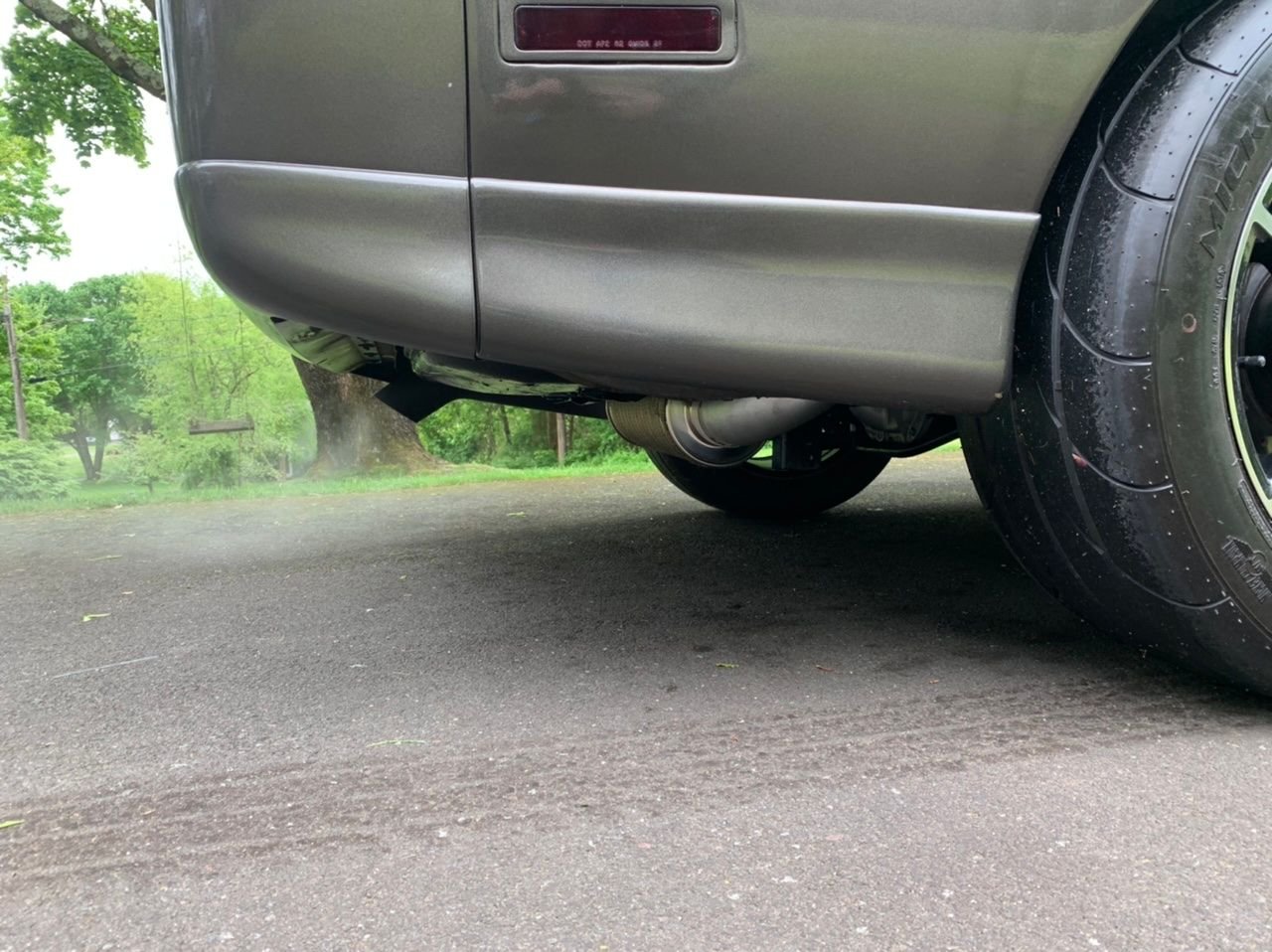

Got the system today In case your wondering it’s the hawks 4” sinister catback. Opened it up and the over axle pipe has a mufflex mount on it! Looks like hawks is just using the mufflex parts in there kits... I’m not mad about it either!
Spent 5hrs (lots of time making it purdy and fitment to my turbo down pipe. Ended up with more ground clearance than my 3” summit catback. The summit catback the over axle part is all 1 formed piece so in order to get it out I had to drop the rear axle, unbolt the PHB and PHB support... annoying. Summit over axle piece didn’t give me a lot of over axle clearance either and was never impressed with how it fit. This Hawks sinister kit fit like a damn glove! Over accel has more room over the axle and I have like 1/8-3/16” clearance between the PHB support and the exhaust. How they managed to figure that out must have taken a while but I can’t be happier with the fitment. Installed and wrapped the vibrant 18” case 22” overall muffler which fit without trimming and it cleared the muffler heat shield. I had the header wrap and I hate chrome/polished SS so I wrapped it vs painting it. I made my own tail pipe mount and bolted it up bright and tight to the underside. I’m fine with the fitment and how it looks but I won’t know for sure till I can start it and get it out in the driveway and get a good look. I painted it back to hide it tho in the mean time. I haven’t started it yet (1am now) so hopefully it’s not as loud as I think it’s going to be lol. If it’s good, I’ll drive around with it for the summer, see how it sounds and If I can tolerate it I will pull it again in the fall /winter and give it a good coating of creakote. I just don’t want to invest that time if I can’t stand it. Think I’ll start an install thread if u guys want to check it out.
FYI my car is not stock lol in any form and I have 18”
rims, drag radials on the back 27.7” tall and 26.7” tall front tires, weight jacks all around with 850 front and 175 rear springs. My car looks lowered but I have a 29.25” rear quarter height and 27.5” front fender height which I believe is around the stock height. Do ground clearance will be different on a lowered than stock height car. My lowest part is my deep trans pan.
This was with the summit 3” catback.

Started it up and shocked by how quiet it still is. Here are some videos. These idle shots are outside in the same spot so the sound should be close (nothing to echo off of)
here is the before video with the borla proXS muffler idling.
here is the after video with the 4” catback
Driving the car down the highway with 4” catback
honestly I took the car out for a drive and the car is much quieter than I thought. It’s louder than the borla 3” but not as loud as I was expecting. I was able to get alittle more turbo spool through the full exhaust but still nothing compared to what the cutout provides. Overall the car is still pretty quiet and I can cruise down the road with the windows down and not hear the exhaust much. Depending on how I feel I can always do a muffler delete or put something smaller in

Customblackbird,
My over the axle pipe is a little different than yours. I pulled the rear yesterday and you can really tell how much the exhaust hangs down. I'm looking at getting a longer muffler to try and quieten it down a little. The magnaflow muffler case is 16 inches.

Originally Posted by BrianI
Customblackbird,
yours looks a good bit lower than mine. Mine is a 7” DIA muffler and I have less than 1” between the muffler and heat shield. So if you measure the top
edge of your 4” OD pipe that would be 2.5” from the pipe to the heat shield. If I had to guess with yours your closer to 4”-5”. With the 18” case on mine the exhaust is pretty quiet, but I have a turbo that helps. Dynomax has the perfect muffler, ultraflow perf core but offset inlet/outlet but I think the case is 25-30” and that would be perfect if the muffler could be shortened.

for those of you wondering my smaller oval case vibrant randomly shipped 3 weeks early from Jegs and arrive today. It?s a 5x9x15 case with 20? tota
length however it?s really 5.5?x9?x15? and a 19?
overall length. The way I fabbed the exhaust it fits the 22? long 7? DIA round muffler better after test fitting tonight. The smaller vibrant is a direct swap for the Hawks muffler delete pipe (same 19? length) and it?s a good bit cheaper than the maggy. The 7? round only hangs .75? lower than the oval so im fine with that and its not lower than my rear. I did not like how much gap is above the oval muffler than the heat shield... almost wished I could tuck the over axle pipe up higher and if I could then I would run the oval smaller muffler. I def picked up power over the 3? catback and got alittle more turbo whine but still
nothing compared to the cutout being open. got nothing bad to say with this hawks/mufflex catback, lots of ground clearance and great fitment.

Good deal. Great info for someone looking to go with a 4 inch exhaust.
I'm going to cut my over the axle pipe and get the muffler closer to the heat shield.
The magnaflow muffler that is on mine is actually 14 inches in length and not 16 like I previously stated. Does anyone know if a Flowmaster Delta flow race muffler would be quieter?

I can see you being able to tuck that up a good bit... maybe even just a small bend (weld in a 15* bend section or something) to push it up like a small pie cut.
Flowmaster will hurt flow but my understanding and experience with chambered mufflers is they are louder all around. They dont do $hit for canceling sound waves and all they do is hurt flow. Straight through are quieter at idle and low rpm but get louder as the RPMS increase... idle is a DEEP tone and not loud/crackly like a chambered. Your best bet to quiet will be a muffler with internal packing to absorb sound waves. Your only going to get that with a straight through or turbo style muffler config. I doubt you will find anything in turbo style at 4" and in the space constraints. I think a larger straight through would work better and quieter. I think you just need more muffler to help. The vibrant I'm running would drop in more than likely and its 18" case vs your 14" which is 4" extra (even though the inside is only 12" open perf core). Or you can run another muffler as a tip. I did that with a dynomax ultra flow straight through and run both mufflers together to get more case. Below is a pic of the 4" exhaust I made with a 14" case hooker max flow in the stock location (i was running a sumped stock tank) and a dynomax round as the tip/tailpipe.

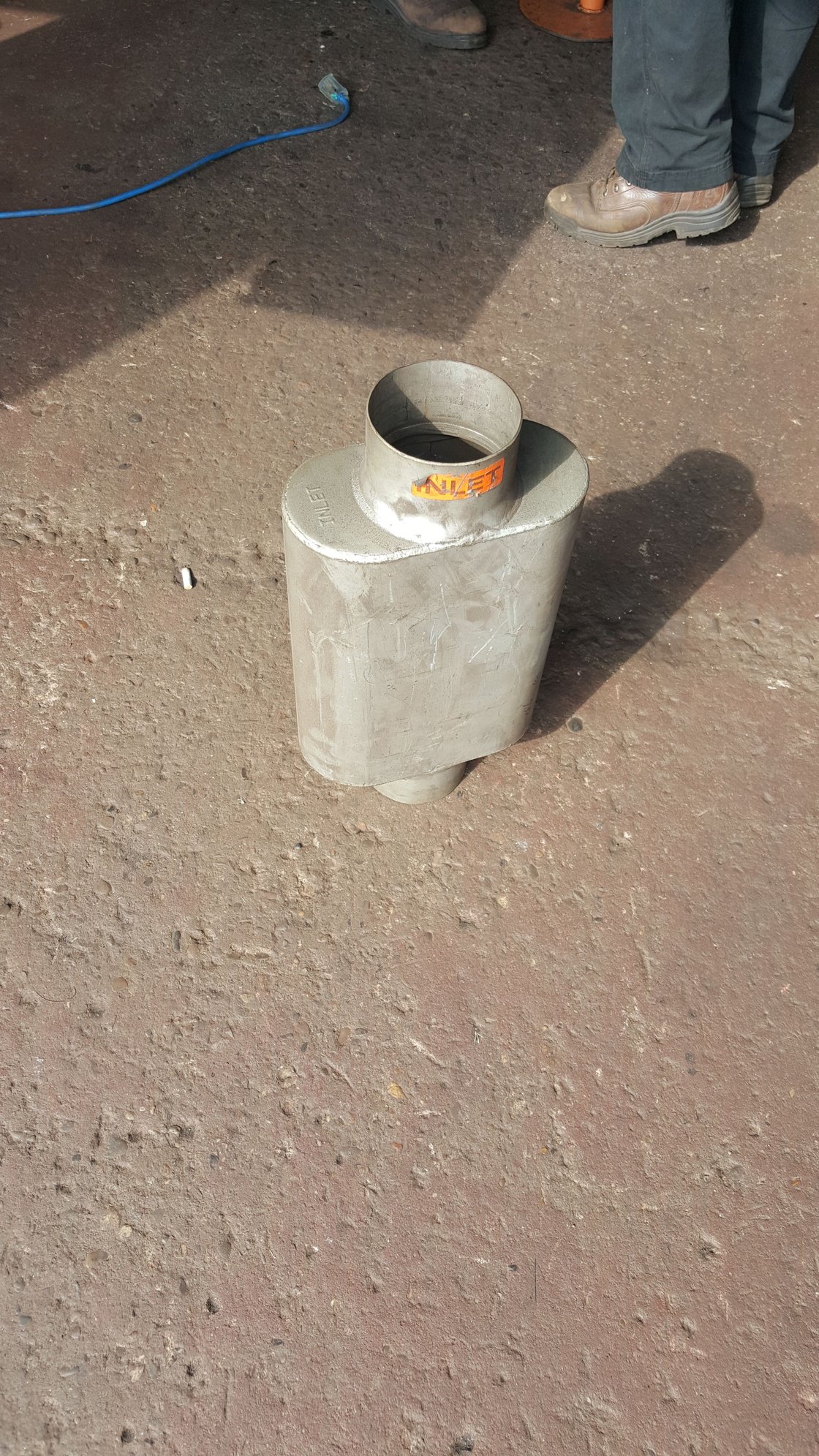

We have a 4.5 inch mufflex exhaust and we use a 2 chamber flowmaster its huge i dont see how that had a huge restriction it could i.guess..

don?t think I do of that older setup. It was fine at idle, nice deep tone and not loud. But above 2000-2500 it would get loud but that?s when the car had a supercharger and was LTs into dual 3? into a 4?
merge and 4? all the way back. I got rid of it bc of the sound on the highway it was too loud for cruising but had no drone or resonance etc.
look into the Flowmaster and let me know if u can see through to the other side lol. I bet you can?t and that?s the restriction. They put metal plates in the way and make the exhaust go around and through paths to create sound waves that cancel themselves out. Compare that to what I posted... straight through tube and tell me which one is more of a restriction lol. There are proven Dyno sheets of how much power a Flowmaster will restrict. One guy flowed a super 40 vs a straight through of the same size and saw a 220cfm difference. Some guys report 30+ hp switching from a flow master to a magnaflow or similar straight through design on our specific style of car. I know Steve Brule from west tech did a test and on the top end they all made the same ish Hp but big differences under the peak tq.

shortened the over axle pipe, trimmed the tailpipe and painted black. Pic is terrible!

looks like u were able to tuck it up a bit! Looks better.
