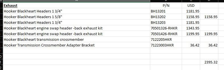

I've compiled a list of the various headers (1 3/4" and 1 5/8") as well as the complete exhaust systems (2 stainless grades for auto transmission).
The crossmember listed is for a 1984-1992 GM F-Body LS Swap T56/T56 Magnum/4L60-4L70*/4L80-4L85*/TH400*/2004R* Transmission.
All prices, descriptions and PN's through Summit. Holley's website isn't the most navigation friendly.
