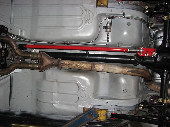

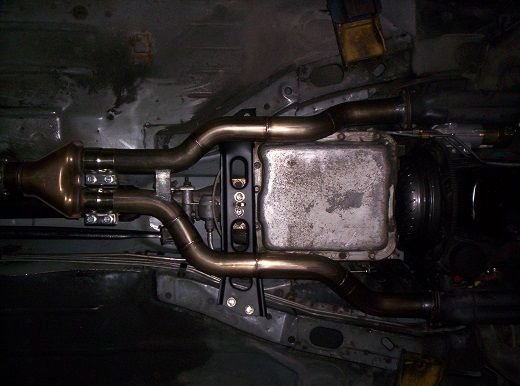

Then it's up to you to connect your headers to the cat-back arrangement with something like this:
That y-pipe above is 2-1/2" stainless and the merge is a Magnaflow 2x 2-1/2" into a single 3".
A better look below. These were first built for an 86 IROC and later transferred (with all of the road rash) to an 86 Sport Coupe.
Then the cat-back intermediate pipe was modified by cutting off the catalytic flange. You can see the extension of the 3" pipe where it connects to the merge. For ease of installation and removal (about ten times to date) a 3-bolt flange was fitted to the 2 into 1 merge. The whole thing bolts in with 9 fasteners.
In your case, if you want to keep the current exhaust then you'll have to build that y-pipe and connect it to your headers of choice.
