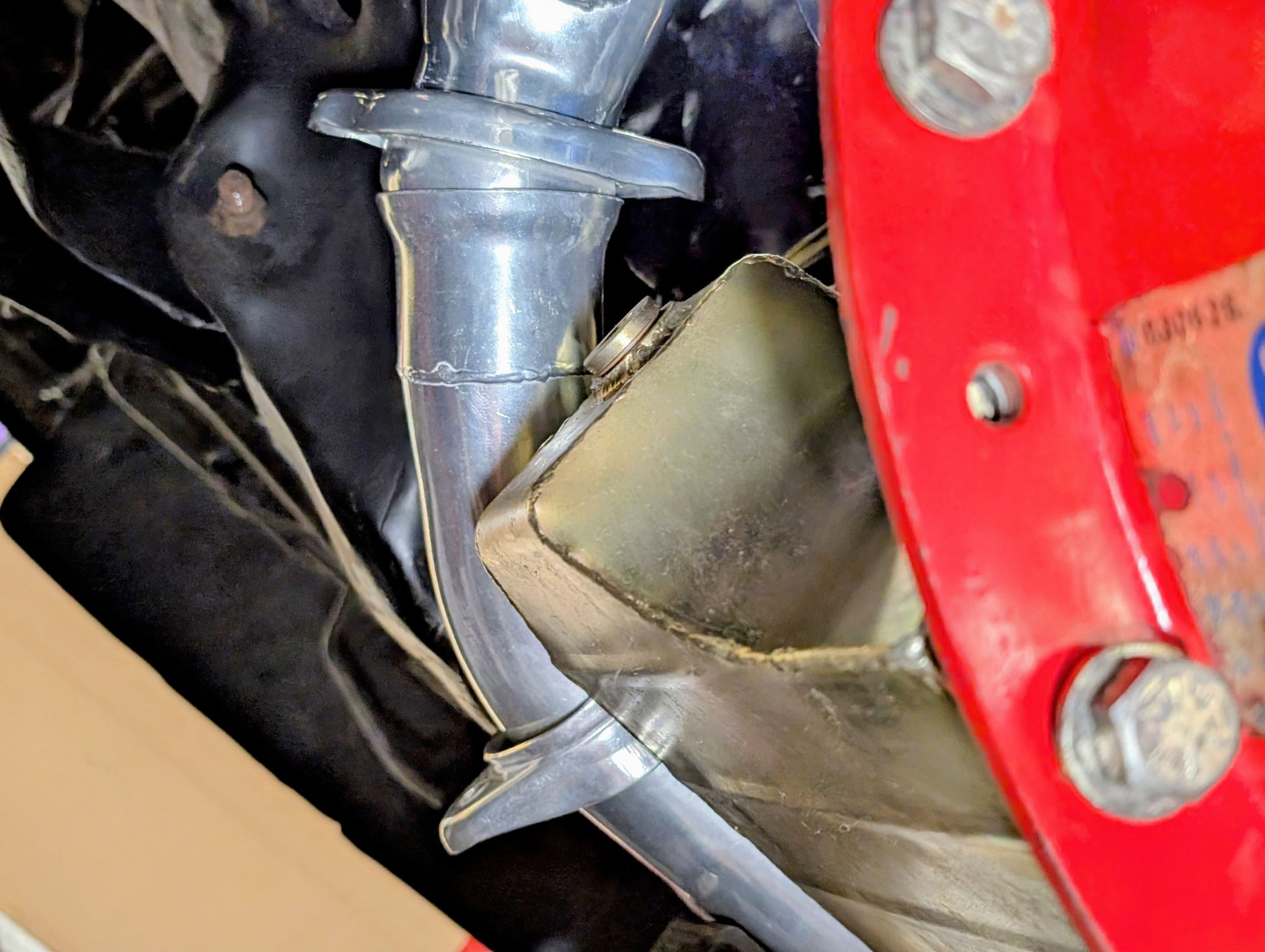

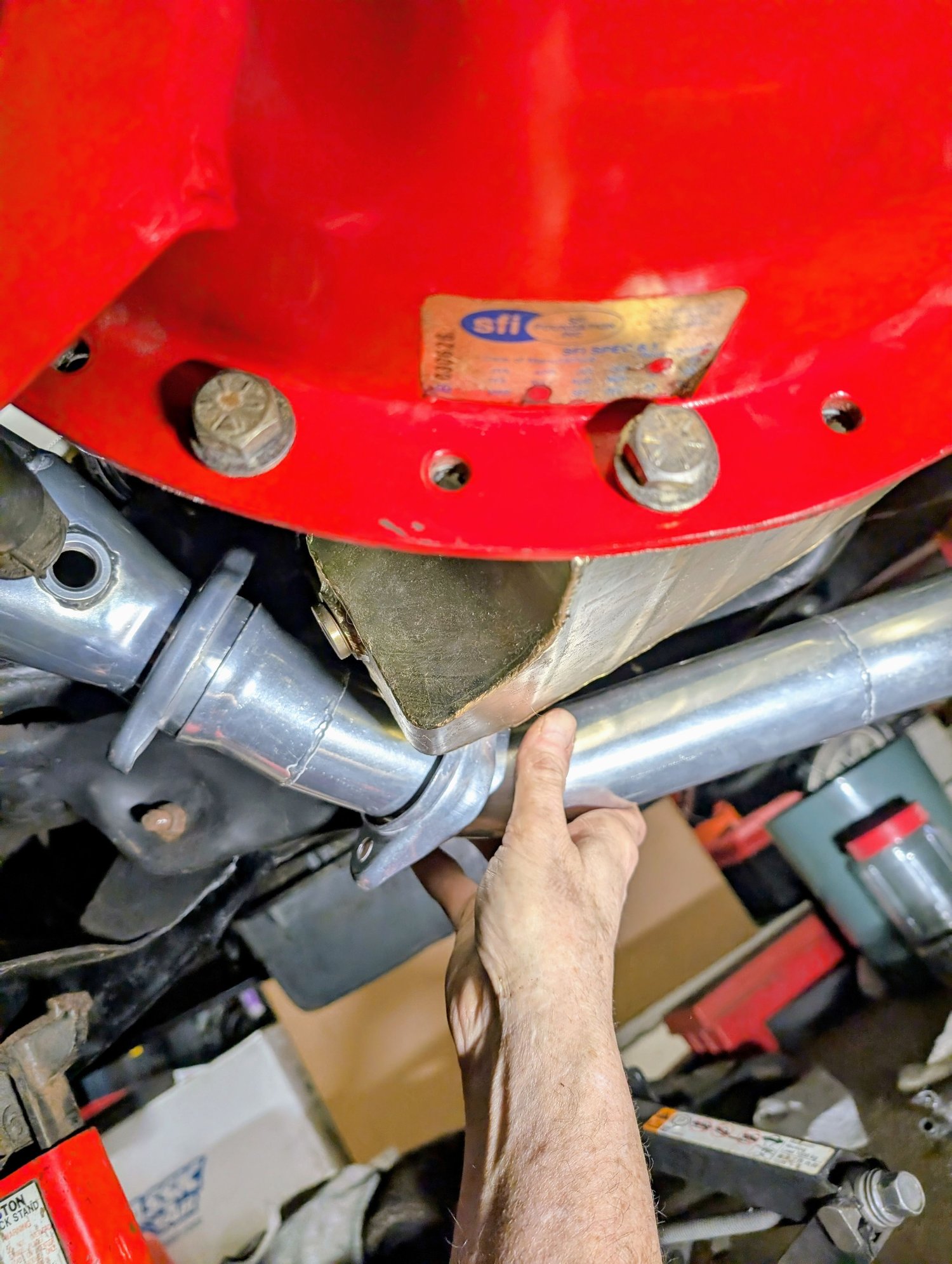

I figured as much.. the pan is totally clear , if i align pipe to header it hangs down 7-8" where it would meet ypipe , even with y pipe i am not sure it will seal. I guess i will have to slice it , get angle right and take it somewhere to be completed. nice stuff though , not sure what I will do with my new airtubes , don't see another 3rd gen in the procession, but someone will use them. sad to lose the real craftsmen in the general automotive circle , if it isnt built in China with a big margin we won't get it. Thanks for your contribution

Do you still have jigs? i mean , if i gotta pay somebody i would rather send it to you. i do believe you have retired , figured i would ask.my email dddsdinw@msn.com.Thanks!

Does it look like this when setting on the floor? (like this one)

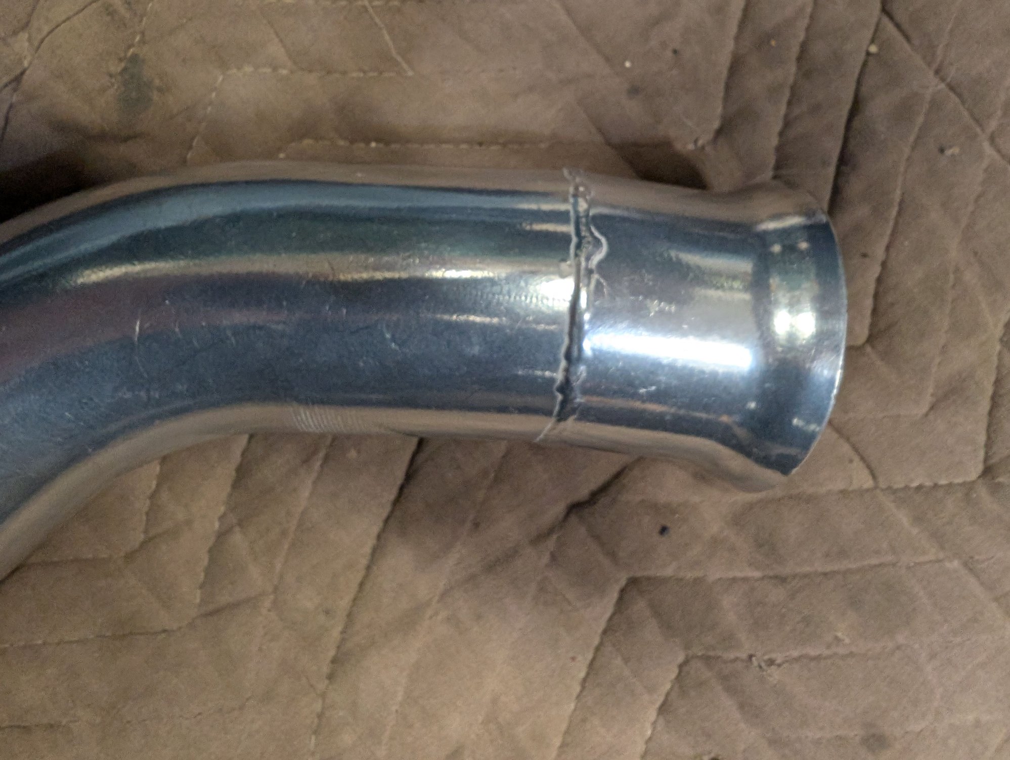

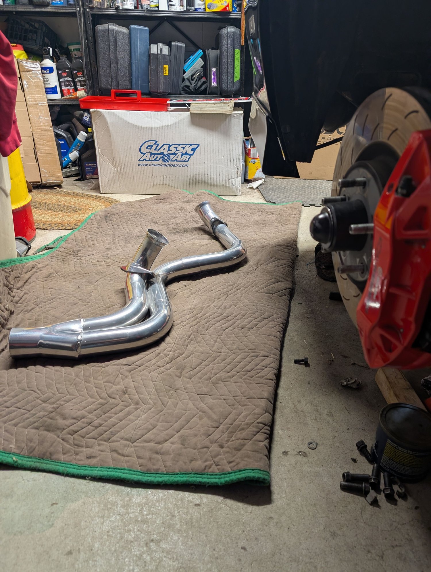

I had gotten a response from Don, placed pipe exactly level then checked angle in case he had anything to compare it to. No.relevance to anyone else I guess

Headpipes are 2 1/2" , y pipe outet 3"

For what it's worth,........ might want to double check the clamshells to be sure they are on the correct side just to be sure. I don't have part numbers handy,.. but you can see the difference by-eye.

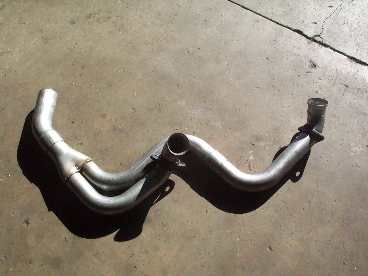

Here is one that fits a pan similar to yours,
it seems to fit just fine,
yours looks like one custom made.
It appears to have extra welds in the whole y-pipe.
I would be glad to put it in my jig to check fit ( I checked the angle on mine it's, not 45*)
if you wanted to send it to me.

This stuff has all been in box 17 years or so since we got the whole kit for 720 bucks. I think the angle ends up more like 32 degrees. I think I have decided that the easiest path is slice the pipe on a band saw,set angle and cut a pie slice from a donor pipe and have it tigged in, recoat pipe. I cant imagine how much it would cost to send that to wherever you or Don are, off my radar for a couple of weeks at this point between welding and the shop that does coating is an hour plus away no.time
