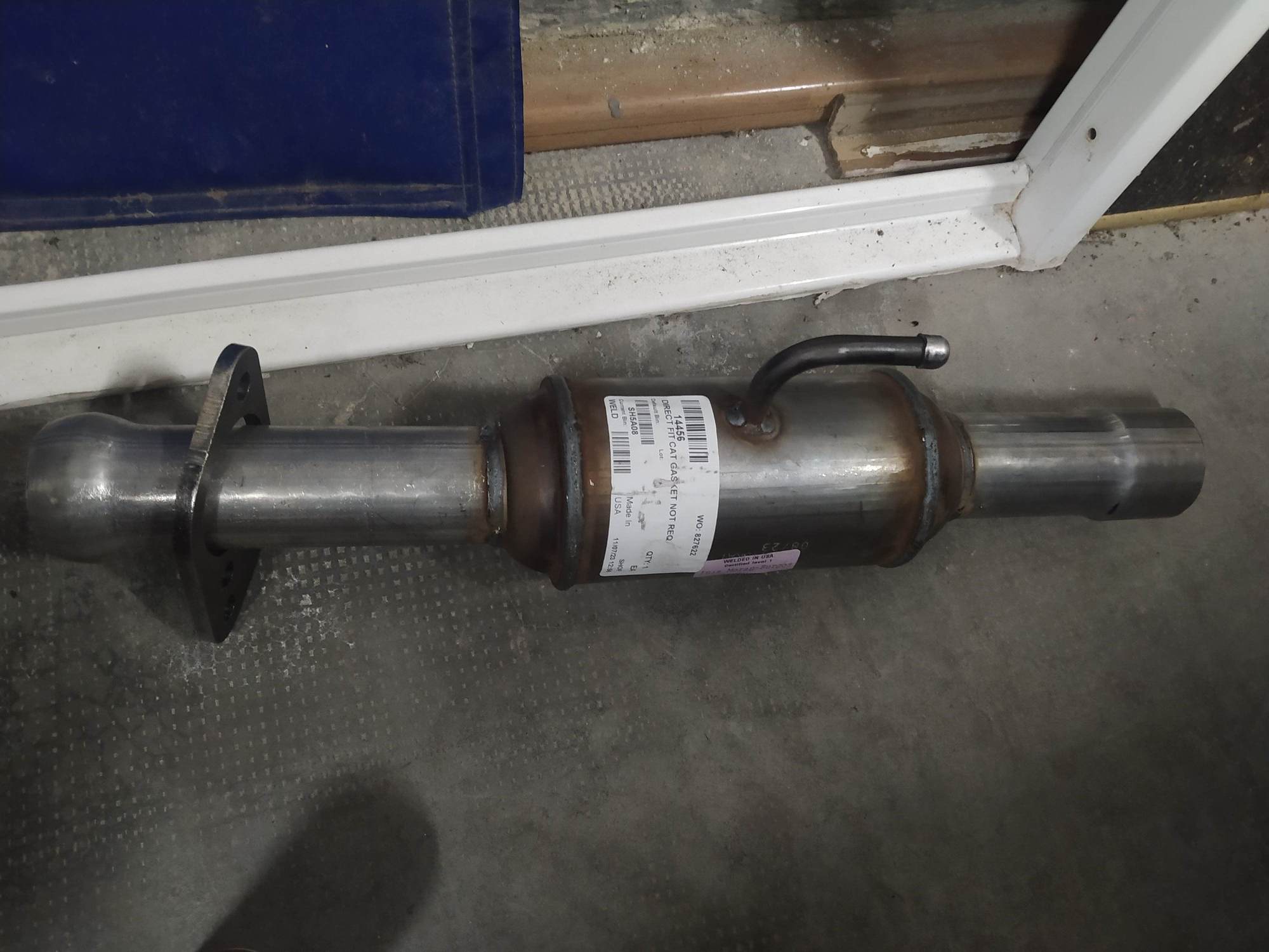

Hello. The smoke test gave me very high CO2, for that reason I changed the catalyst. When I took it out, I saw that it was empty inside. I put a photo of the catalyst I put in. Today I had the engine running for 3 minutes at 2000 rpm and from the catalyst to the muffler it was red. The catalyst has a small air outlet that I have left covered.
Maybe the new catalyst had a cover inside that I haven't removed?

Wow thats bright. I suspect you have a leaking or stuck injector cauing unburnt fuel in ther exhaust. I would not run it much before you figure out the issue. Could be a fire hazard and will ruin the cat.

I've seen really retarded (late) ignition timing cause some glowing in the exhaust, but never to the point where pretty much the whole exhaust is glowing.
I second Midas' post, it takes quite a bit of fuel to light an exhaust up like that, and that's what I think is happening too.
Have you checked the vacuum line connected to the top of the fuel pressure regulator for the presence of raw fuel yet?

Yeah, that's not good. Retarded timing and/or lots of excess unburned fuel would cause that. That's likely what killed the old converter and will kill this one in short order.

You’re not going to pass with an empty cat and whatever issues are going on with your motor. I would not take it for the test until you get it sorted out.
There are a lot shops here in the states that don’t know how to work on these cars given their age, I can imagine it’s more the case in Spain.
Your best bet is going to be to learn and do the work yourself. I’d probably start with a full tuneup (plugs/wires/cap/rotor), set ignition timing (will need a timing light) per spec and replace the fuel injectors. See where you are then. If the new car you just put on is still good after being overheated, then try to run it. If not, then replace it again, but only after getting the motor to run right and not have the exhaust get red hot.
