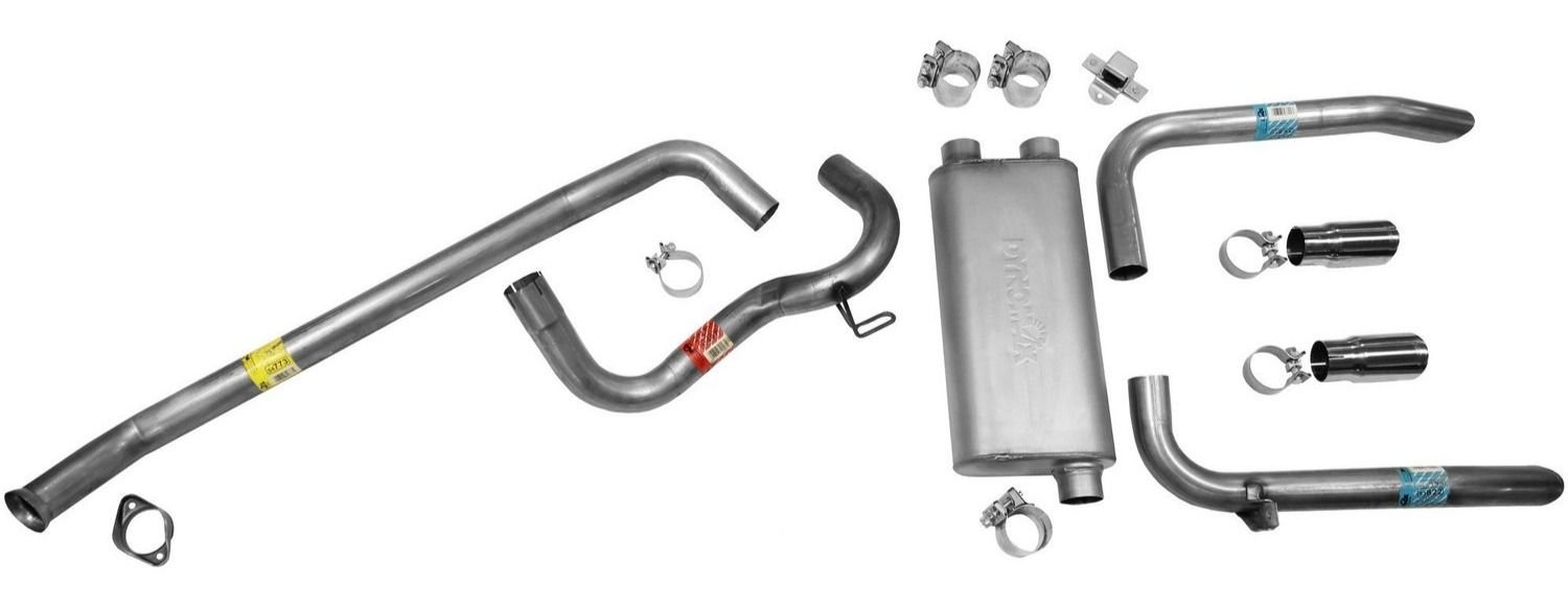

Here is something that he can buy. This is an all Stainless Steel exhaust system except for hangers and flanges.
Doug's Headers - 1982-92 Chevy Camaro/Pontiac Firebird Small Block 1 5/8" 304 Stainless Steel Shorty Headers – Pertronix
Casper's Electronics 103025 | 4 Wire Heated O2 Sensor Retrofit Kit for Early GM 1 Wire O2 Sensors | Summit Racing
This kit allows a new style heated oxygen sensor to be installed on a vehicle that originally came with a non-heated, 1 wire sensor. The heated oxygen sensors are more active and more responsive than the non-heated sensors and are also more resistant to contaminates such as lead.
Typical applications are late 1980's through early 1990's GM vehicles when aftermaret headers are used or a great choice when replacing the factory non-heated O2 sensors. Simple two-wire installation. Kit comes complete with 4-wire heated oxygen sensor and adapter harness.
Doug's Headers - 1982-92 Chevy Camaro/Pontiac Firebird Small Block 2.5" 409 Stainless Steel Y-Pipe – Pertronix
ARP 400-1211 ARP Stainless Steel Header Bolts | Summit Racing
ARP 400-1213 ARP Stainless Steel Collector Fasteners | Summit Racing
Permatex 77124 Permatex Nickel Anti-Seize Lubricant | Summit Racing
DYNOMAX 54773 - 2.5" Mandrel Bent 409 Stainless Steel - Under The Car Intermediate Pipe - Rock Auto
DYNOMAX 52497 - 2.5" Mandrel Bent 409 Stainless Steel - Over The Axel Intermediate Pipe - Rock Auto
CHERRY BOMB Salute SA2265 - 2.5" Inlet, Dual 2.5" Outlet 409 Stainless Steel Transverse Crossflow Muffler - Rock Auto
DYNOMAX 53821 - 2.5" Mandrel Bent 409 Stainless Steel Passenger Side Tailpipe - Rock Auto
DYNOMAX 53821 - 2.5" Mandrel Bent 409 Stainless Steel Driver Side Tailpipe - Rock Auto
WALKER 35245 - Automatic Transmission to Catalytic Convertor Loose Flange Exhaust System Hanger - Rock Auto
WALKER 35648 - Passenger Side Exhaust System Hanger Bracket for the Over the Axel Intermediate Pipe - Rock Auto
WALKER 35475 - Driver Side Tailpipe Exhaust System Hanger - Rock Auto
DYNOMAX 36438 - Band Clamp; Stainless Steel; 2.5" Pipe Diameter - Rock Auto x1
DYNOMAX 33226 - Mega-Clamp; Band, Lap Joint; Stainless Steel; 2.5" Pipe Diameter - Rock Auto x3
WALKER 31865 - 2 Bolt Loose Exhaust Flange for 2.5" Intermediate Pipe to Catalytic Convertor or Doug's D901 Y-pipe - Rock Auto
Optional Dress Up Exhaust Outlet Tips
DYNOMAX 36484 - 2.5" Inlet 3.0" Outlet Buffed and Polished 304 Stainless Steel Exhaust Tip- Rock Auto x2

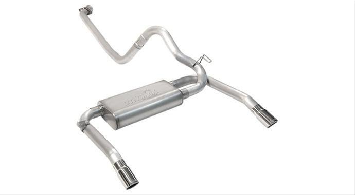

The exhaust system I speced out above is based off the DynoMax Ultra Flo Welded catback exhaust systems below for 2.8L & 3.1L V6 engines and low output 5.0L V8 engines. I would assume the LG4 carbed engine & the L03 TBI engine. I would assume the power gains claimed were for the 5.0L low output engines. The version at the top of the brochure uses a DynoMax Ultra Flo VT "Valve Technology" muffler and the one below it uses a DynoMax Ultra Flo Welded muffler. DynoMax doesn't make either of these catback exhaust systems anymore now, nor do they make the 409 SS Ultra Flo VT, 409 SS Ultra Flo Welded, or the 304 SS Ultra Flo Polished mufflers for our cars anymore. I substituted the Cherry Bomb Salute 409 SS welded "straight through" design muffler they make for our cars. It uses the same design and construction as the DynoMax Ultra Flo Welded muffler.
Ultraflo Welded
Ultra Flo Welded
Mock up of the Dyno Max Ultra Flo catback exhaust system
