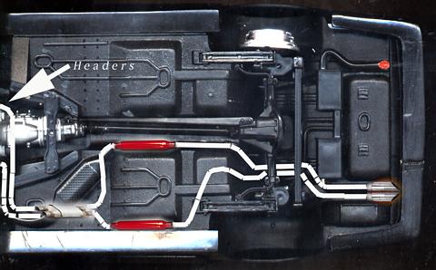

you should have done it like this so it wouldn't bottom out.

hey fiream , is that a cat right after the headers, of is that a muffler. Im asuming its a cat since theres not much space there.
Say........ That looks like the bottom of a model.....

Yes that was the bottom of a model, my father has over 300 different trans ams, from 67 to present.

thats hillarious about the model.... so killer, GREAT thinking, I was like HOLY SHEET!!!!! HOWD He Get It So HigH???
