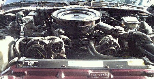

Here are some pics of mine. Just read the sig.
BTW. clearance is not a problem. I have NEVER scraped. Gotta love air shocks.
