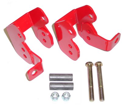

i made my as well.0 dollars and a few hours of my time. i made a set of weld ins but i plan on changing them into bolt ins.

Looks almost identical to the BMR bracket… but what is it indexing on to make sure that it’s at the right angle? Looks like it sticks out past the back of the stock bracket and somewhat overlaps…

they were made to just like the BMRs except i made mine better
the only thing that is locating the hole are the correct placment of the hole.
i plan on modifing these a bit like these
Attached Thumbnails Making custom LCA relocation brackets!!!!-c-winnt-profiles-ets549
