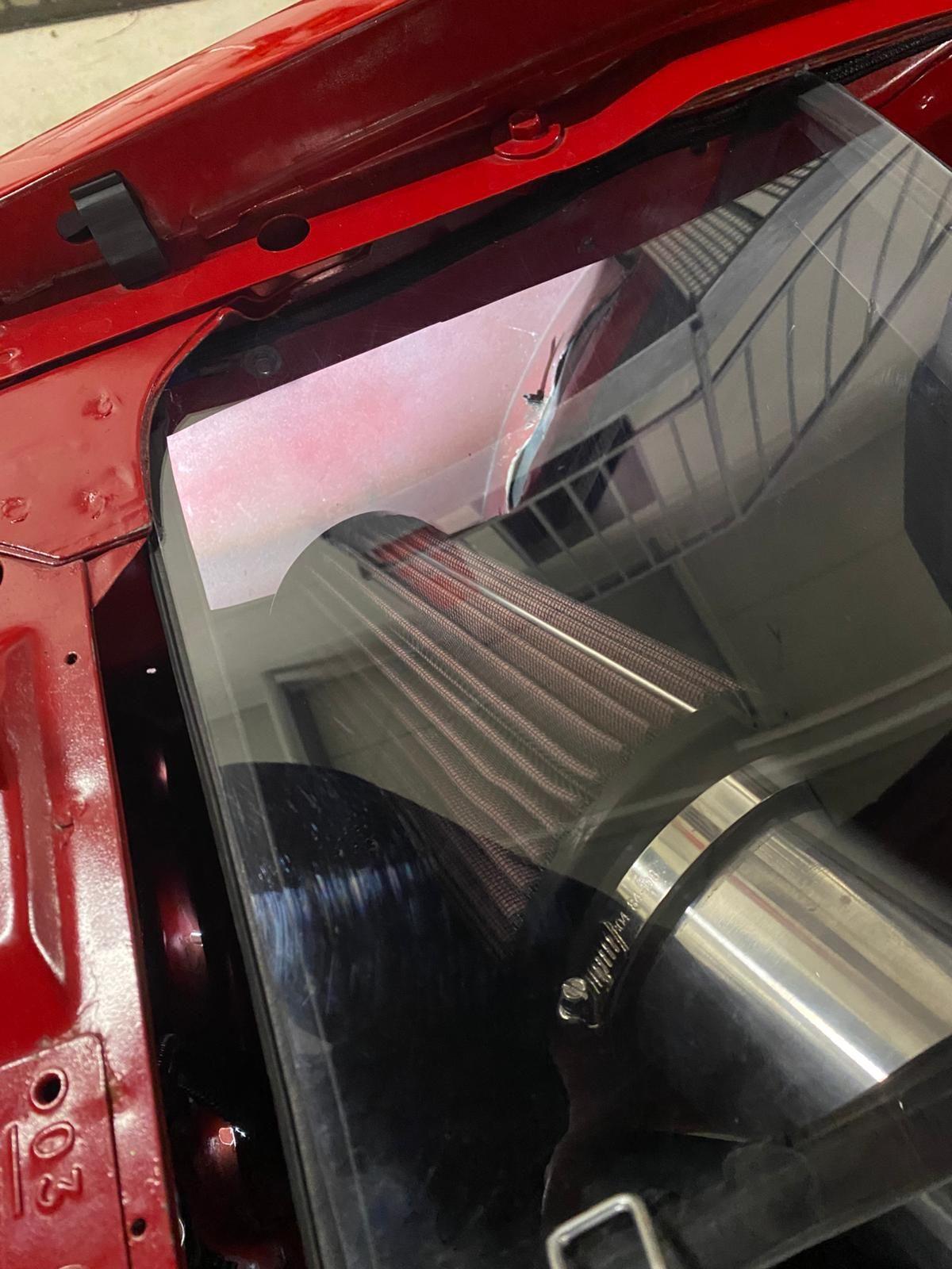

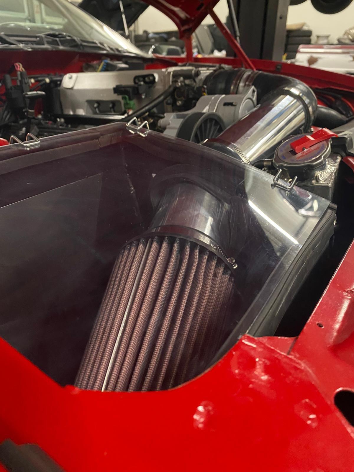

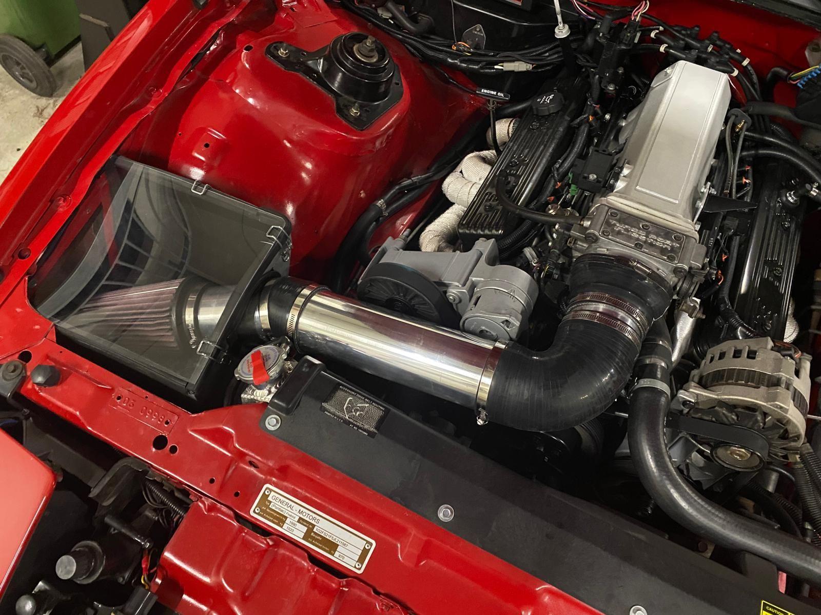

Completed my new cold air intake to adress the larger breathing capability.
Maybe its interesting for someone.
3,5“ piping, k&n filter, metal housing with plexi glas plate on top.
Gets isolated air coming from the fender (light shining through).
Was at 93kpa @4000rpm with factory air filter assembly, now its at 99kpa.

this looks awesome. How can I replicate this?

I want to make one of these cold air intakes as well. This will be for my LS427/570, Tremec T56 Magnum F swap project, 1987 IROC Z.
How about some construction details, Chris?
