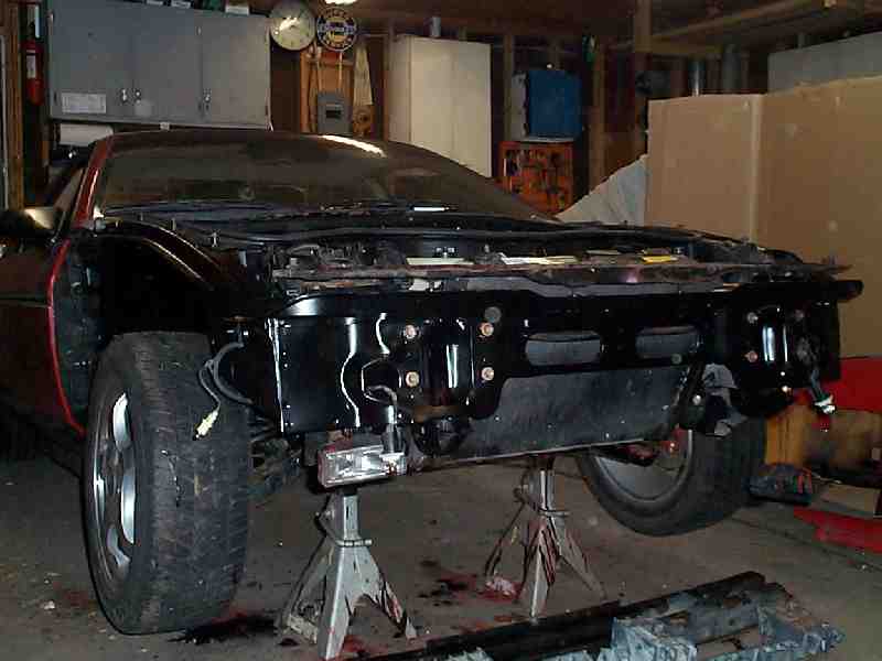

Ok, so I wanted to do something different with my Camaro, and I’m huge Corvette fan so I thought I’d reverse the way the hood opens so it tilts forward like the Vettes. I’ve never seen it done on one at a show and I was only able to find 3 online. One of them was a real hack job, he used what looked like a chandelier chain to hold the hood open. No one around me does stuff like that to their cars where I’m at. It’s all the usual Fast and Furious stuff - wings and fart cans and ugly body kits. Rarely you’ll run across someone who actually added the ***** to back up the looks.
In looking into how to do this it turns out that GM made a few cars in the late 80’s/early 90’s with a reversed hood besides the Corvette. The hinge I used was from an 85-90 Buick Electra. Park Avenues had them as well. I got the hinge from a U-Pull junkyard about an hour from me, and there are 2 more of these in a U-Pull about a half hour from me. It cost me all of $10 for the hinge and the springs. Total cost for everything including the hinge/springs, the drill bit and tap, and the steel bar ran just over $30. It turns out that it is almost the perfect width to fit across the core support on our cars, only being about 1-2” short from a perfect fit. I thought about cutting the center bar that connects the 2 sides and either welding in a section to make it longer, or cutting the bar out altogether. I ended up not going this route for 2 reasons: 1 – I wasn’t sure I could weld straight enough to widen it and have it line up properly, and 2 – With the weight of the hood, I didn’t want it to flex or twist from side to side.
Pics of the initial trial fit of the hinge. I will be using the frontmost fender bolt and mounting hole for 1 bolt on the hinge, and will have to fab a mount for the second bolt.
Sorry about the poor quality of the pics, my wife won’t let me take the good digital camera into the garage, something about flying sparks and tools. These were taken with my cell phone which doesn’t like anything but perfect, outdoors-on-a-sunny-day kind of lighting.
This is not meant to be an end-all, precise/exact set of directions on how to do this, it is just a chronicle of my experience with it. Use it as a guide, but if you screw your car up, don't blame me!
Attached Thumbnails Tilt/Reverse Hood-dsc00437.jpg   Tilt/Reverse Hood-dsc00438.jpg   Tilt/Reverse Hood-dsc00439.jpg

I dont think the bird hood is really much "thinner" per sae...but the area that goes around the pop up lights and that meets up with the nose just seems less sturdy. I dont have much wrench time with camaros though...so I guess Im talking alittle out of my knowledge range.
What I meant about mounting the hinges over the radiator... Where you have the hinges mounted now would be directly interferring with the firebird pop up headlight assemblys. Also...there isnt any hood in that spot due to the pop up cover. So you'd have to move the hinges inboard Ide think. Which would put them pretty close to the radiator. I guess you could move them in, build a structure, and have the hing assembly basically in the nose area. Youd have to extend the hinge brackets back to have a bigger spread so the hood doesnt go all wobbly when its up...but I guess its doable. Anything is with alittle fab and creativity.
The only other way I can think of would be completely custom hinges, based off the GM design, that mount back behind the pop ups, but still allow the hood to move far enough...which I think would still cause issues with the lights.
Now im interested in figuring this out. And actually...after looking again at both my pics and your pics...maybe the headlights wouldnt interfere as much as I thought....
J.
Just for a "craps and giggles" type of reference...here's a pic of my car showing the headlight area. The way the nose slopes down and all...it gets pretty tight under the hood up front.

Ok, I see what you mean now. I'm opposite you in that I don't have much wrench time on Firebirds. Pretty much all of it is radios, not underhood. I thought that the headlights were in the same place as Camaros, just with the popup motors instead of the recesses. I didn't realize that the front support structure was different between them. Mounting them closer to the radiator might be doable, I'd have to see a pic. I would just be worried about any structure interfering with the radiator fan or serp belt. It might be possible to take the original hinges and just reverse them and move them to the front of the engine bay. That was one of the first things I thought of when I was looking into this, but I think clearance issues kept me from doing it. It might be possible to weld in a section to the arms to make them longer.

Thanks for the pic. Looking at that, the only thing I think will interfere on the hinge is the stop. If you look at the middle pic in post #3, you can see where the hinge stop overhangs the front of the core support a bit. As long as that overhang does not hit the top of the light cover, I think it will be fine. Looking at you pic, I think there will be *just* enough room. There is a little lip on the hinge stop that could be removed to gain an additional 1/8-1/4" clearance. Then we are just back to the original question of the clearing the front of the hood.
