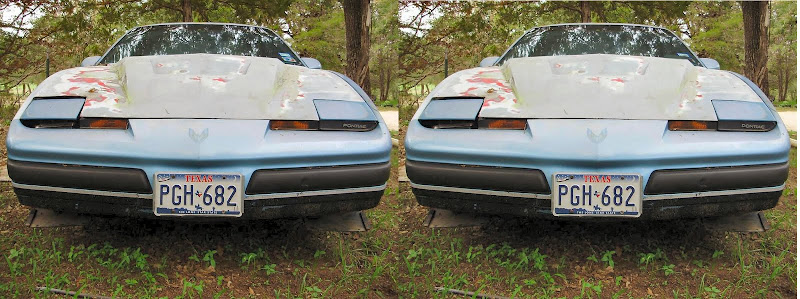

All the fab work is DONE! All I have left to do is grind, skim with filler, sand, and paint.....and a little hammer/dolly here and there.
I work in a sheet metal shop so I decided to go a different route with my bracing. I made the braces as a 90* angle with a 45* foot turned up on each side. They're 20 ga galvanized. None of the stock bracing that I cut out was used. It's real flimsy and it just wouldn't do what I wanted it to do. In the front of the hood between the extractor and the latch I welded in a plate of 20 ga paint grip steel to help it transition a little better and it actually added a good bit of bracing so that's where I decided to tie in the front to rear braces. This hood is SOLID. There is absoloutely NO flex/bend to it anymore like it was is stock form. I might have added around 4-5 lbs to it maybe but I could care less since this isn't a race car. I can still take it off the car and install it by myself (which I did about 5 times today making sure everything was still lining up right).
I ended up using the 14 ga perforated stainless steel with the 1/4" holes for the vent grilles since it's easier to weld and it just adds a little more rigidity to the entire structure.
Between the braces and the outer skin I put big globs of Liquid Nails for support where there is no metal on metal contact. It's very similar to what was used at the factory. I install alot of stainless sheetmetal on walls of commercial kitchens and I use Liquid Nails exclusively so I know that it will bond with the metal very well.
I still need to run a wire wheel over the welds to clean up all the slag but as of tonight here is what it looks like. I'll put it back on the car and start on the finish work tomorrow.

Unfortunately I haven't taken a pic of it on the car since I cut the vent in it. But, I am in the process skimming with filler and sanding at this very moment. I'm actually waiting on the filler to dry right now. The hood is currently sitting on saw horses in my driveway. I will get it on the car as soon as I finish smoothing it all out and take plenty of pics. That should be within a couple of days.
As far as the wedge that I cut out of it here is a rough sketch as to where and how I cut it. I cut it initially on the body line creases in the hood. Those are indicated by the two red lines going from the front to back on the hood. Then I cut the red line across the back of the hood. I measured in 3" from each cut at the rear of the hood and drew a line from there to the starting point of the original cut. That is marked by the blue lines. The raised section of the hood is 2" above it's stock location. All cuts except the rear cut were straight cuts. For the cut in the rear I made a gauge that followed the curve in the rear of the hood. I can't remember all of my measurements off the top of my head but I'll gather them up and post them if anyone is interested.

The Camaro guys aren't completely out of luck just yet. I have been given a 91 RS hood (gotta go pick it up) that I might modify in a similar fashion in the next few months, possibly this winter. If I do then I'll see about getting a company (maybe the one Stephen informed me about) to mass produce them in fiberglass.
Total out of pocket cost so far in this project:
flux core welding wire- 2 rolls @ $10 each
liquid nails (heavy duty)--- 4 tubes @ $2.50 each
scrap sheet metal from work--- $0 (FREEEEEBBBBIIIIEEEE)
Evercoat body filler --- 1 gallon @ $22
various sand paper/grinding wheels ----already on hand---$20 +/-
______________________________
$72.00 +/-
I have roughly 25-30 hours into it so far...maybe more, maybe less. I haven't really been keeping track of it. I've been working on it when I can or when I feel like it since it's been sooo HOT here this summer (over 60 consecutive 100* + days...that's with 75%+ humidity too desert boys).

The hood has been put on the back burner until I get my 91 all put back together and back on the road...which shouldn't be too long now since I laid the paint on it Sunday. I wasn't "feeling" it on my 91, which was the car that I basically built it for so I swapped it over to my 89 base model LSX project and to me it flows soooo much better with the squared off nose on the 89. Structurally it's done. I still have to sand the filler down smooth where I welded on the driver side of the raised section, and fill/sand the same part on the passenger side. That was taking a while because I am extremely **** and I make sure everything is perfect. This hood was riddled with tiny hail dings and that took a long, long time to smooth out and get perfect. This hood also had 3 different paint jobs on it and everywhere that I had bare metal exposed I've just shot some rattle can primer on to keep it from rusting.
Be assured though, it has been built, and now IT DOES EXIST!!! Here it is on my project 89 that I recently aquired:
Finishing up the body/paint work on my 91 has taken alot longer than I had anticipated. But, it's almost done. As soon as it is put back together and on the road again in the next couple of weeks I'll be back to work on finishing up the cosmetics on the hood so I can paint the 89.
....Oh, and for everyone that has good eyes the nose and the passenger fender are loosely on the car and the passenger headlight bucket is basically just sitting in there for the moment. Everything does line up perfectly.
Old Sep 22, 2009 | 04:22 PM
  #82
RED_DRAGON_85's Avatar
Joined: Jun 2008
Posts: 1,298
From: Norfolk VA
Car: 85 Camaro IROC
Engine: 5.7 TPI
Transmission: 700-R4
Axle/Gears: open rear, 3.42 gears
Re: The Japanese heat extractor build...for my bird
i want one for my IROC lol
that looks really good on that car.
you are right about the squared off nose looking better

Old Sep 22, 2009 | 06:48 PM
  #87
Stephen's Avatar
iTrader: (12)
Posts: 12,212
Likes: 13
Car: 87 GTA
Engine: L98
Originally Posted by racing geek
I think it would have looked better if the hood scoop was a little wider to better match the front bumper's lines. I know it's too late now, but if you (or anyone else) would make another one, I just think it would look better wider.
Just my $0.02
Still looks great though!
He "simply" cut long the stock creases & raised the center section up. To maintain the width after being raised, the center section would have to be widened.
Not that I don't agree with you...I think straight up walls would look better too, but that is the way the stock pieces turn out.
Old Sep 22, 2009 | 11:09 PM
  #88
83 Crossfire TA's Avatar
Joined: Jun 2001
Posts: 8,028
Likes: 93
From: DC Metro Area
Looks incredible... good work.
Can you get a few pictures from the side (high and low angles) to get some impression of how where you started and stopped the scoop look as well as following the contour of the back of the hood for the back of the scoop (when I imagined doing it I imagined it being straight across the back like roughly a 2x as wide formula scoop, which is straight across the back)?
Old Sep 22, 2009 | 11:28 PM
  #89
Stephen's Avatar
iTrader: (12)
Posts: 12,212
Likes: 13
Car: 87 GTA
Engine: L98
Read the very first post of this thread, which shows the back side of the scoop, not the bottom.
Old Sep 22, 2009 | 11:47 PM
  #90
Joined: Jun 2001
Posts: 8,028
Likes: 93
From: DC Metro Area
to each his own, but if you want straight up walls just get one of the generic cowl hoods and be done with it.
I would have followed the lines of the hood slightly differently, probably would have taken some tape and laid some straight lines from the signal openings of the hood to the back in a straight line which I believe would put the inside cut very close to where his outside cut was and then matched that line with the outside line of the heat extractor opening, just to make the lines work a little better for my eyes (though with the contours of the hood, I might do something different in person then I would with pictures), and then from a function perspective, I would have left a little lip around the heat extractor; very little air deflection would make a big difference in airflow.
FYRCHKN's orginal is on the left, what I'm getting at is photochopped on the right (I know, it's subtle):
Again, I don't know what I would do with the back of the hood, which is why I'm asking for some more pictures so I can work that out... I'm hoping that what i like following the contour of the back of the hood, but suspect that what I really would want to do would not be compatible with doing it out of one hood... which is to extend the thing all the way past the original hoodline, sort of climbing the windshield with the back of the scoop like some cowl and prostock hoods.
If I had a flat hood I would do it right now, I'm actually tempted to take my TA hood, fix it's dent in the front/middle and then fill the center vents and try it, but I'm a bit worried that the patches will result in a funny bend at the front of the hood
Old Sep 23, 2009 | 12:00 AM
  #91
Stephen's Avatar
iTrader: (12)
Posts: 12,212
Likes: 13
Car: 87 GTA
Engine: L98
You completely misunderstood what I meant by "straight up".
Still following the same lines, but straight UP, not back, walls of the new cowl scoop.
What he did, was basically what I Photoshopped last year, then added the Japanese-style extraction reverse scoop to it.
https://www.thirdgen.org/forums/body...loed-hood.html

Old Sep 23, 2009 | 05:43 PM
  #94
FYRCHKN's Avatar
Joined: Jan 2007
Posts: 1,002
Likes: 12
From: Bastrop, TX
Car: 1988 SC Convertible
Engine: LT-1
Axle/Gears: 3.23 posi w/PBR's
t
The original cut was on the body lines on the hood. The red lines were my initial cuts. The blue lines are where I cut to give the top part some taper. The bottoms of the side pieces of the cowl are welded in on the original cut...right where the body line creases were.
I modded the hood while it was on my 91, so I didn't have the turn signals to go off of.
Here's some pictures of the back of the hood. My original idea was to basically have two "power bulge" type openings, one on each side of the hood.
The rear opening is 6", IIRC from the rear edge of the hood. It follows the curve of the rear of the hood exactly. The rear opening of the cowl is slightly angled towards the front of the car, very similar to the stock Formula bulge.
The raised center section of the hood is only 1 1/2" above stock, but the way that I cut the sides wider at the rear it makes it look taller.
I see what you're saying about making the top of the raised section following the lines on the nose of the car, but I did it where the bottom of it does. It's really hard to tell in the pictures that I have at the moment since there are so many different colored spots all over it and that distorts the lines. Once it's a solid color it will be much more defined.
Old Sep 23, 2009 | 06:24 PM
  #95
Joined: Jun 2008
Posts: 1,298
From: Norfolk VA
Car: 85 Camaro IROC
Engine: 5.7 TPI
is there a reason you didnt bring the cowl back to the back of the hood like a typical cowl hood would be?
just curious
Old Sep 23, 2009 | 07:13 PM
  #96
FYRCHKN's Avatar
Joined: Jan 2007
Posts: 1,002
Likes: 12
From: Bastrop, TX
Engine: LT-1
just curious
Yeah, I was kinda going for the IMSA feel, and extending it through the rear of the hood would have been a major PITA. There would have been some very extensive modifications that I really didn't feel like dealing with. Trying to deal with the seams on the edges of the hood is not any kind of fun.
