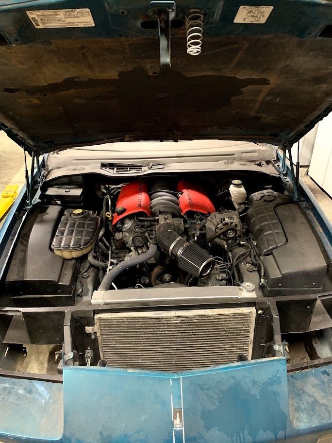

Re: a third gen, a Z06, and a long winter
I apologize for the LONG delay. . .you know how life goes. . .
move 500 miles, start a new company, raise a family.
I slacked off and let the website go away. I'll see if I can't locate the images and put them up somewhere.
Excuses aside here's where it sits at the new place. Garage is in utter chaos and I have a few other projects to get finished in front of it (work and family related. . .not much fun car stuff). All the hard work is done. I just need to put in the wire harness and modify for length in a few places, drop the motor back in, finish the turbo cold side plumbing, and all the little things involved with making it run and drive.

No apologies necessary, priorities first.Is that a 3rd gen bumper support in the background (on the wall)?
Old Aug 8, 2016 | 04:14 PM
  #323
marolf101x's Avatar
Joined: Jul 2009
Posts: 125
Likes: 9
From: Iowa
yes, that is the bumper support for the 3rd gen.
I had to fabricate one as I changed the headlights, radiator and added an intercooler.

Here's an image of the aluminum adapter I made to make the Vette ABS work. Just took apart a junk C5 bearing, removed the sensor, put it in this adapter.
The reluctor ring is pressed on the axle, and IIRC it came from a Mustang.
Here's what it looks like now. Not pretty, but I love the "that looks like a crappy old car" appearance.
Engine bay before I had the headlights and everything in place.
Side shot of engine bay. You can kind of see how far set back the engine is.
ZO6 seats, floor, dash, etc. As well as the wheel tub covers I 3D printed then textured with paint.
Better shot of the hoop and the dash. The trans tunnel is still not covered. We may 3D print some parts to make the dash flow into a console and fit the tunnel.

Thanks for the pictures, you did great work! how did you 3d print the wheel tubs?

I should clarify. . .I printed the wheel tub plastic covers. The actual wheel tubs were purchased from Rural King in Southern Indiana and were meant for trailer wheel covers.
I scanned the interior with both an iPhone and a NextEngine 3D scanner (neither of which were very good compared to modern 3D scanners), then drew the wheel covers in CAD (I use Fusion 360 currently).
I printed them on a Prusa i3 clone in sections, glued them together, laid fiberglass over both sides, sanded till smooth, then spray painted with texture spray paint.
