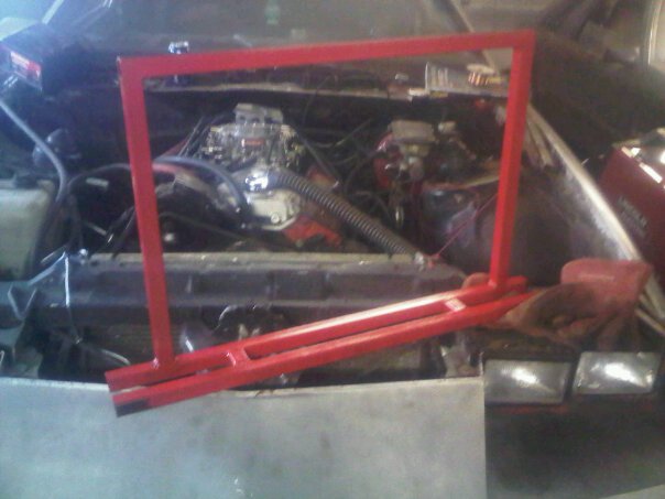

i replaced mine, and to remove mine i used a chizzle and a grinder, cleaned up real good even for a rusted ontario car.... heres mine, it was right solid, i had two 8 inch arms that attched to the bottom of the frame, i dont have it anymore as that went to scrap with the car (way to rusty and found exact same car but no rust for under 500 no brainer)
