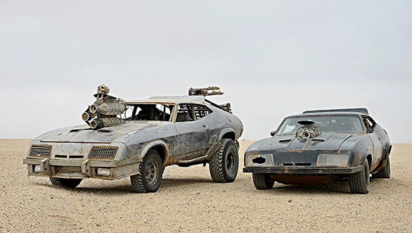

DIRTYDEEDS269,
I have no idea what "deathrace" is; but I remember mad max & the "last of the v8 interceptors" lol.
To pull off the mad max v8 interceptor look with your RS, you will really need to focus on the paint job & body work. The paint job would need to be half satin black/half gloss black. Study the pictures of the interceptor below. Notice how the fender flares/rear quarter-panel/front & rear spoilers are satin black. If you can get the satin black areas to match the 3rd gen body lines then it could look decent.
You will also need some black D-window style American Racing wheels. They are the only wheels that I know of that look similar to the interceptor wheels; but still bolt on to a 3rd gen without modification...
Oh and by the way, prepare your flame suit. lol

I love the interceptor. Love it.

Something like this ?
Death race style Chevy Camaro

I thought of something similar. After I was mostly finished with my current 3rd gen, I though of buying a cheap "beyond hope" beat up third gen and going to town with it. Stuff like 4th gen rear, with 3rd gen wheels with truck tires, and maybe cut/ hammer the wheel wheel to fit. Grind the paint down and let it rust. Use lots of scrap metal to make it differnt.
Btw Mad Max interceptor evolution....
[img][/img]
