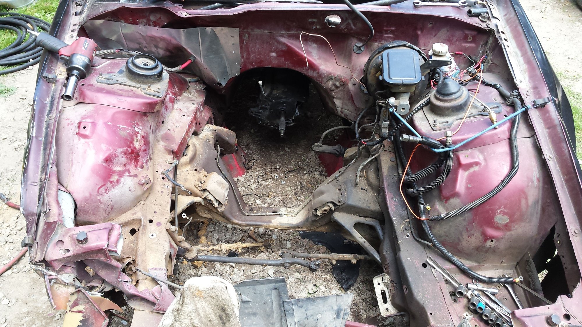

Im not really sure where to start, but here we go. Ever since the first time I went to a dirt track race, I always wanted to be able to do it. It looked like fun, win or lose. The track that I have went to since high school just recently started a pure stock class. Looking at the way they had their rules, compared to some other track's, I figured now was my chance to build a car.
Since this was a new class to the track, getting a race ready car wasnt an option. Other tracks limit too much IMO to pure stock class, I.E. automatic only, limiting engine choices to only what was available in that year/model, and not allowing EFI. This pratically makes a full field of 70s camaros and in turn makes a race ready car fairly expensive. I spoke with the track owner and tech man about their pure stock class. Basically they wanted to add an enty level v8 class and by using different engine rules and allowing EFI, a lot of cars in the junkyard can be raced. 2014 they ran 6 races with the new divison and had a fairly good car count for it. Including some third generation camaros that were competetive.
I started looking at different vehicles to build, late 70s nova, 80s G body, etc. Came across a good deal on a 91 RS 305 5 speed that I couldnt pass up. The interior had been hacked, but it ran good and had enough good parts on it that I could easily change my mind and part the car out and make money on. Some of the good parts were sold, others will find their way on to my 88. Win win situation.
Now here is the downside to the entire situation. Even though I have been going to dirt races for years, I know very little about how to build one or make it handle. I have my dad and two real good friends helping me with it, but none of us have even been in the pits before. Never took a lap, so this might get real interesting. We all have always wanted to do it and talked about doing it, I finally decided to stop talking and start doing. Trial by fire. (well hopefully not ever by fire!)
I figured I might as well add pictures and make a build thread. I would appreciate any feedback good or bad. Any tips would be greatly appreciated, like I said we have no experience with building a racecar or getting one to handle. We dont have a lot of time to work on the car, so the progress will be slow. Also are trying to keep a fairly reasonable budget.

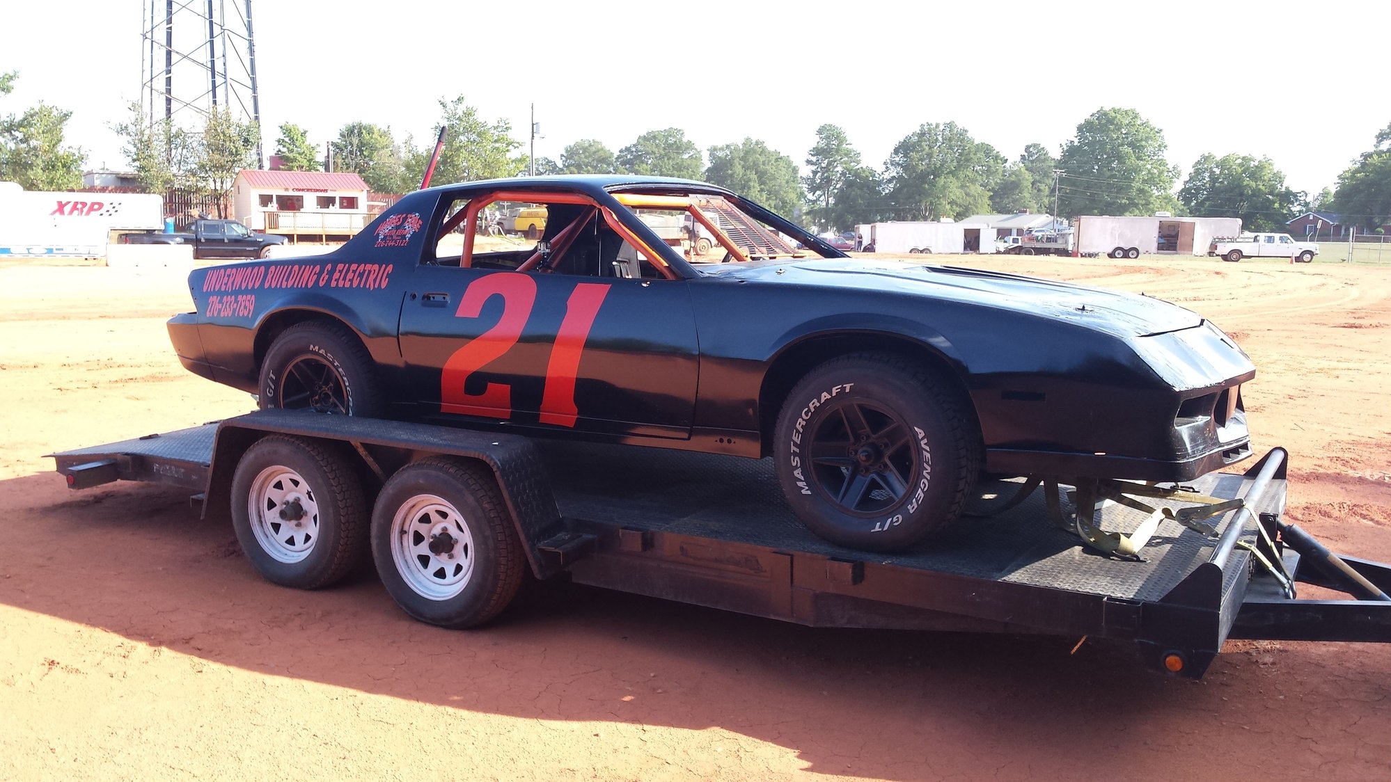

First race was saturday night. Track was perfect. I used hotlaps to ease my nerves and start pushing the car alitte more.
Not sure exactly what they used for our lineup, but I started inside row 1. 6 cars total. Fell back to fourth fairly quick. I kept getting more and more comfortable with the car and was able to push it harder and harder. Third place guy busted a radiator, so I was in 3rd in a single file restart with about 5 to go. Being directly behind the top two I pushed the car harder and harder and was amazed at how good it done. The little 305 was pulling right with them in the straights, and I was able to see where I was loosing time. I was letting out too early going into the turns.
With 3 to go going into turn 1, the car behind me had a run on the inside, I didnt see her and combining her pushing up some and me coming down some she caught me in the door. We seperated coming out of turn 2 and remained green. For some reason I couldnt get the car back into second gear. Had to get going down the backstretch in third.
Getting hit though was probably the best thing to happen all night for me driving wise. Those last two laps, I was pushing the car much harder and I was running a higher line. According to the lap times my crew as taking, I was running just a little off the leaders.
I ended up fourth and got to get out on the front stretch and interview. It was a great ending for the first night out.
Felt a lot more comfortable in the car and with that experience I am more confident. Cant wait to do it again. Got to check the car over real good this week. Need to see what happened with second gear. Maybe it was nothing, Im not sure, but need to check. Might have just been me. First, third, and reverse is fine. I dont see how the hit we got would have affected second.
Car did get a little hot at the end. Honestly Im not sure how hot it was when I was running, I wasnt focused on that, but when we pulled in on the front and shut it off it was at 230. Not hot enough to hurt anything, but hotter then I want. Air dam is in place. I read in some other places that may have to slow the water pump down to prevent cavitating. Might grab a set of underdrive pulleys and see how that works.
Awesome time. Even though I was fourth out of 6, it meant a lot.

Still have a few decals I need to get cut and put on, but here she is before loading up saturday.
Aint the prettiest thing, but it wont be at end of season anyways. Atleast it doesnt look like junk like some do.

Need to find the time to cut about a 1/4 coil off the front and maybe rear to get it to sit down alittle. Not sure yet.
Probably going to black out the wheels. Any opinions on that?

Ha, giant 3rd gens in "mini". I like it.

Can you put plexiglass for the windshield and even finish up the back with sheet metal? To make it more
Aerodynamic ?? Or is that against the rules.

For me, no on the windshield. But yes on the decklid. I had planned on putting the stock decklid and spoiler on, but uncertain on that right now. For one, I don't have a ton of time, two we are already easily over the weight limit without obvious cheap and easy ways of cutting more. Pure sheet metal wouldn't be very heavy, but the factory decklid would look better.
At this point, it aint what is holding us back. But it is something that might get done down the road as the build progresses.
My cousin just bought an 83 5 speed 302 mustang to build for the same class. The cage kit comes in tomorrow. Hopefully will have his on the track by the end of June. His will be painted similar. Black car with a ford blue cage and numbering. I have already started joking with him since he was worried about the 302 keeping up. I told him a lot of mustang guys would cry if they heard that a lowly 305, GMs junk engine, would outrun ford's beloved 302. Its going to be fun and I think will help the class.

Well for anybody curious, second season is about to get under way. Putting a fuel cell in the car now. Well, the second car. I out ran my experience in the first one. I'll post pictures in a bit. In short, I cut a tire down and didnt realize it. Felt completely different then on asphalt and I didnt recogonize it. Needless to say it didnt turn going into turn 3 on the big half mile. Was actually pretty lucky, car didnt flip and I wasnt hurt. Bought a hans the week after though! Should have before.
New car is an 84 z28 that I parted out years ago. Swapped almost everything from the 91 to the 84 and was back on track last august with the new car. Im hooked. Ive got a lot of learning to do, but its been a blast.
Pics in a bit.

That's the thing about running unibody street-based cars in racing: they're tough to bend back when you crash 'em hard.

Yep! Guy that was there that night looked at it and said, "I think that will pull out" Either he didn't look too good or didn't realize it was a unibody. But honestly, I hit so hard a frame car would have been rough too. It buckled the floor pan all the way across the car. Not sure if a framed car would have absorbed as much of the impact either. That may have been another reason I wasn't hurt. I always heard those big 1/2 miles were hard on motors and that if you ever wrecked the chances of totaling one was higher. Well I didn't mess around, when I wreck I total them lol. I was impressed at the wrecker crew. Put it right on the trailer.
Fun though aint it! Good thing is they are cheap. But when this car is gone, I'll probably move up to a metric chassis. This one will get me some seat time if I don't overdrive my experience again.
