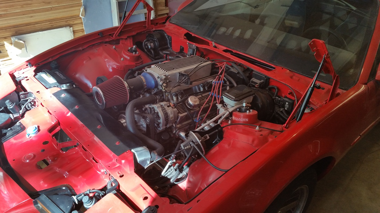

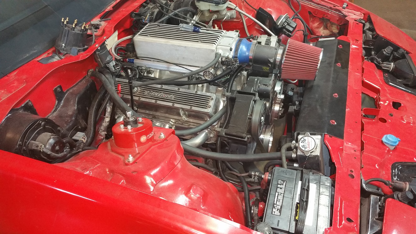

Hi Guys,
I'm going to stop working on the Firebird for the summer and just thought I would post a few pictures of my latest progress...
-Installed 4th gen battery mount/radiator overflow tank
-Installed 4th gen windshield washer (see blue cap in pic)
-Made a new lower-radiator support so Champion radiator to fit
-Made a simply radiator hold-down with electric fan mounts
-Made a non-AC fan blower mount/cover
-Relocated battery and associated wiring to passenger side
-Added an aftermarket transmission cooler
-Added 36# Bosch 3 injectors
-Removed factory steering shaft and replaced with one from an S10
-Covered factory overflow & windshield washer tank holes
-Painted engine bay, bolts, etc
-Made a true dual, 3" exhaust
-Replaced entire suspension, springs, steering (except steering column) and steering box
-Started tuning and got her to idle pretty good. More tuning next summer
*Note - the cone air filter is only temporary until I fab up something. Also, the driver side muffler has a slight tilt i need to fix.
Previous updates, including engine details, are in my signature.
This project was my first time using fiberglass and welding, so have pity on my limited skills
Thanks guys!
