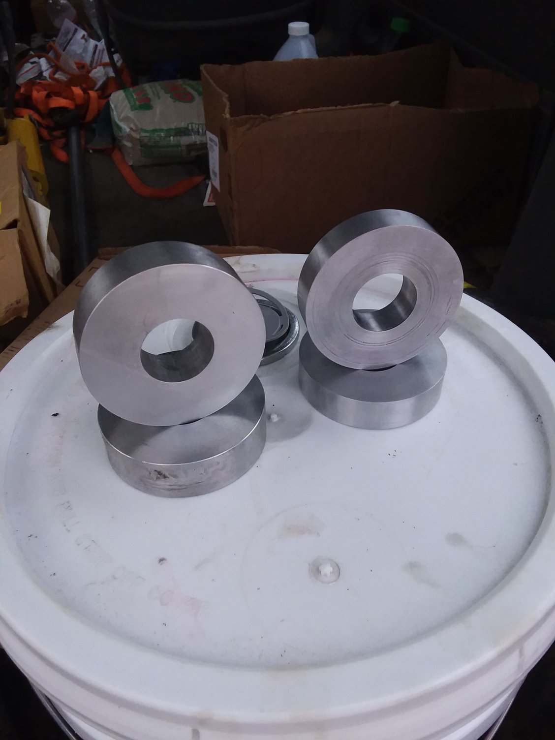

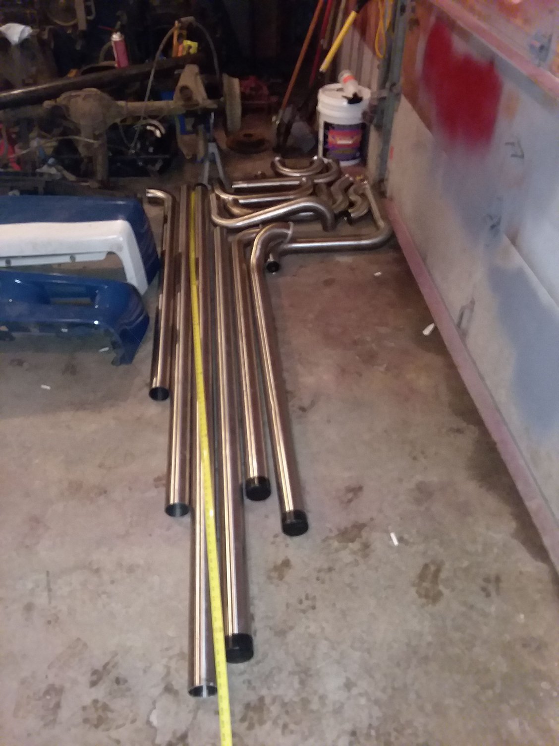

I've decided to put a 8.8 in my z. I've done a boatload of research on the matter tho I still have a few questions regarding total width. Axle flange to axle flange. I'm planning on running ls1 brakes in the rear. My question is, does it make sense to make it the same width as my 10 bolt, or would it make sense to have it a little narrower to allow for a wider tire? I was planning on calling strange or moser as I'm sure they have plenty info on it. Also am ordering axles so I'd need to call regardless. But i thought I'd start here. Some pretty knowledgeable guys here, granny, blackbird, etc.
Anyways, my plan is to chop tubes as you will see in pics, machine down some adapters that will be pressed in and also be plug welded, and weld strange H1143 housing ends on.
The housing ends reminded me of another question, what bearing style? I've seen a few different styles. Ones a wet style with seal on outside, the other is sealed with seal on inside. Also, do I need a backing plate to hold bearing in or will the ls1 abutment bracket, parking brake deal suffice.
I'm also making a panhard bar and torque arm, both adjustable. 1.250 dom with hime joints, and a del-sphere going on torque arm.
Today my pappy and I machined pucks for an alignment jig for centering the housing ends on.
Any tips, advice is much appreciated.
Dan
These were turned down from 3.25 aluminum to act as dummy bearings used to center housing ends with carrier bearings. Using 1.25 1018 cold rolled for my bar.
These will be turned down leaving .25 in the middle as a shoulder and something to weld to. May go .5 still debating. But these will be pressed in and plug welded.

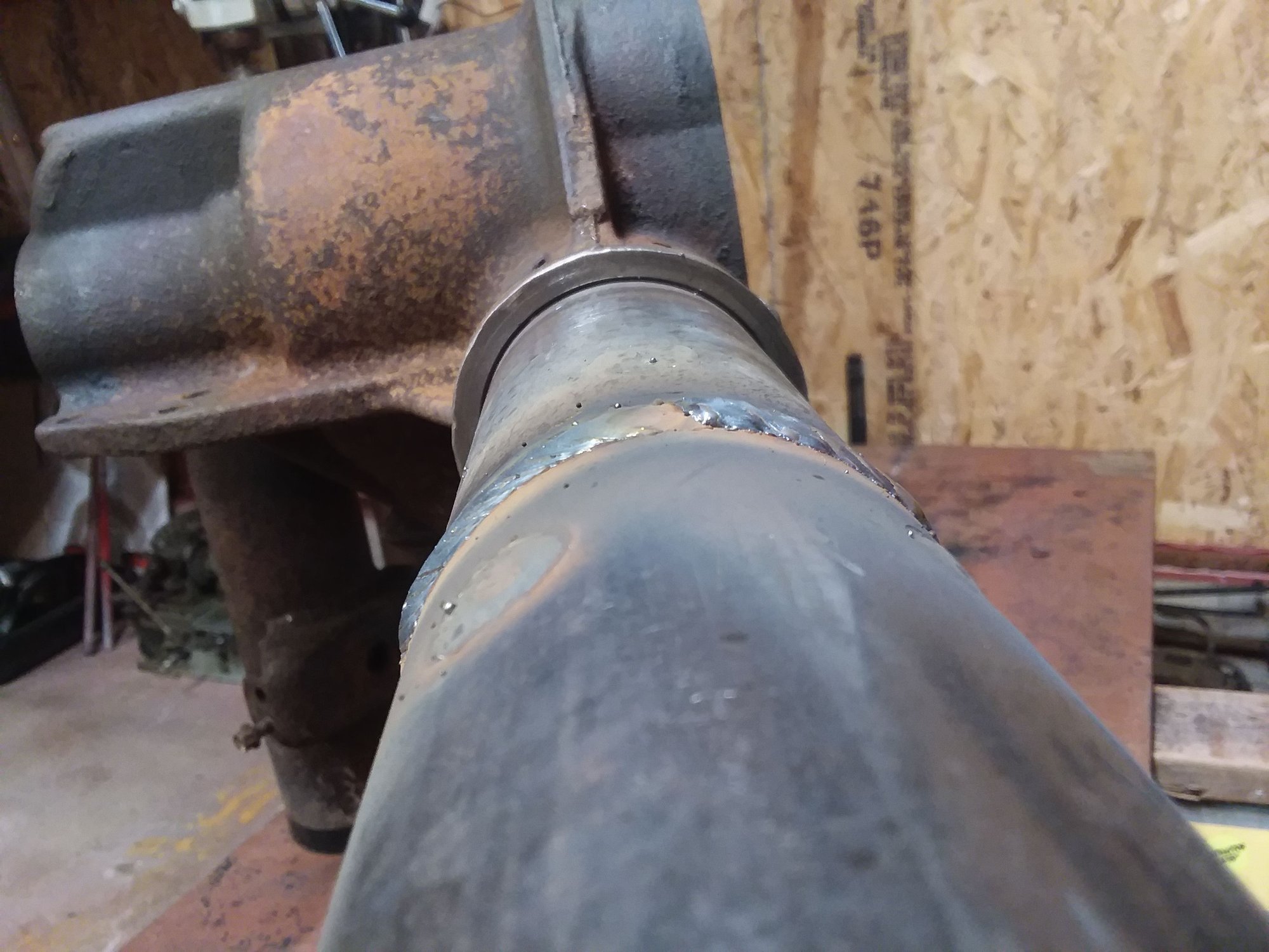

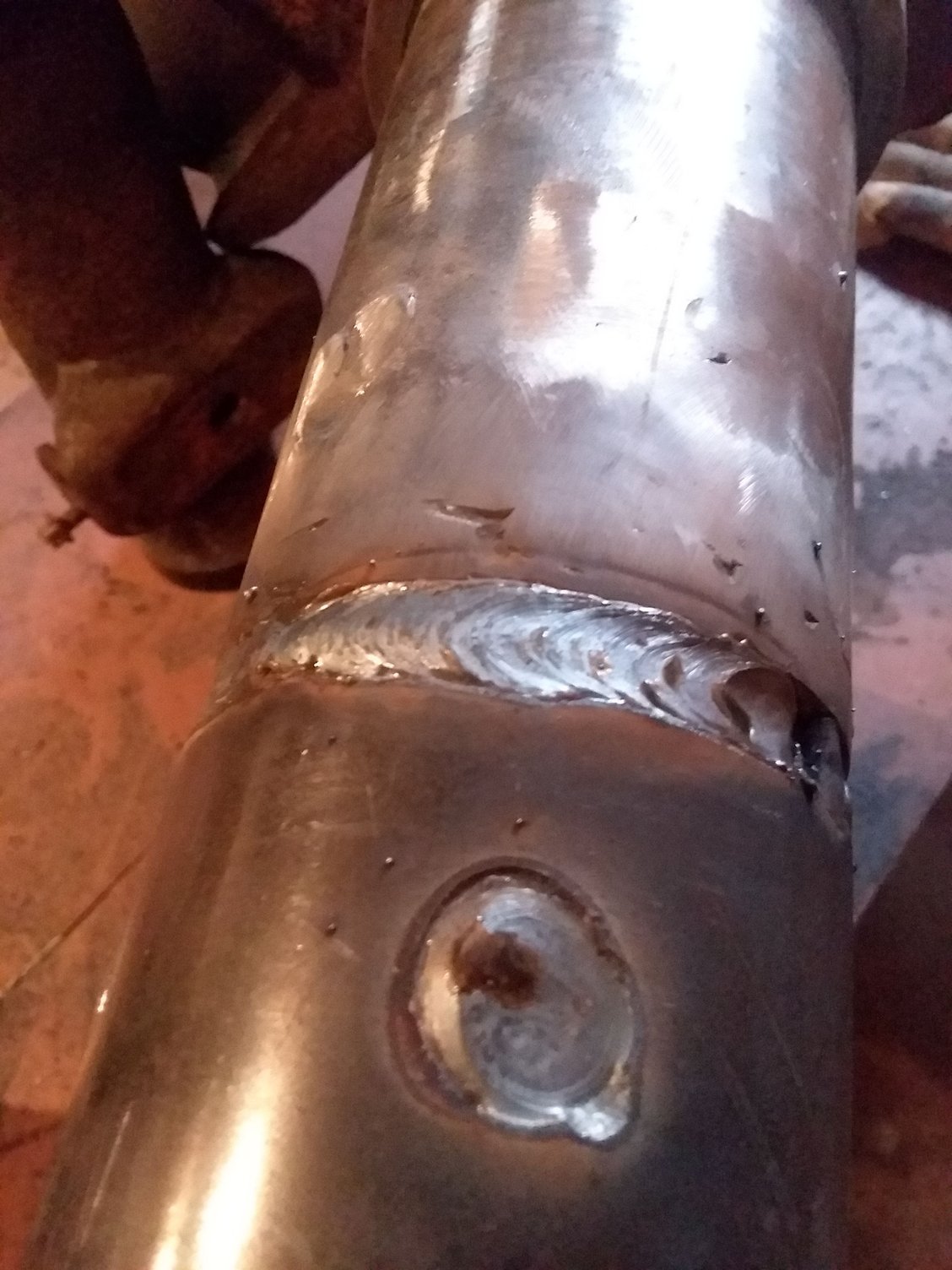

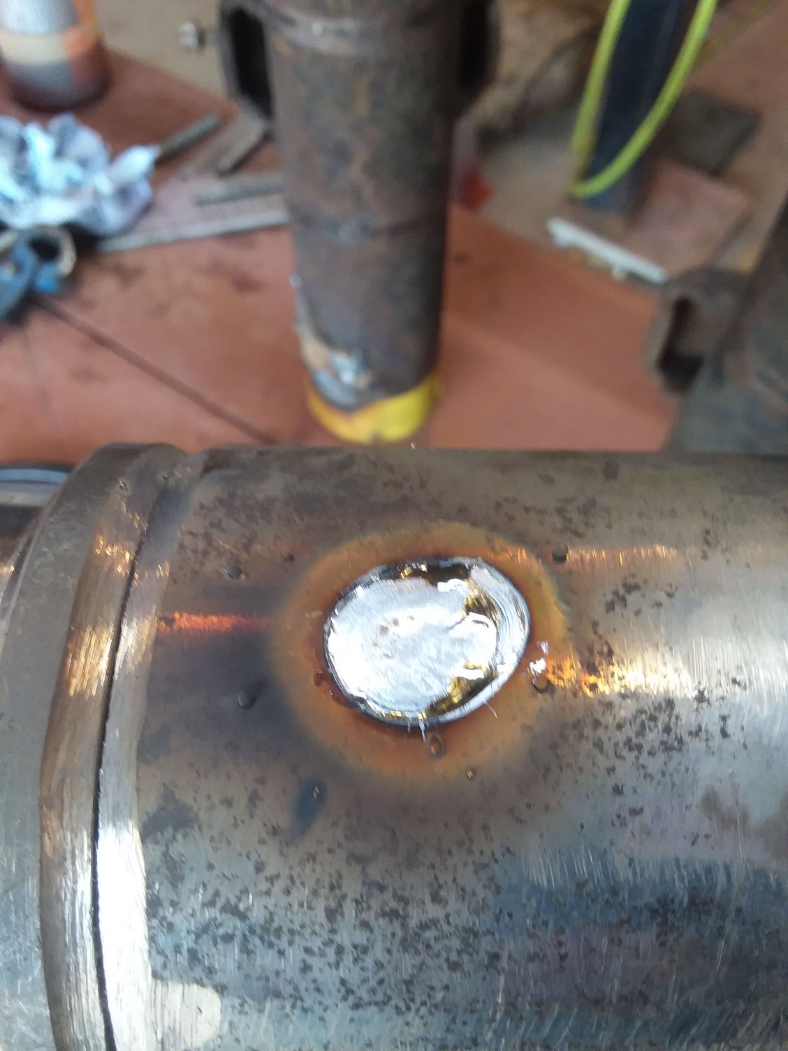

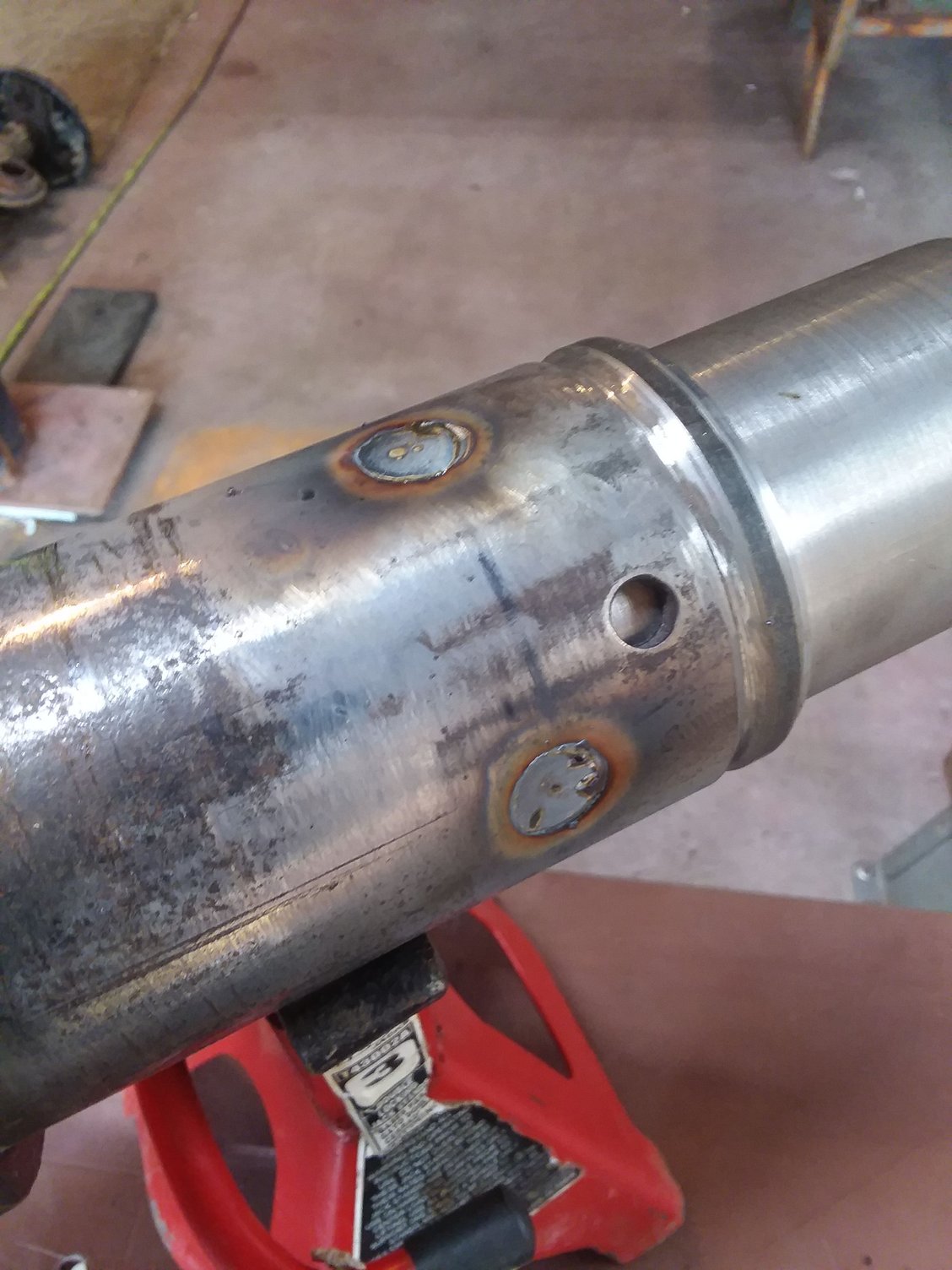

Machinist at work and i stayed after and turned these adapters down. The first .150 on either end have a machined taper to aid with centering and also ease installation. They fit perfectly in the new dom tubing, but the existing housing tubes are .010 out of round so they will be driven or pressed in.
If you look closely you can see the adapters are different o.d on eitjer side as 8.8 tubes are not .250 wall as a lot say they are. No biggie. Also, the exsisting axle tubes will get drilled in 4 spots as well as the new axle tubes so not only will i weld the seam, but plug weld the holes. Ill plug weld first to help aid with distortion, hopefully holding tubes straight. I am using a jig to insure housing ends are inline with carrier bearing centers but, that will not stop distortion. My dad and I have worked on trucks where the axle tubes looked like a banana they were bent so bad. No bearing failure. Not saying it's right, just putting it in perspective I guess is all. I am shooting for protection tho as I know it will distort so the closer I can get it the better.
When I was in college for fluid power I remember my professor putting a strain gauge on a piece of 2 inch 1080 cold rolled steel. The piece was about 10 inches long. You could grab and twist the piece and the strain gauge would detect and pickup the twisting distortion. Really has nothing to do with this post, just thought it was really cool at the time so I thought I'd share.

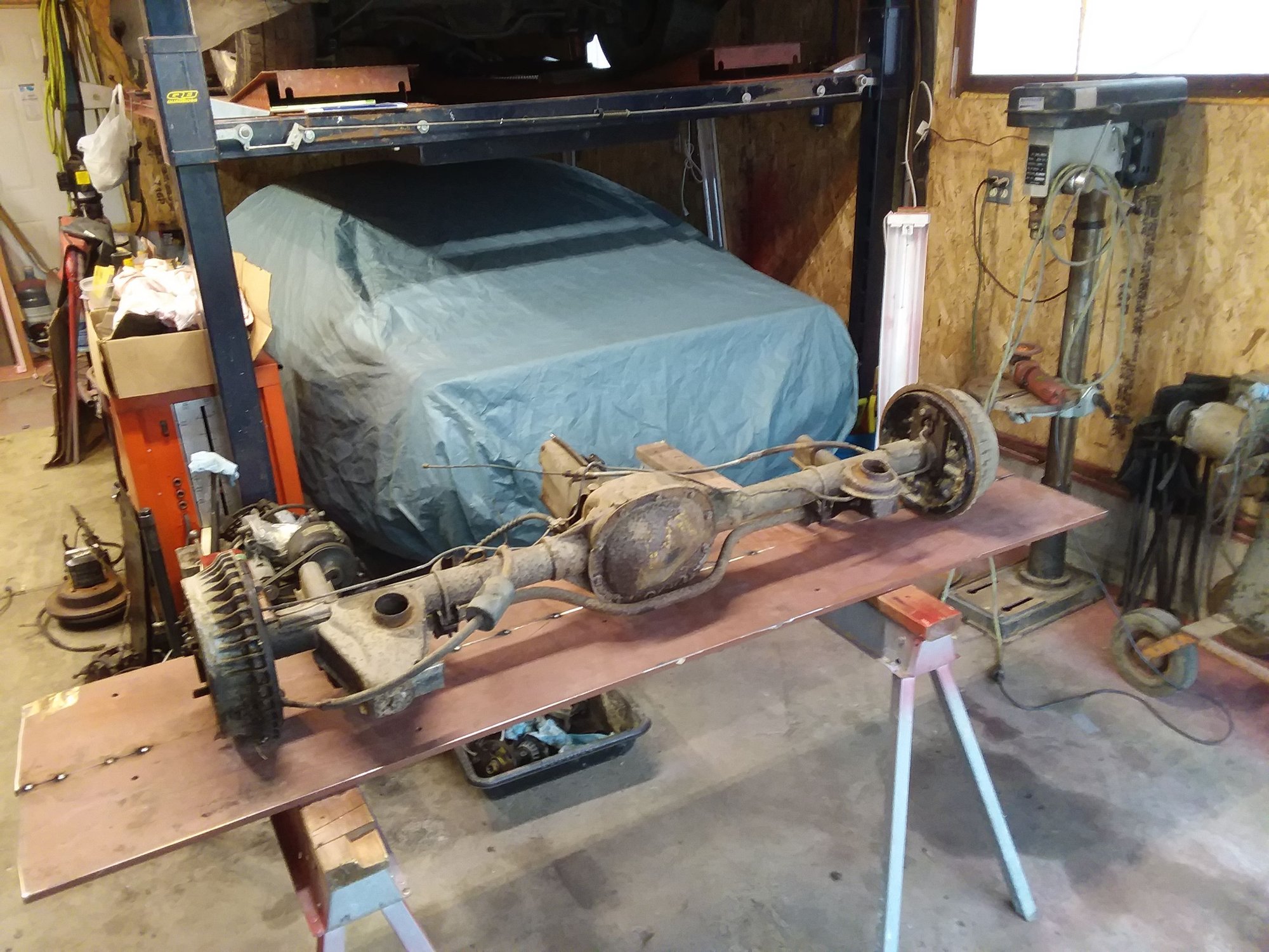

This is the doner axle. Only need for a template and for brackets. Definitely not paying 500 bucks for brackets.. The table is made from 1/2 ×12" wide steel i had laying around. This will eventually go on my bench eventually as a new top. Currently i just have a kitchen counter top which is nice, but no good for welding or beating things on.
Made a jig table for helping to keep stuff straight when i remove brackets off this old 10 bolt. I was going to go all out and weld everything to the table, but i think instead im going to weld the brackets together on either side of housing, so when i cut them off they are 1 piece. As long as i replicate the angle and distance from housing end, i should be good to go. Anyone have any ideas? Rather not make some crazy jig, but will if needed.

How are you making sure that the 1018 is straight?
Why are you asking about which bearings/ends if you posted pics of some axle tube ends in your first post?
As far as axle width there are 3 ways to go:
- if you're tubbing the car then tub it, find the wheels you want to run and then cut it to the length the wheels will fit best at
- If you mostly drag racing the car stay third-gen width or I might consider up to 1/2" narrower/side (you can do a lot more to make room on the outside, where if you run into the outer lip there isn't much you can do unless you want to flair things). 15" drag wheels are easiest to find in sizes that work well on the 3rd gen width. If you want to run newer, larger diameter wheels you can aways run spacers. (this is what I did on mine)
- if you're mostly street/road racing on modern wheels, most larger diameter wheels are designed around c4 and newer corvette/4th gen and newer f-body high positive offsets. In that case I'd consider going 4th gen width so you can just bolt those wheels on without spacers (bolt on spacers are not a liability WRT to strength, but they are an extra hassle). This will limit you to newer designs for wheels but it's not that bad compared to dealing with other cars, but you'll also never be able to bolt on stock wheels or "old school" wheels unless they're custom made to modern high positive offsets.

I'm not sure what you're thinking of making for a jig, but really the concern is that they are welded on at the same angle again, so a good angle gauge and leveling out the axle is really all you need if you take careful notes off the original.
If you overcomplicate things like me you don't really need an original axle except to measure off of, since at some point you'll realize that you want multiple mounting holes for the LCA and PHR and you'll end up making your own brackets. 3/16" steel works well and ends up stronger than stock if you go that way, may want to make yourself a press brake if you go that way also, it will save you time. At that point, measure angles, measure distance from the centerline, then mock it up in cardboard, cut it, bend it, weld it, have your 3y/o twins approve of it and keep going...

Lol, well hey, if its kid approved then its gotta be golden. Yes, definitely dont want to over complicate things. My car is lowered just a inch so stuff shouldn't be off too much. Once I get the rear to size I will fart around and see about lca and pan bar brackets. I have full access to a machine shop at work so it shouldn't be to hard.

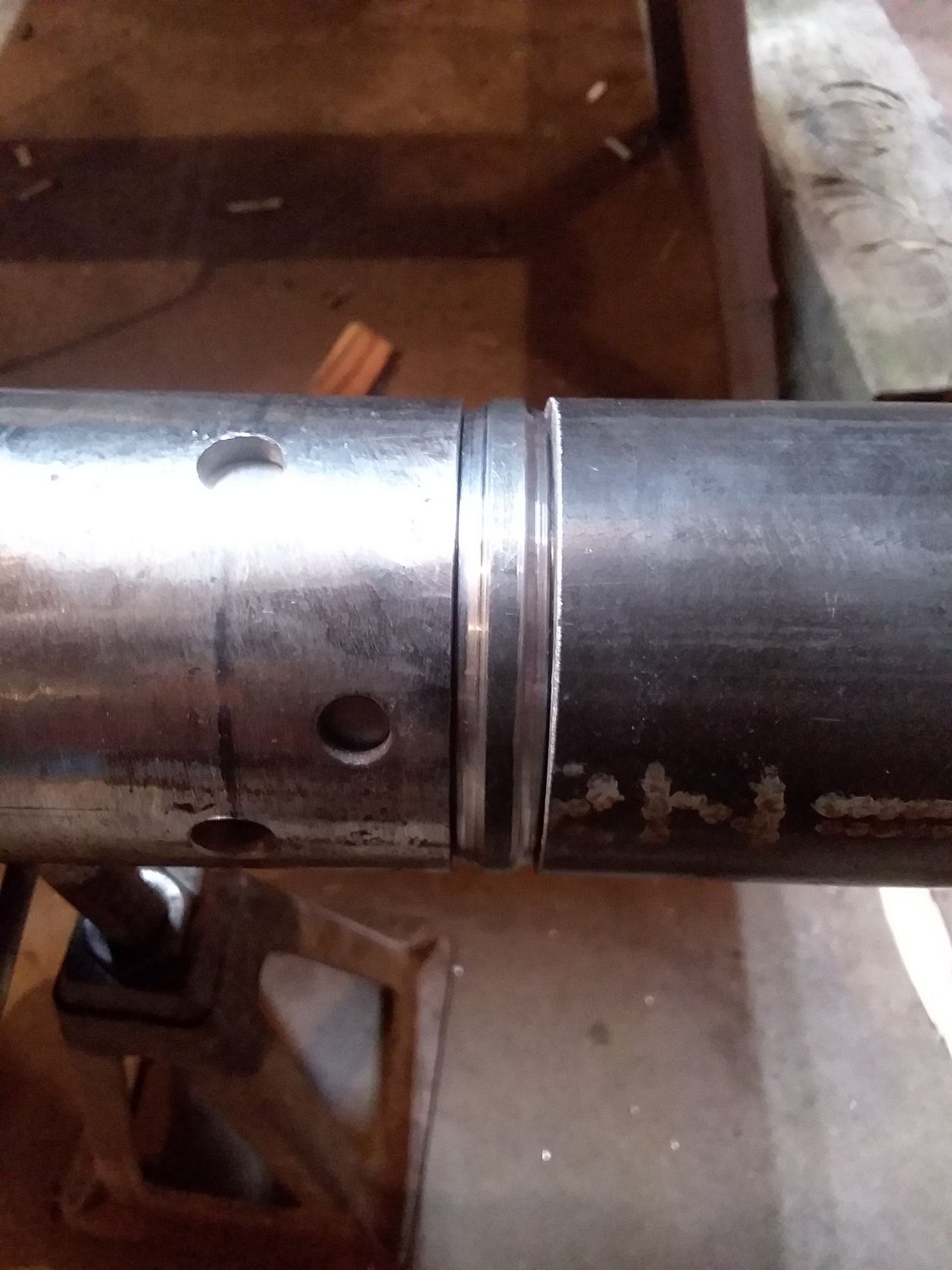

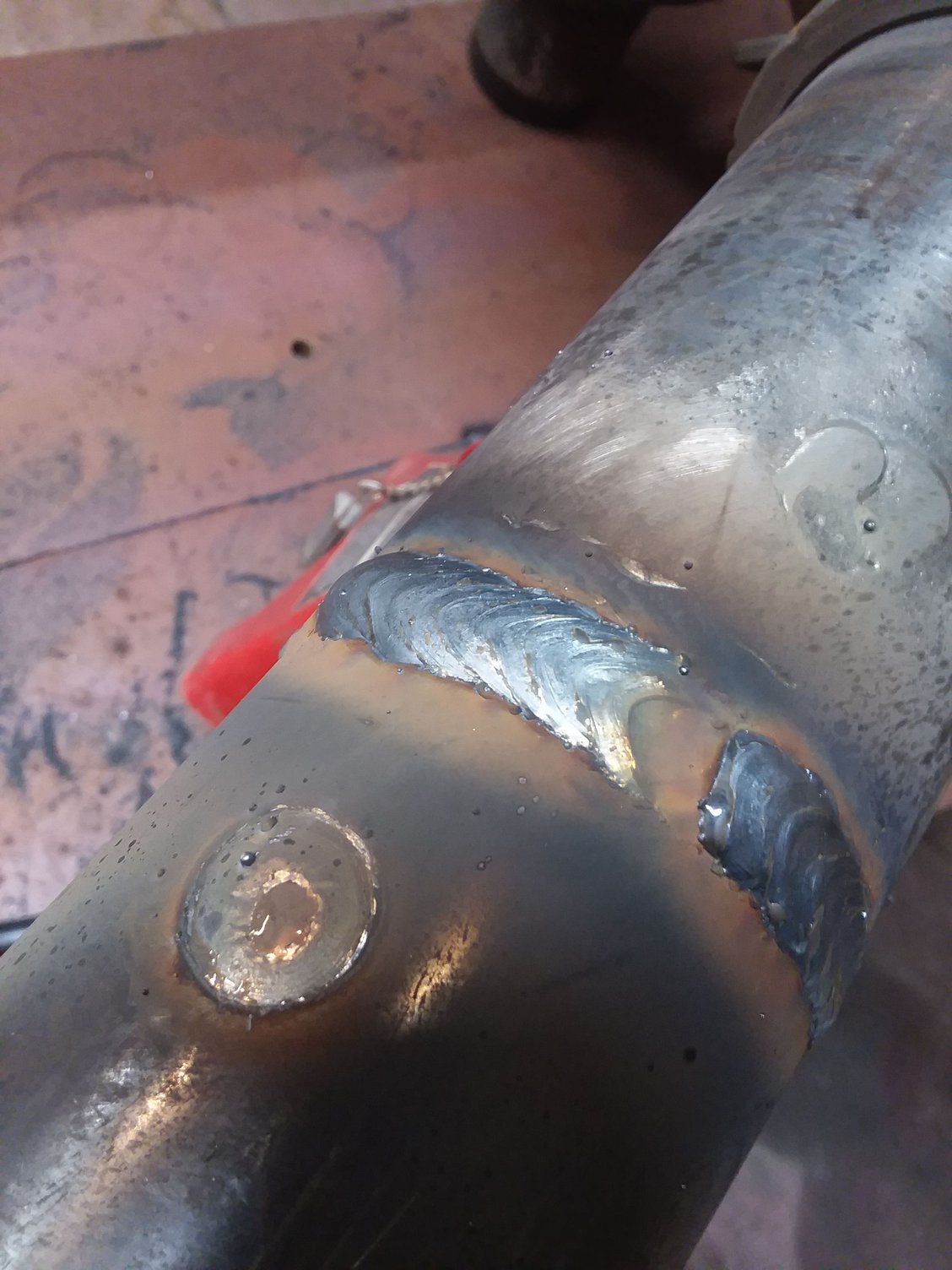

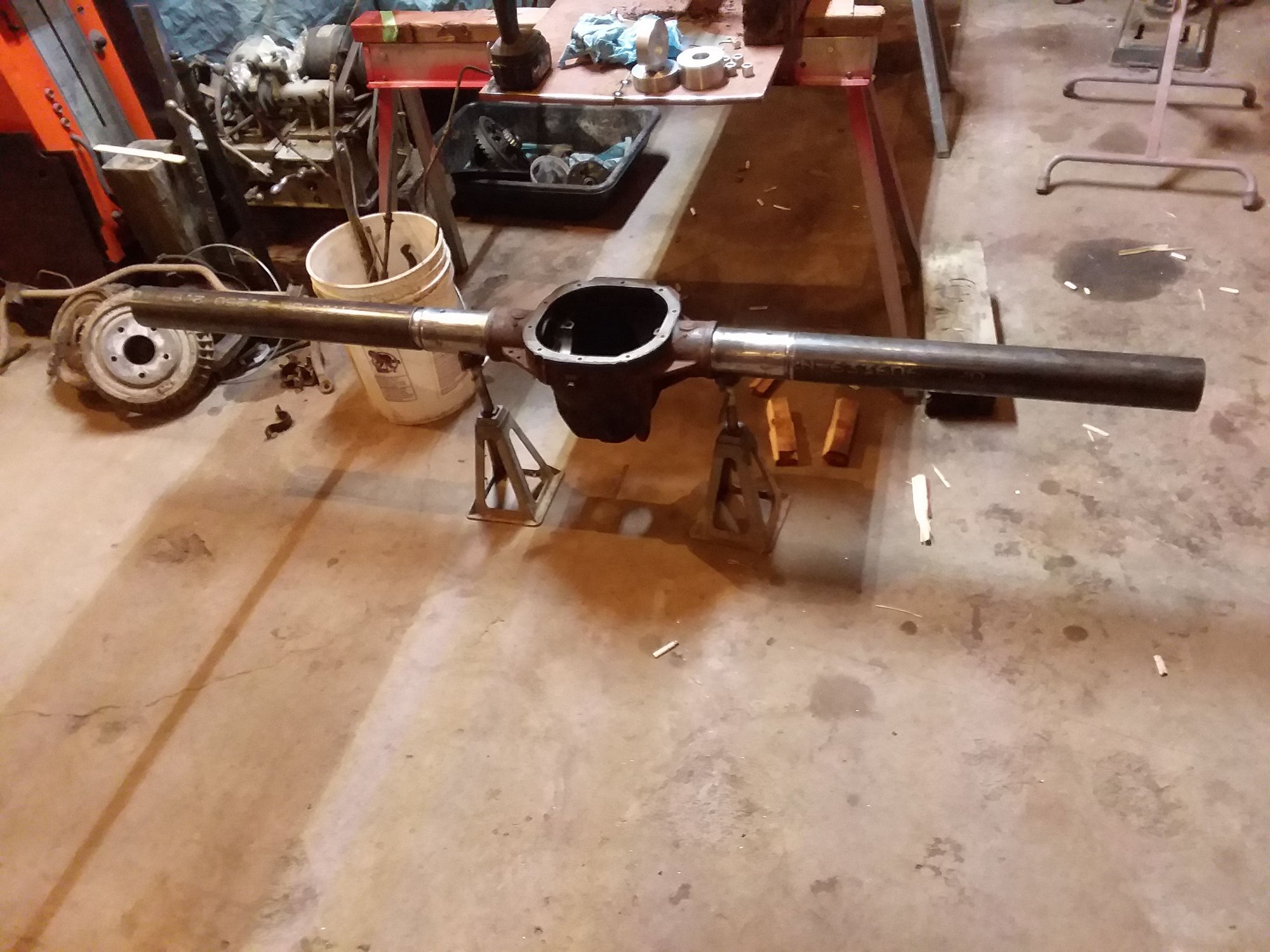

Got the adapters pressed in housing. Completely forgot to bevel inner tubes but i can still do it with my grinder no problem. Outer tubes slip on nicely so i will grind them also.
Think i may just run this width. What ya all think?? Can easily put some 40" wheels on it then. Well at least out back. Lol

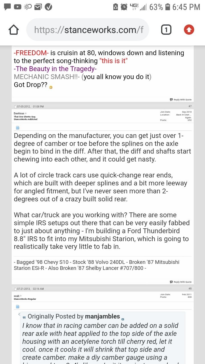

How will you be setting the toe and camber? This is what made me not build my 8.8 myself once I learned the axles tubes have a precise pitch to them I had TNT fab do mine. You should be able to see some pitch in that 7.5 on the 4th gen rears it real pops out most would just think the tubes are bent. And yes I could see it after I got my 8.8 back from tnt. The pitch does a few things like tire wear to handling but the big one is it keeps some load on the c-clips.
Are you saying they actually made your rearend not straight? Never heard of such a thing. Places that narrow rearends have an expensive set of precision bars and collars, a well founded jig to set the housing in, just to keep it straight.
I'd comment further, but will wait for your reply.

Factory rears aren't straight if you think they are you need to look at them closer. Will a straight rear work yes but its more for a drag set up.

I don't know what the target # is for the degree or angle but it there just most never seem to pay enough attention to the details.

Go on YouTube and see how they press tubes in a housing. Not talking about a shop doing it but from the factory. It would be IMPOSSIBLE for a manufacturer to put in a specific number of camber and toe due to the amount of welding that happens. Even welding the brackets on the tubes will cause the tube to pull.
The alignment bar only gets you close. I dont care how strong it is. When you apply heat/weld to steel it moves. This is where years and years of welding makes you a good welder.
I would really like it if you could post information on this if you have it as I cant find any. I've even asked a friend, who has a very nice alignment rack if there is such a thing. He said to stay off the forums.
I do appreciate your reply as this is something I never thought of and if it holds water, I can figure out how I'm going to do it.

Got some welding done. Spent some time setting up the welder so it burns in/flows nicely.
still going to practice welding on a old tube as it's not every day a guy welds around a relatively small tube. Want the welder to be as hot as I can get it so i can get good penetration and move fast without putting too much heat in it.

Re: 8.8 fabrication
Keeps loads on the c clips?? This is also a new one to me.. I'd think, after thinking about this for just a minute, you wouldn't want any load on your c clips. They would wear out extremely fast. Also what about the millions of cars out there that dont have c clips??
Now you have me thinking, are you trolling??

No doubt. The only info I've found on the matter so far is this. Also if a rear axle is IRS you can do it. 1 deg will cause the splines to bind from what I've read so far.

IDK why you would want any toe or camber on a street car? I have seen where they purposely heat up the tubes with a rosebud in nascar to make slight changes in camber. But they're just turning left. 4WD vehicles often have about 1 degree toe in, in the rear, and 1 degree out in the front. Something about the way they operate. But never heard of any toe or camber changes in a RWD rear.

Got the tubes on, started with the plug welds. It held true. Dead nuts on both sides.
Final pass weld. They are ok, im happy with them. It is very difficult to weld a tube wo a 2nd hand turning it for you. No under cutting and it laid down nice.
Side shot. Not sticking up too high. I know many of you will say, dont grind the welds smooth, but im going to. Being its got a 6" adapter inside that has been plug welded in 8 places, a beefy hot root pass, im very confident grinding them down wont hurt this to the point it will fail. I only have 470hp and just under 500tq. It may seem like a lot to some, but in all realities, its really not. More to come. D

Should have plenty of bends to do what i plan. Plan is to merge into 1 pipe and either dump b4 axle or attempt to go over and out.
8' is the longest piece. Have plenty of flanges. But this will be a whole different thread.
