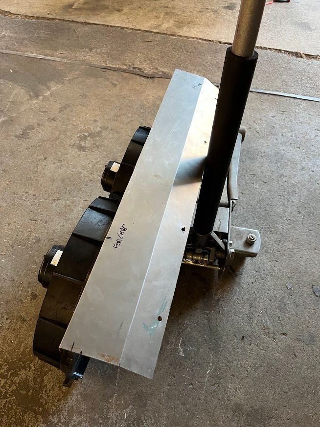

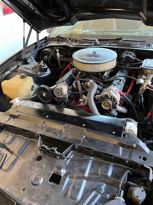

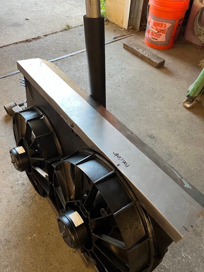

Just finished installing an LS1 fan upgrade and made some pretty slick mounts to keep it in place. Tried to get a picture of the bottom mount installed in the car but it isn't really visible at all. Also will be adding some sort of foam or rubber under the top mount to avoid any chafing on the aluminum radiator.
Here's a pic of the bottom mount. It's fastened to the fan housing with rivnuts, the two tapped holes align with holes that are already in the lower radiator support tray from the factory
the upper mount
upper mount from the back, have to notch around the higher fan.

I notice that entire area by the hood latch is covered in, does that provide any better cooling? I've been thinking about doing the same on my car
not sure what you mean exactly
That plate or whatever that covers the entire area in front of the hood latch
your car doesn’t have that? what year and model do you have?
Nope mine never had that at all. 91 Z28
The camaros and firebirds were different in this area. It was more closed off in the birds and was metal. The camaros had a plastic panel there.
Ah I see I see. I was thinking of making something for that area to have air only you thru the fans and radiator
