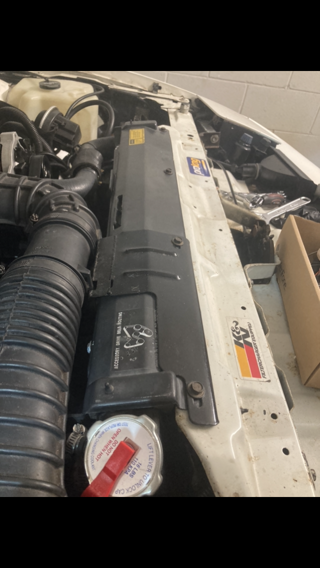

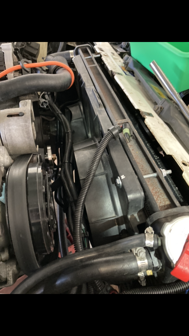

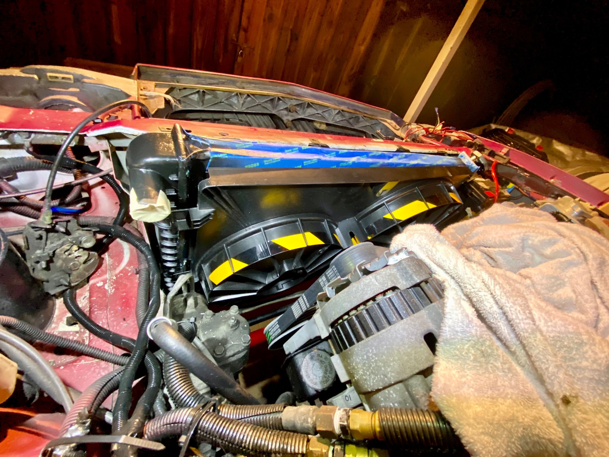

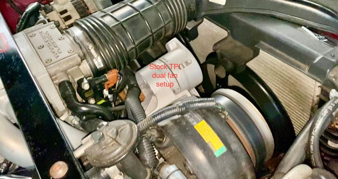

Summer 2021 I installed an LS1 Dual Fan Shroud into my 1992 Camaro along with Pusher Fans, Davies Craig #0444. The goal was to keep the engine temperature lower than when the stock TPI fans were mounted. Overall, I am well pleased with modification/upgrade. Eventually, I may just rotate the fan shroud as I put it "upside down", whatever works. LS1 fan shroud into a thirdgen, I recommend. Thanks.

I did it several years ago too. I used both the shroud and the fans themselves. They're the same part number, but they ARE a better fan. It's not identical. Same pigtail and everything, just better fan motor. Anyhow, just needed a little trimming of the stock radiator shroud. Overall pretty easy. Made a huge difference.
