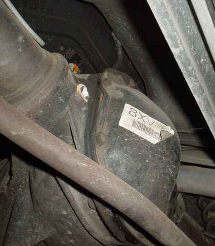

To verify your axel you can look on your axel tube, passenger side, there is a stamped code there facing forward.
No need to remove bolts or anything unless you have alot of free time, just crawl under the car.
Also you can look on your carrier cover for an ID tag, most likely its gone.
Here is mine as an example:
Don
Don

warrior_91, tell me your code and I will tell you what rear your car came with and if a posi or not.
The standard rear in 1985 for an LG4 was a 3:27 The 3:08 was optional. Source: 1985 Pontiac Merchandiser 8/84
