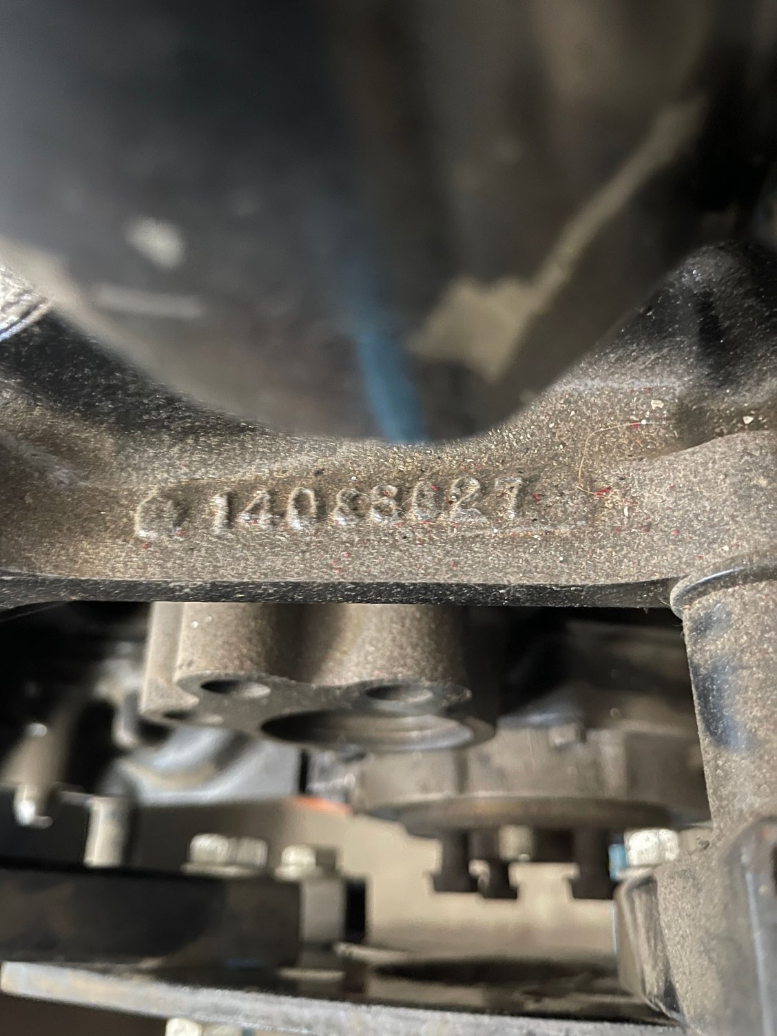

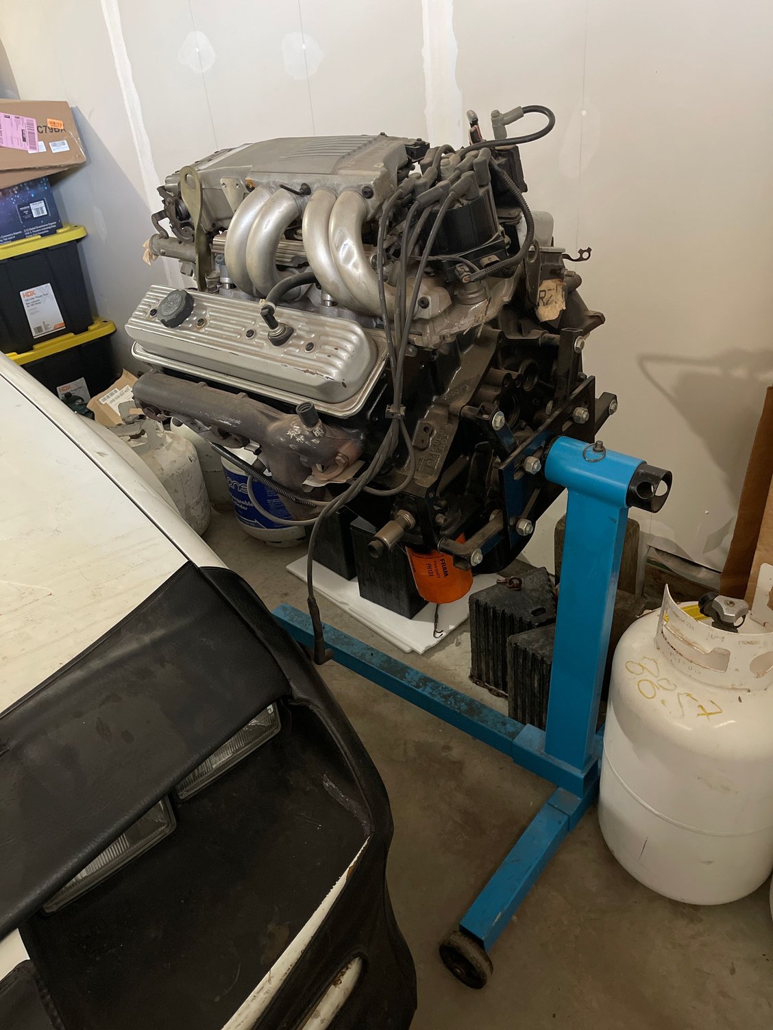

you seem to know your info on this. We currently have a R7U sitting in our garage and are getting a ton of different info. Wondering if you can help us figure out the year of it and any other info we can get on it.

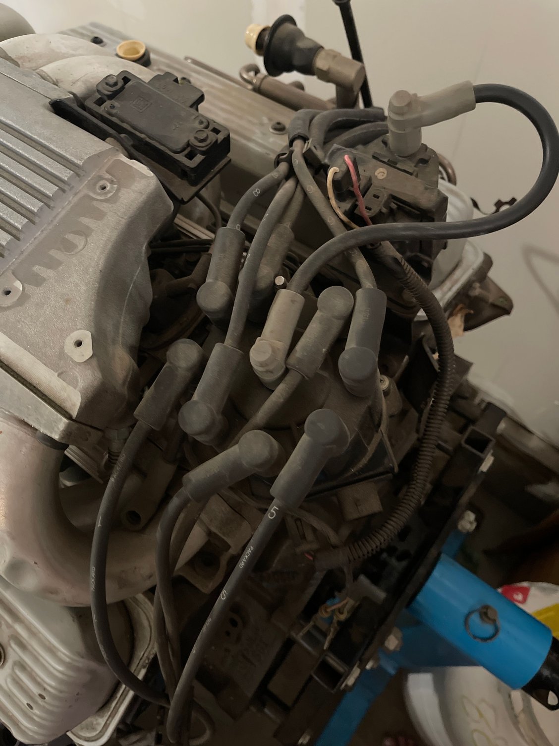

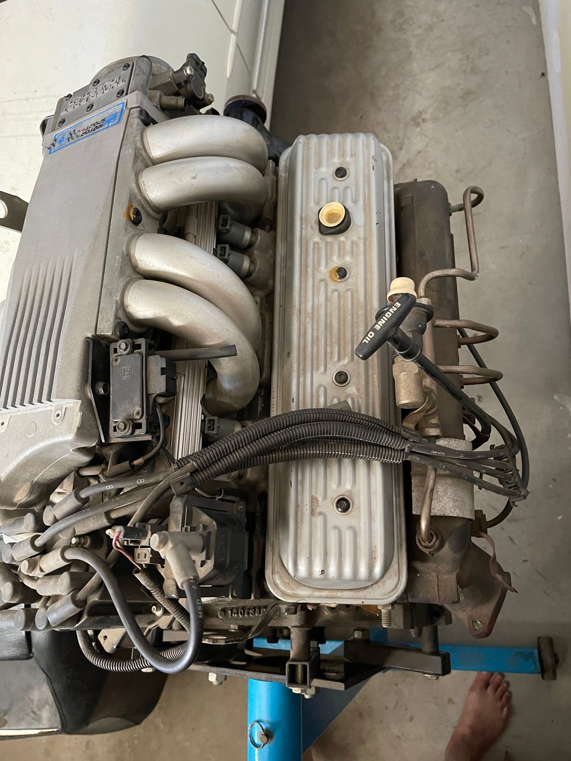

Does this motor have one broken spark plug on one side? If it does it was mine before.

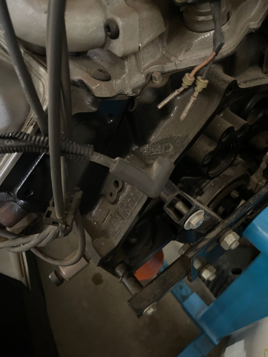

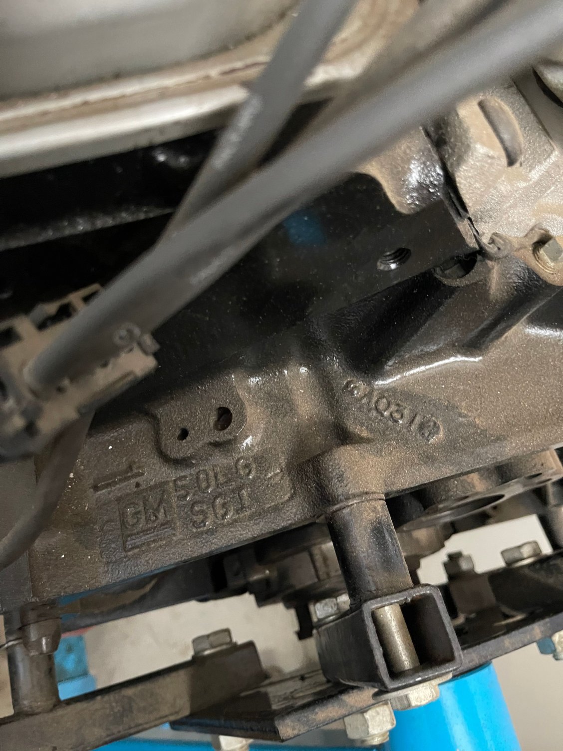

I am not entirely sure. I would have to double check. I’m trying to find info for my husband as we want to sell it. We’re in Red Deer Alberta and someone he knows found it in a seacan or a storage unit or something along those lines. He wanted to drop it in his 1989 Iroc convertible but decided to keep it to the original engine. Blew the head seal so just need to rebuild that engine.
If it was my engine is either a 1990 or 1991. It had a laminated card with it. It was a pinkish red colour but im sure it was lost
Please don't install that motor in anything. It's a sealed motor and in my opinion should be preserved or sold to a player's nerd like myself or mark lol

Hi. You need to look at stamping on front of the block. If it was a series replacement, then it will have the build date and code. If it was in a car, then the partial vin will be there. My guess ... it looks used, so probably from a car. The paint marks are not all there, so some parts of been apart. Hard to say for sure from the pics. A few things on the motor are curious. See what the stamping says. That is the key.
