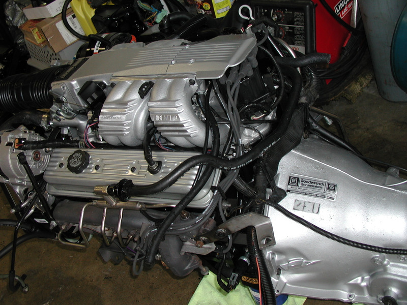

I used Dupli-color Aluminum 500 degree engine paint with ceramic and their 500 degree clear coat on top. And mine look factory and haven't yellowed.The clear gives it the gray look.

The clear is what makes the color the same as the factory
