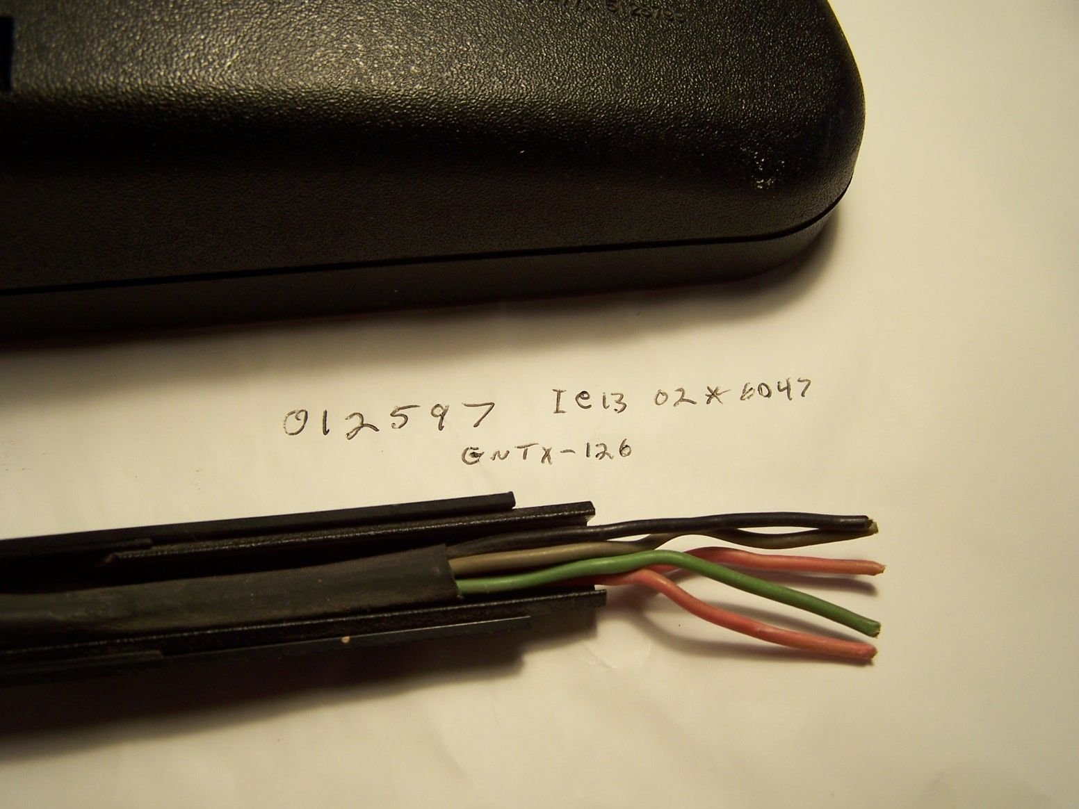

I have a mirror from a 1995 Buick Riviera that is auto dimming. For wiring it, does anyone know what is needed? There are two pink wires, one grey, a black and a green wire. The numbers on the back of the mirror are written down.
Any help on this would be great!!

Green wire goes to the backup light so it will turn off when in reverse.
Black goes to ground
If it has a remote temp sensor, one of those wires might go to that...
One of the wires will be for power, you want it to be switched power so that it is not constantly hot, it will kill your battery...
Suggestion: go to library and look it up, The Service manual it will tell you exactly what they are for... obviously use the 1995 Buick Riviera/Olds Toronado Service manual.
John

Thanks John, Interesting that the green wire is for the back up lights to shut off the mirror. I assume that is the power from the back up lights?
I may just go to the dealer to see if they have any info. there is only auto dimming , no temp sensor on this one.
When in reverse the mirror is to turn off...
John
