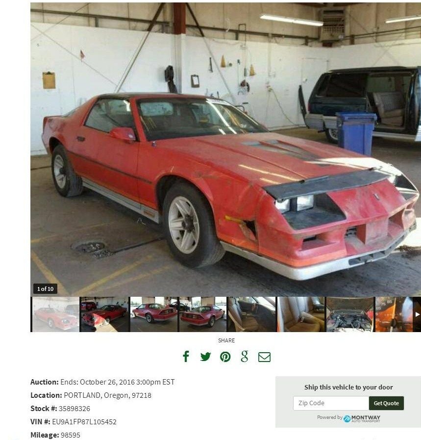

Is This VIN Correct,Never Saw One Like It. Looks Like It's An L69 Car The Ad Is Here. https://www.hemmings.com/classifieds...o/1884937.html

No, that's definitely not a VIN. Doesn't even have the year character (should be an E right before the L if it's a 84, for example). Somebody had trouble reading it or something.

The numbers posted in the CL ad aren't a VIN. They're GARBAGE.

If the last seven are correct and this is an L69 car the VIN should be 1G1AP87GXEL105452.
