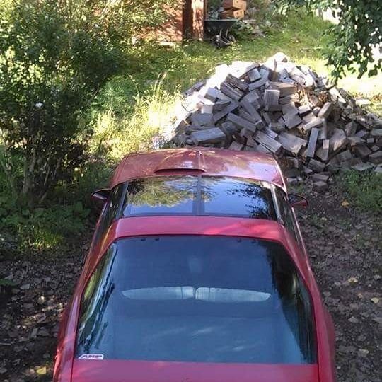

This is the car it is a 305 tpi car and it says right on the hood. I'll have to check the door to see what year the car is. It also has the factory turbo hood that came on those formulas. I also took the spoiler off because it went to crap.

Re: Real or fake 1LE
Quote:
Yes it does have a Iroc hatch on it. The stock hatch had bubbly paint where the spoiler was.
Looks about right for an 87 Formula. The decals are in the wrong spot, so it could be pieced together. Doesn't matter much really.

Jan 12, 2018 | 11:29 PM
Of course, we can't see the hood, but...
Stickerzzz are cheeeeeeeeper than carzzzz. Been that way as long as I can remember. There's A SHIPLOAD more 69 Z28s in the world now than there were in 69; A SHIPLOAD more 71 "vette" "LT/1" motors than there ever were 71 Vettes; A SHIPLOAD more "69 Camaro" 350 blocks in the world now than there were 69 Camaros; and so on. You oughtta try to buy a 65 GTO sometime: there's AT LEAST 5 times ad many clonezzzzz as there were in 65. Mecum and Barrett-Jackson are full of em.
Looks like a mostly OK car NOW, needs some work but not tragic, a little body work already here and there sme of which is ... less than perfect if not laughable, but hard to tell what it CAME AS. Those can be 2 very different things. A photo of the SPID label (blank out the VIN to avoid ... creeeeeeeeps ...) will tell all.
10th digit of the VIN is the year. F is 86, G 87, etc. What's that one?
Yeah she's in good shape except the bumper cover and the stone chips its rust free except a little rust on the corners of the passenger side door it needs repainted though. Where should the decals be placed if its a formula.

So is it a base model v8 or what is it. It has all the performance sound and performance suspension decals and stuff.
Now there is a pic of the hood I just had to find a pic.
Looks like a 87 formula, I'd think it could have a build date of late 1986 on the door decal if its original to the car..
1LE showed up in 1988.
Looks like an 87 Formula based upon wheels, etc.
What should the head light cover look like because I bought the black piece because I cracked the old one but it was for an 86 so maybe thats why it looks different. Do you mean the doors look different. It has electric fans but it does have 2 belts one drives the crank to the water pump to the power steering and the 2nd goes from the crank to the water pump to the alternator. It does have the air box to the tpi and it has the original engine in it. I looked up the vin and it is a 1987 formula built in Norwich. So at least its a formula.

Jan 13, 2018 | 03:03 PM
It's not so much that; it's that the paint doesn't even come close to matching.
I didn't say the doors look different. Only, that if they say "86", it's entirely possible that it/they came off of a 86 car as part of fixing up or wreck repair or whatever before it was last painted, since they're the same as 87.

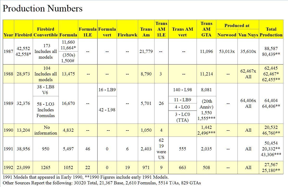

Jan 15, 2018 | 01:04 PM
Quote: 1LE showed up in 1988.
But only as a TA from Pontiac - 3 were built.
The 1LE Formulas were limited to 91 & 92, a total of 63 were produced between the two years.
https://www.thirdgen.org/forums/hist...es-number.html
