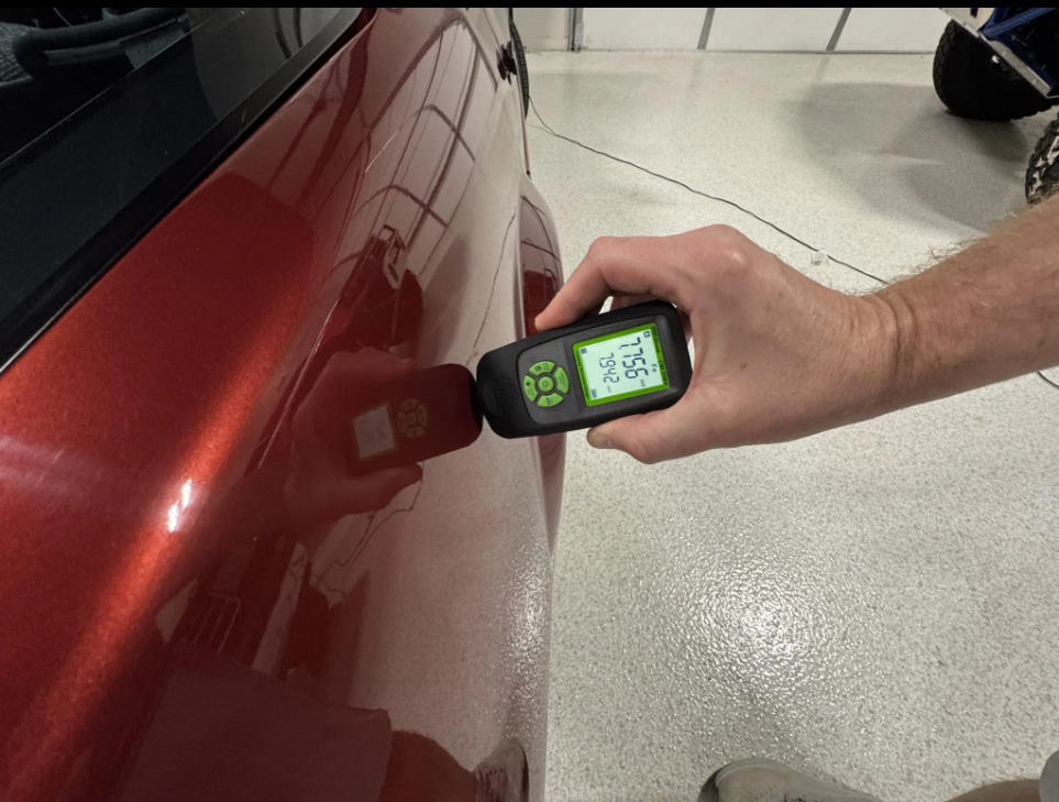

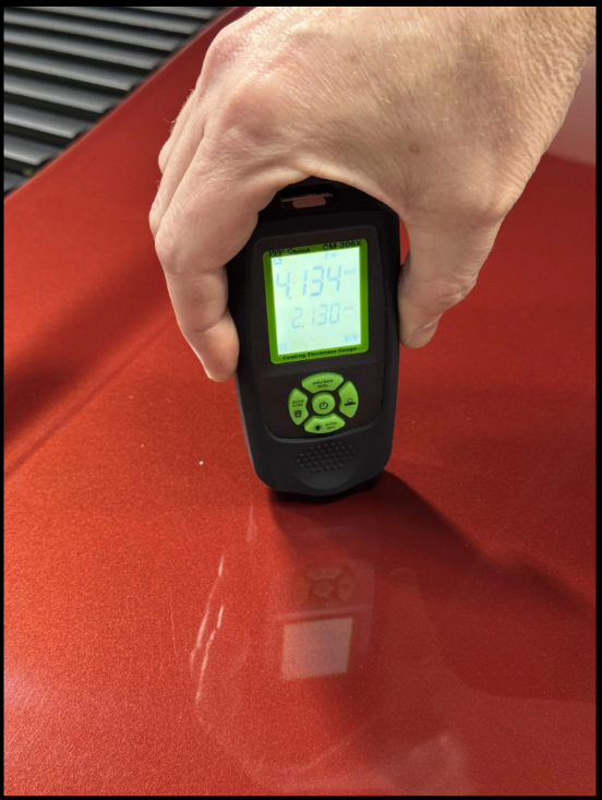

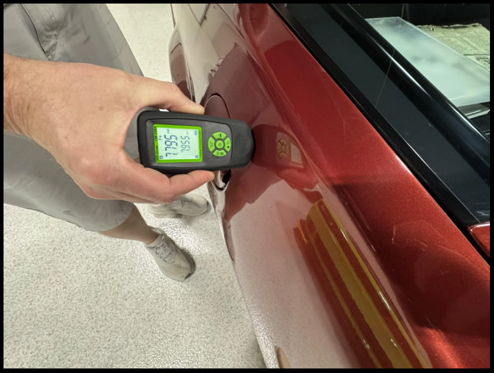

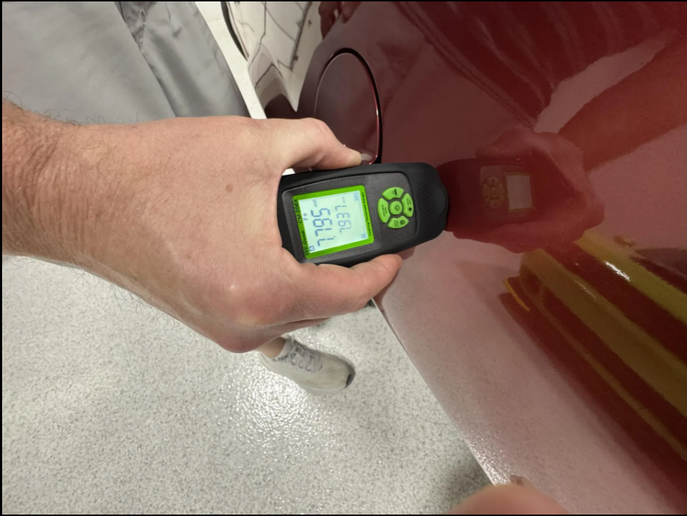

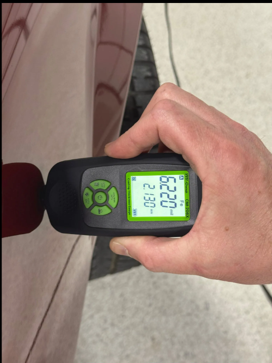

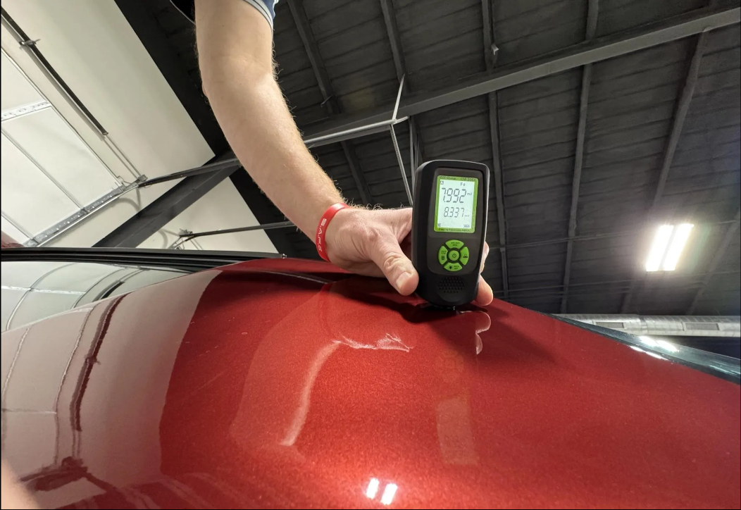

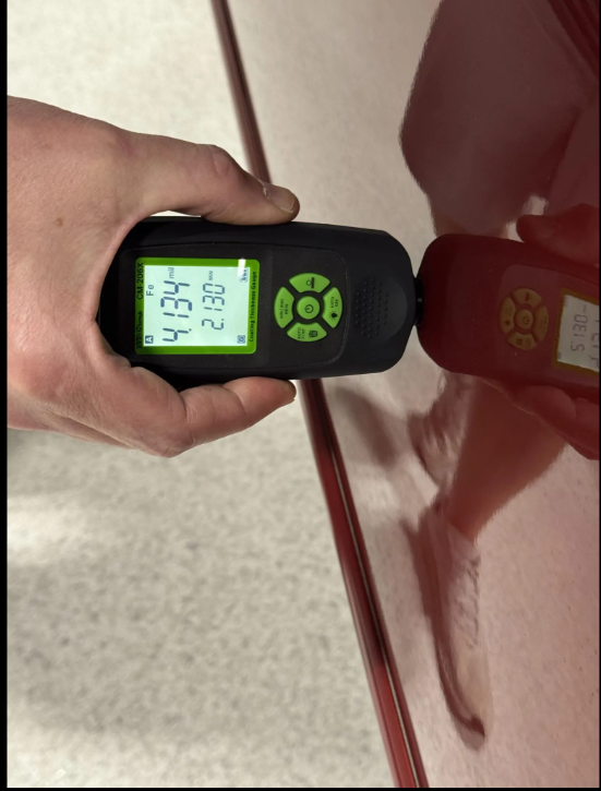

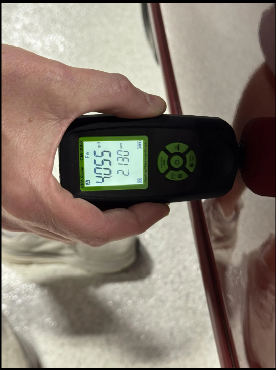

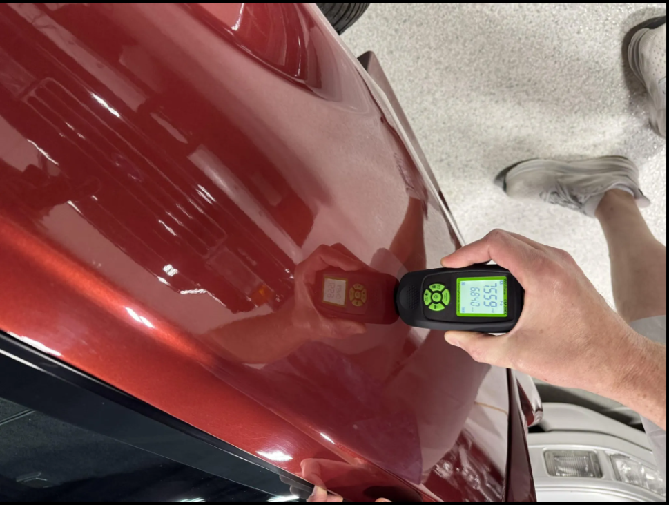

Exactly. We can now confirm that this car has had paintwork done, which many of us called out years ago and were threatened with lawsuits for slandering the car's appearance

Re: 1989 IROC 344 original miles
Originally Posted by chazman
I bring up a warranty DS, because I've heard that if you had any high speed vibration complaints, the dealers would simply replace your steel DS with an aluminum one.
Paint thickness on the quarters and B pillars are almost double normal. Probably not claybar residue.
Were these cars painted by robots in 88-89 or were they still painted by a person? If a person, I would not trust paint thickness readings as the be all-end all on originality.
These cars were painted by robots in the '80s. The doors, fenders, hood and quarters were on the car when it got painted so the paint readings should be close on all vertical surfaces and probably slightly higher on horizontal surfaces.
Quarters both definitely repainted, probably blended into the doors too.

@scottmoyer may I ask what is the tool you're using to read paint thickness?
I'm not doing any paint readings. I posted the pics that were posted on Bringatrailer.com. I thought it would be good to add those to this thread as it proves our case from years ago.
