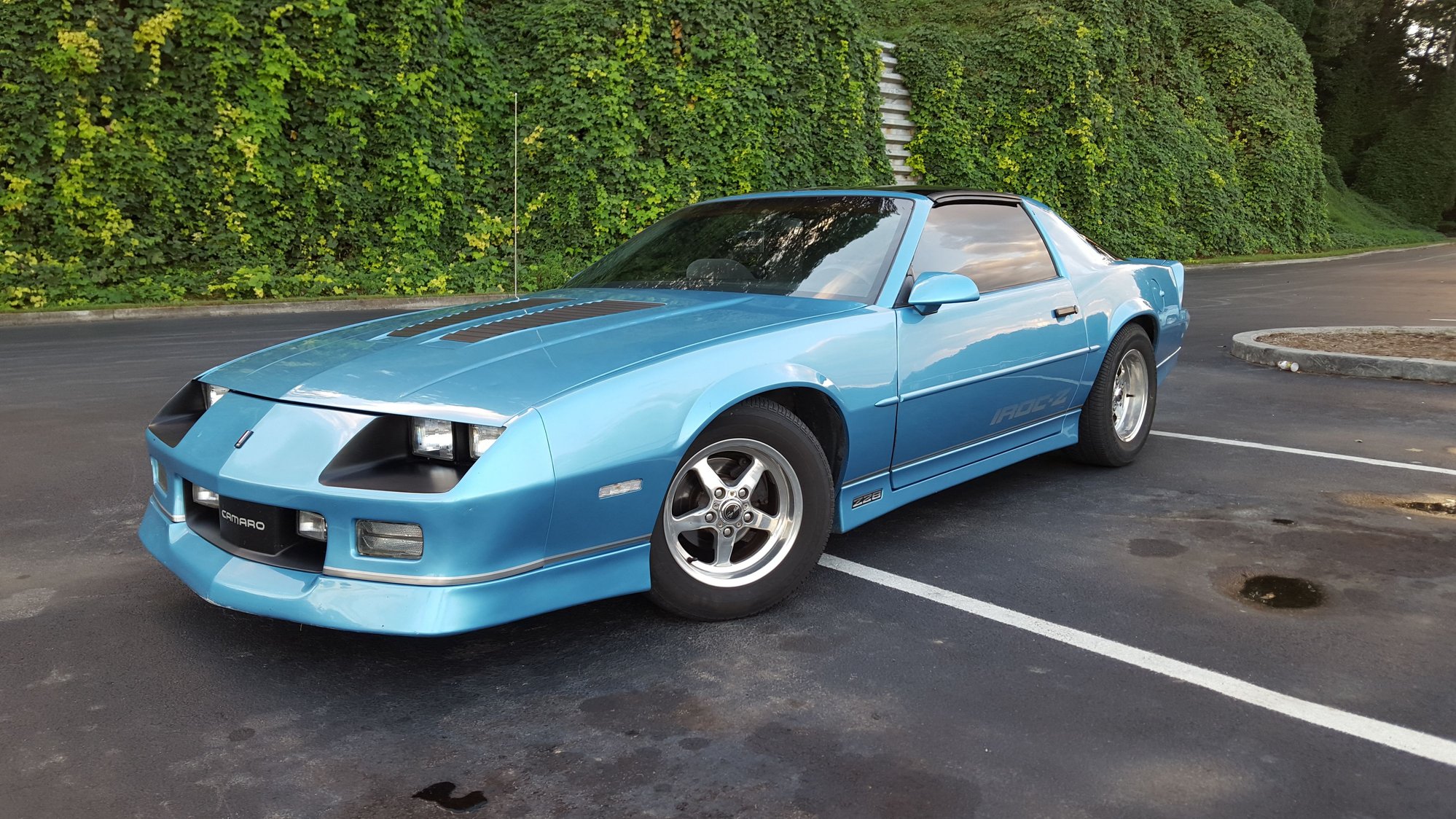

I had posted a pic of my car the day I bought it to point out Craigslist isn't always a bad place to find a thirdgen...I've had mine a little over 3 years.
