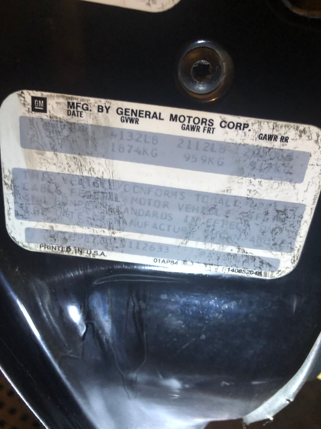

Quote:
I have a sticker, but it is smeared with something and I cannot read the production date.... I have tried everything I can think of to get the smear off, and it won't budge.Originally Posted by chazman
Look on your driver's side door jam.
