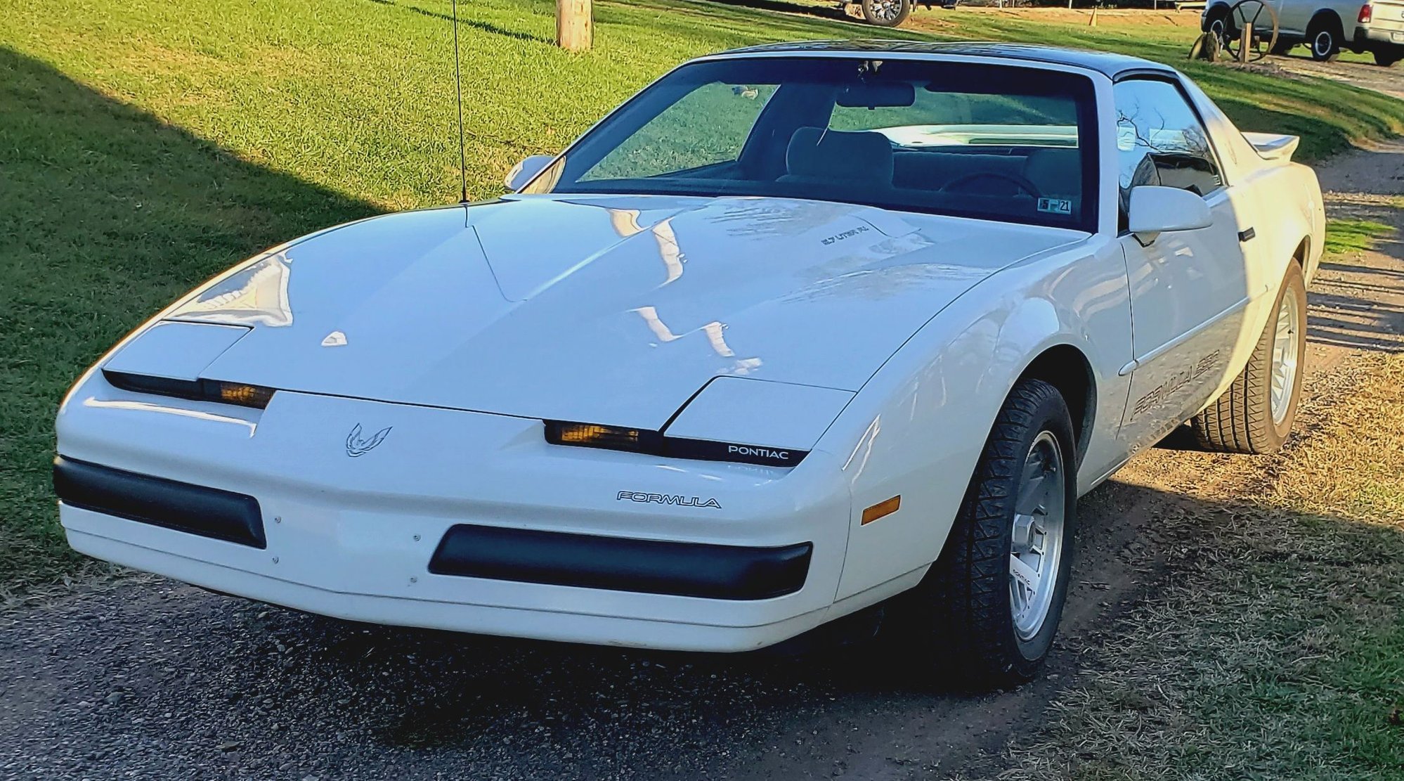

I have a really nice bird, white with gray interior.
46k miles. Nice origional paint. Have alittle jing to put to it. I dont know whether to do some changes like stereo ,speakers, suspension, brakes, All are currently good, Or leave it and keep it as she was born. Thoughts?

Sounds like a really nice car. As for modifications, it’s really what YOU want for your car. Do you plan to keep it and enjoy it, or are you thinking of resale? From an originality and value point of view, 46K miles is low miles, but it’s not collector car low, so you have some leeway. Some tasteful upgrades like suspension/brakes, exhaust, subframe connectors, etc. won’t hurt the resale value.

Thank you. Those are the opinions I'm looking for. Origionality doesn't matter with a car like this. Ill be honest, I'm struggling with it.

The changes you have mentioned will not hurt at all, and are all easily reversible. Just keep the originals in a box, just in case. Nice car!

I like original but as said, some mild mods that are easily swapped back won't cause a problem. Just remember those same mods probably won't add any value either.
Great looking car, whatever you do, take care of it and enjoy it !
As far as suspension parts, the swaybar endlinks struts/shocks will need replaced. I'd look at the factory idler arm for sure. I'm betting bushings and ball joints will be fine. Sure the bushings will have a few small surface cracks but nothing to warrant replacement. Don't do poly if you want to keep it a nice smooth ride.

Hey bud, bolt ons are fun and make improvements to an already great car, like others have said they are easily reversible but I highly doubt you'll want to lol. I don't keep anything stock however I don't go overboard either, this is not a car I'd do a motor swap to, You do those kind of things to clapped out but solid V6 cars in my opinion. Have fun it's yours to do with what you want. I'll have to say my stereo upgrade was well worth it.

You can do upgrades and work within keeping it stock appearing, 98+ Fbody brakes fit under 16" wheels. Far as suspension, better shocks like Konis, slight lowering, better components on the end links and sway bar bushing, wonder bar. All make big improvements with out massive deviations.

Yeah, full understanding no value increase. But maybe some underbody upgrades would make me feel more confident. As opposed to when are those over 30 year old parts going to fail?

Thanks. I've been looking at shock upgrades cuz well, these are quite tired. Everything still seems pretty tight, but if Im opening it up, might as well look at the other upgrades to the other bushings and links.. Make me feel more confident hitting those corners.
