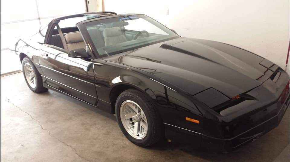

A picture is worth 10,000 words - post one

looks like a GTA with a Formula hood and wheels......or a Formula with GTA nose and ground effects
I'd like to see the SPID - do you have the VIN # ?

Originally Posted by cmk-2
I think thats a Firebird with RPO W68 - available 1989 - 1992.
In 89 & 90 it was with a V-6 only - in 91 & 92 the L03 V-8 was available
I'd bet money that's what it is - what year are they saying it is an 89 or 90 ??
BTW, records indicate they made only ONE black 1990 W68 V-6 manual trans
This may be the ONLY Black 1990 Firebird W68 (Sport apperance pkg) with a 5 speed that was produced in 1990 !!

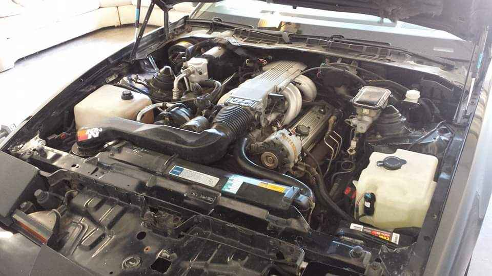

Well as of now he has not responded to my request for more pictures and information. He stated to me that the "T/A's did not have the vents behind the front wheels the GTA's had them". So I don't realy think he knows his 3rd gens. He lives only 65 miles from me but I don't want to just show up at his place. It is a 5.0 TPI with 5 Speed not sure it it left the factory that way or not.
It looks factory orignal in the pics,
IMO, maybe a GTA with a formula
hood and wheels....just a guess based
on the engine/trans as the W68 option would
have had the V-6
I'd really like to see the spid tag for this car !!

It appears to be a Formula that someone installed the Ground effects and bumpers from a Trans Am/GTA
VIN will tell all
