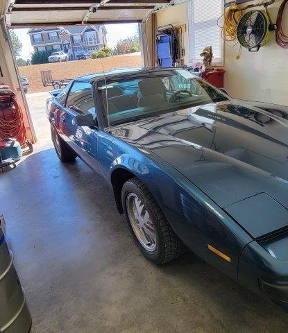

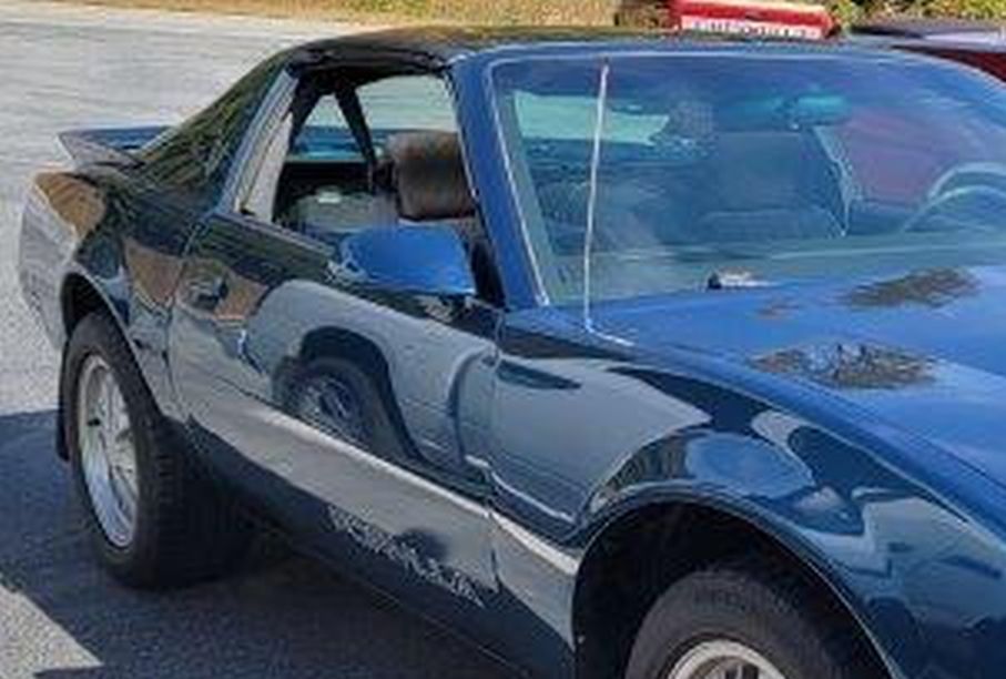

A couple generic pictures, the interior is actually a screen shot. I'll have to get some better ones I guess.

Looks nice. But according to the list of RPO codes you posted in your linked thread, there's something odd about it, and it might not be completely unmolested.
The body side moldings, which you questioned in the other thread, have been removed. Hopefully that's the only form of molestation. But that would be ok, IMO, and I'd suggest leaving them OFF. They weren't an integral part of the 3rdgen design, meaning, the cars weren't designed with the moldings in mind. They're a tacked-on option, and 3rdgens look 100% better without them. B84 is the option for the molding, and B87 is apparently the option for the color of the molding, so your blue Formula should have black moldings, which will not look ideal.
That brings me to another questionable observation: without running your VIN, which you posted after I began writing this, I think your Formula might be a very early build, like, September 1986. There were "early" and "late" 1987 builds, where some major changes were made that favored the "late" builds, like mine.
The body color side moldings might've been such a change.
And your 305 TPI/5-speed combo should've featured the strongest 305, with the "L98" cam and a Borg Warner 9-bolt rear axle with 3.45 gears. Yours has a 3.08 10-bolt, so it might still have the "peanut" cammed LB9, which might've been the "early" build, using carryover parts from the 1986 model year. Does your engine have perimeter bolt valve covers or center bolt?
Regarding the Performance Sound System, nothing special. Most cars probably didn't have it, but plenty of them did.
The seats, though, I don't remember that on my worksheet when I ordered mine, and I'm out of town and don't have my worksheets to verify it. But I'd say that most 87 Formulas probably don't have them.

Those do not look like the ThirdGen "ultma" seats, so they are not factory correct to the car:

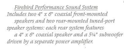

The factory subwoofer option was RPO UQ7. I do not see it on the RPO pictures. There was no 6 speaker option. Two in the front dash pad and two in the rear quarter panel trim.

The factory sub woofer option (UQ7) had 2 fronts, 2 rears and 2 sub woofer speakers = 6 speakers - I did see the UQ7 on the spid for this car

By tilting seats I thought the reference was the Ultima seats that was standard on the GTA and optional on the Trans Am. Regardless, as you can tell from the picture I enlarged, those seats do not look correct. A better picture might help to be sure.
Regarding the UQ7 and 6 speaker reference, I suppose you can call it "6 speakers" to include the subwoofer but since the subwoofer is not the same as a speaker against the rest, I considered it 4 speakers plus subwoofers.

Its hard to tell in the pic you enlarged, but IMO, that could be an original Formula seat (looking at pics of my old Formulas)
A 1985 Trans Am Window sticker I have states the following for RPO UQ7 - "Dual Front & Rear Coaxial speakers & Dual Rear Subwoofer speakers"
Which is why I stated 6 speakers

JT - on a second look at that seat pic - I agree with you - I see what your saying now - not Formula seats

Or, at least, not Formula seat headrests.
That enlarged picture looks clear enough to see that the headrests on those seats are for neither standard nor deluxe Formula seats. They look like 4thgen Firebird headrests.
I suppose if 4thgen headrests install the same as 3rdgen headrests, then they could be 3rdgen seats with 4thgen headrests, which would look nice. However, the interior pictures show deluxe seats, but a standard interior. And there's no code on the SPID label for the deluxe interior, so the correct seats should be the plain ones with no side bolsters, but those have side bolsters, so they're probably transplanted 4thgen Firebird seats. Even if they're GTA seats, then they're still not original to a 1987 Formula.
87 Formulas and the years that immediately followed could not get GTA seats, but I think 91-92 Formulas might've been able to get them. Seems to me that I read here on TGO that there was an option where they could get the seats and the wheels.
True, there was no formal 6-speaker option, but UQ7 is considered to have created a 6-speaker system.

Yes, I believe they are 4th gen seats based on the larger headrests. The car's RPO shows option 19B, so that is not the deluxe interior code.

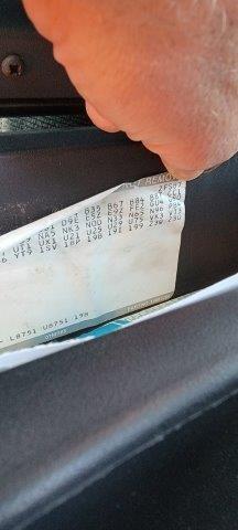

Ok there is a lot to dissect. You guys have been very informative. I've since got to the house and have snapped a few more pictures.
AAA is the 4 way option I was curious on as an extra fyi. One of the pics show the extra flat lever
Date tag showed 5/87

Ah, there it is. Drum brakes? No J65 (4-wheel disc brakes). That probably explains the 3.08 10-bolt instead of a 3.45 9-bolt.
I see UQ7 on the label.
You're right. Looked again and immediately saw it on one of the two pictures posted.
The UQ7 was on less than 6% Firebird/Formula models, making it somewhat less common. However, again, that is not the sort of option that most people are looking for. Condition, mileage, powertrain, model, and color options are more looked at.
Also, AAA is "Additional Standard Equipment" and shows to be on all Firebird/Formula models.
