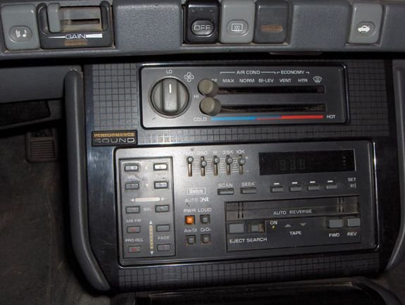

Originally Posted by Rojo17
I can't recall if it had 3-point seat belts in the backseat.
Then do you recall if it had the GAIN switch in the dash for the subwoofer option (UQ7 on the SPID label in the console)? That option was discontinued after 88, in favor of the addition of rear seat belts in 89. The switch, or a blank space with a filler piece, would be along the bottom of the dash, like in this picture below. If you recall having that switch or a filler piece where it should've been, then it's an 88. Because the subwoofer option wasn't available in 89, there wasn't even a space in the dash for the switch (no space, no filler piece), only two spaces in 89, for the defogger switch and the hatch switch.
Funny enough, Pontiac's own records show there was 1 - 1989 Formula with the UQ7 option. There's a few examples of stuff like this.

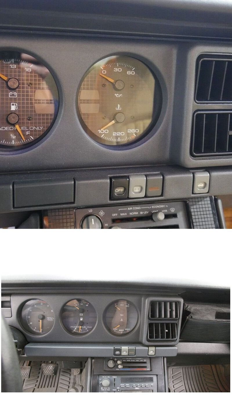

The top picture is for a 1988 that didn't have the optional UQ7 system and thus no gain switch. Notice the block plate.
The bottom picture is for a 1989. Notice there is no block plate.
Between 1988 and 1989 model years on the Formula, it ranges from about 70% to 80% as having the optional remote decklid release or rear defrost. So if you don't have those buttons, which are shown to the right side of the dash bezel, that doesn't narrow it down.

Thank you. That is helpful. The '89 is more in line with my recollection, which is great, b/c now I'm looking for a unicorn.... Wish my younger-self had written down the VIN.
It should be noted that some of the very very early 1989's got the block off plate like the 1988's..
