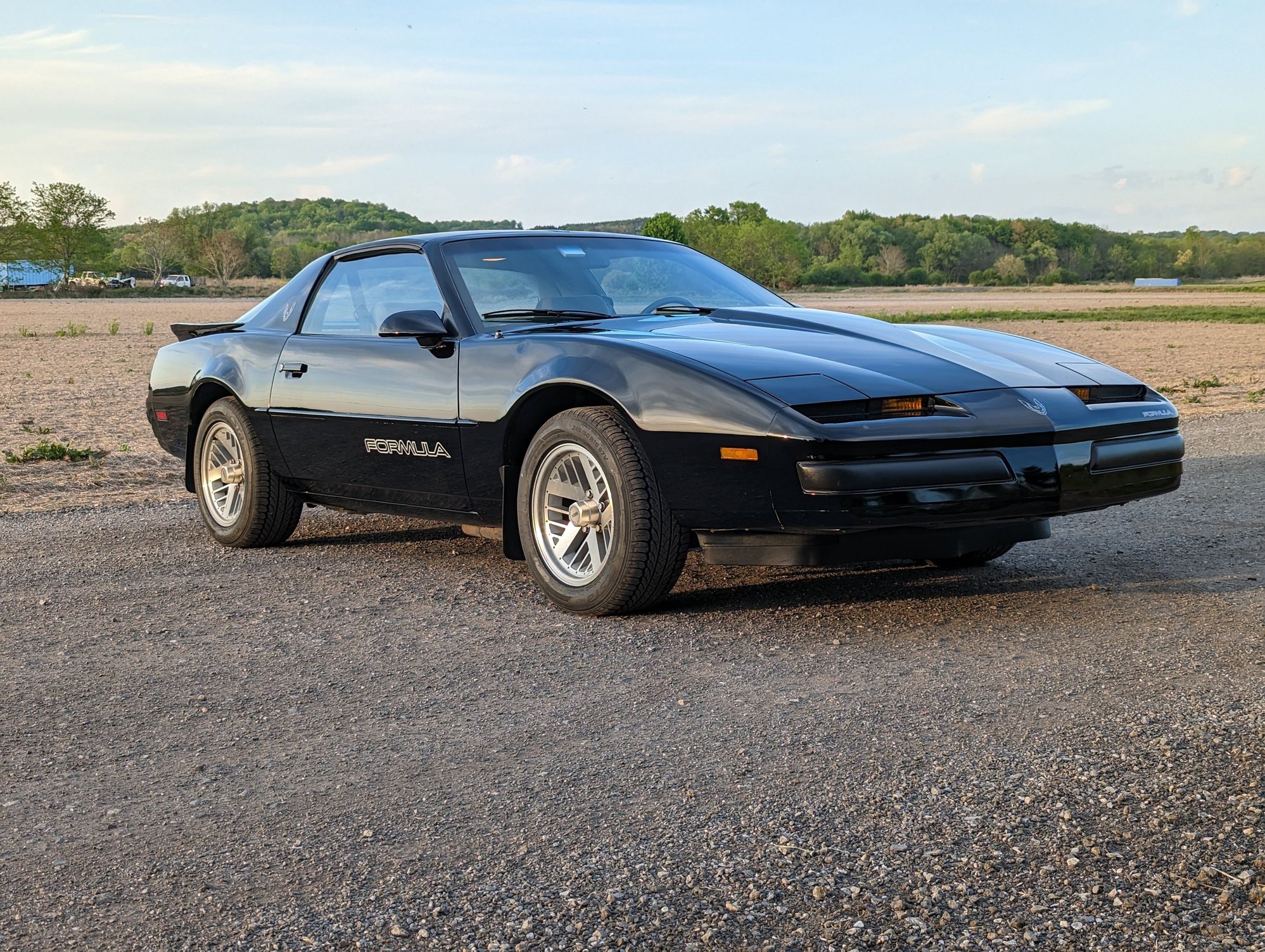

Hi All,
Excited to be joining this forum and stoked to have picked up this beautiful Formula from a very nice elderly gentleman that bought it NEW in 1989 with 10 miles on it. He saved EVERY receipt and document from his ownership (including from autozone!). It’s unreal to see the original buyers order from 1989. Now I won’t say this is a total time capsule, he obviously drove it. Headlight motors need replacing, AC needs charging, Exhaust needs adjusting, but it has never seen a NY winter or even rainstorm as far as I can tell. Chassis is *chefs kiss* perfectly free from rust. Just a sneak preview below (ignore the Carolina squat, I had yet to inflate the helper bags). More once I get the interior cleaned and headlights working.
First things on the to do list:
-Figure out the excessive cranking on cold start. Assuming timing adjustment, IAC cleaning/adjustment and TPS adjustment and go from there? Or is the cold start injector the likely culprit? Coming from 80’s BMW world so the TPI 305 is new to me. Took a look at the TPI FAQs and the above seems like a good place to start. Starts easily once warm, so not sure timing is the issue.
-New headlight motors on the way
-Brake flush….the fluid is BLACK
-Tranny/rear/engine oil
-registered and titled
-pay someone to see if the AC is serviceable. Have not seen a write up yet on R134A conversion but I assume someone has done it?
Looking forward to your feedback and knowledge!

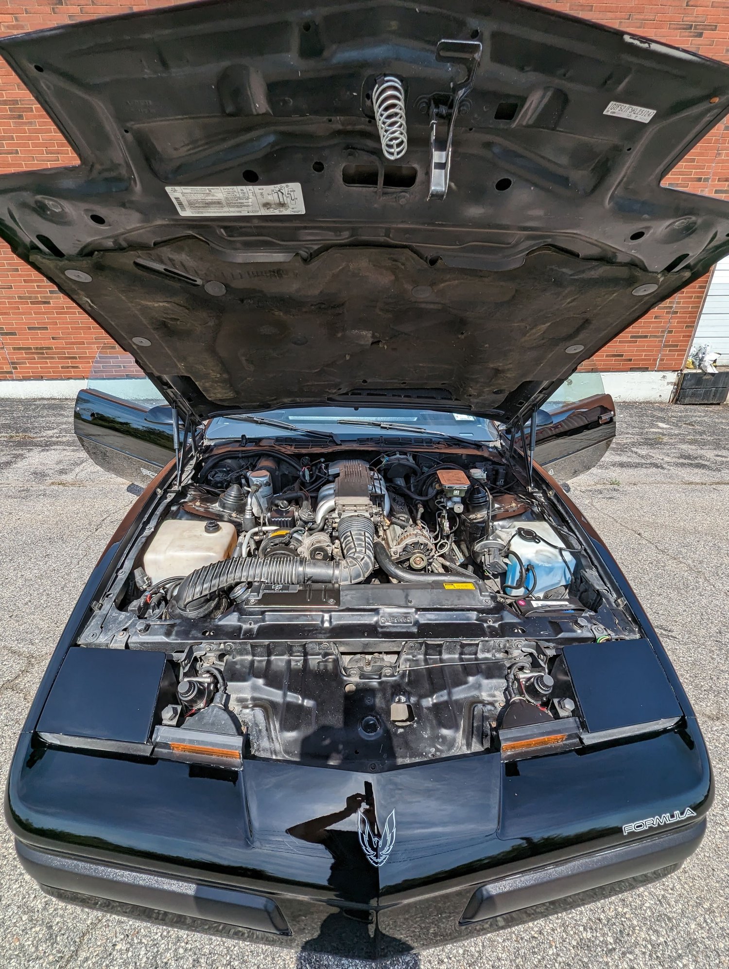

Well with injectors, plugs, cap, rotor, fpr top end kit and more on the way, decided to tackle the fluids. Quickjacks make everything easy! I am pleased to say that this is the cleanest 35 year old car I've ever seen. Pics speak for themselves.

Started in on my box(es) of goodies. Was able to flush the brake fluid which was a disaster with a power bleeder. The adapter for the reservoir would no seal not matter how I arranged it. Would build pressure but just spit out fluid. Finally I said f-it, wrapped the master cylinder in rags and bled. Now have nice clean fluid and got to spray/wipe down half the engine bay worried about brake fluid. Also did the headlight motors, air filter and have the exhaust almost back together after some chopping and welding. Also got it registered and have plates! Hoping to take it for the first drive Sunday. Have not done ignition and injectors yet but hope to get to it next week. Ran great besides the cold start issue so a short jaunt should be no problem. More to come once I get it rinsed off and out in the sun!

Update! Finished up the fuel/ignition system work this past weekend:
-Fuel injectors, new FPR and full o-ring replacement on the fuel rail
-Cap, rotor and coil replaced
-rear hatch shocks replaced
Thankfully read the experiences of others and realized I needed to drop the injectors in the manifold first. Pressurized system and had NO LEAKs the first time! I have to say, WTF GM on the TPI intake system. Needlessly hard to get to the bolts and a total PITA to torque properly. I had a ford 5.0 from an explorer in a volvo wagon and I could have that thing off and back on the car in 15 minutes! Anyway...
Car fired up immediately and runs amazingly well! So stoked, this is my first f-body experience and I am a fan! Got to drive it around Sunday afternoon and immediately found out it needs shocks, which I ordered today (stock AC Delco replacements). Next on the hit list:
-Coolant Flush
-Exhaust retightening/adjustment
-Shocks/struts
-Full detail + ceramic coat
Won't be able to get to the detail till May as I am slammed at work and travelling next week, so beauty shots will have to wait till then.

Well, FINALLY got this Formula detailed and new rubber installed. I'm going to consider this done (for now). Side note, my wipers have the dreaded no-return issue right now and I have the fuse pulled. Thinking it is the switch. Have a new stalk, going to take it apart this weekend to see. Any tips on taking the column apart?
List of Updates:
1. Injectors/orings replaced
2. New rubber: Khumo Ecsta PA31s
3. Headlight motors replaced
4. Oil/filter change
5. Transmission fluid flush
6. Replacement ACDelco Struts/shocks
7. Full paint correction
8. New Cap/Rotor/Coil (all ACDelco)
9. aligned and reinforced the catback
Old May 12, 2023 | 02:33 PM

Short update:
-Figured out the wiper issue WITHOUT taking the column apart (thank god). Just some positive grounding in the harness which a bit of tape solved.
-Drained the diff and changed the gasket, looks really nice inside and no real shavings to speak of. Refilled with 80w-90 and and the proper GM friction modifier
-Had a driveline vibration above~75 and on decel - pulled the driveshaft and is currently getting balanced with new u-joints
-Put a new 3in-vband on the cat-back section which eliminated the exhaust leak
-New spark plugs...what a PITA! Never had to get underneath a car to change plugs before. NGK 6630. Definitely made the car happier - seems to idle better and better off-idle response.
