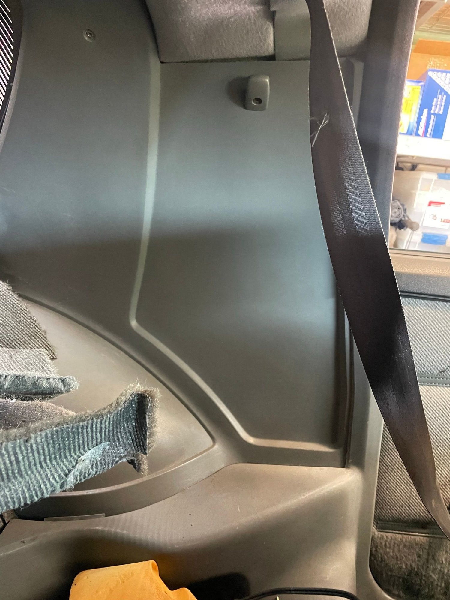

Interesting. Thanks, simo. My car does have an antenna in the passenger fender. I guess it makes sense, as I couldn’t imagine there would be different fenders made. The sail panels are uncut, and I have not removed them to see if her is any wiring there. He car had an aftermarket cassette player and speakers installed at some point, along with what I am guessing was a disc changer and amp (wiring was under the carpet), and an aftermarket alarm system.
I know the history of the car over the last 25 years or so, and this was all done before that. It is a super low optioned car; I’ve never seen another one like it. I’m pretty sure it was special ordered this way. It is an IROC, LB9, auto, T-top, AC car, with no convenience options except the roof console. It’s had later custom package seats and door panels installed, but I don’t care for the 85 base interior anyhow.

Here is a picture of the sail panels and the SPID label, in case anyone is interested. It’s also currently housing parts, so I apologize in advance for the mess.

The dash pad would have been designed with speaker grills, even for cars that don't have speakers. I don't know if there's any factory wiring in the dash as the wiring harness would also include the rear speakers. The wiring may be there. From the factory, there were no speakers in the dash, so a previous owner easily installed the dash speakers since the grilles are already in the dash pad. They didn't appear to install rear speakers as the area is still uncut.
You can remove the dash pad and remove any speakers that are in there, and reinstall the dash plate and call it a day!

i've never seen a car with no sail panels for speakers. pretty interesting.
